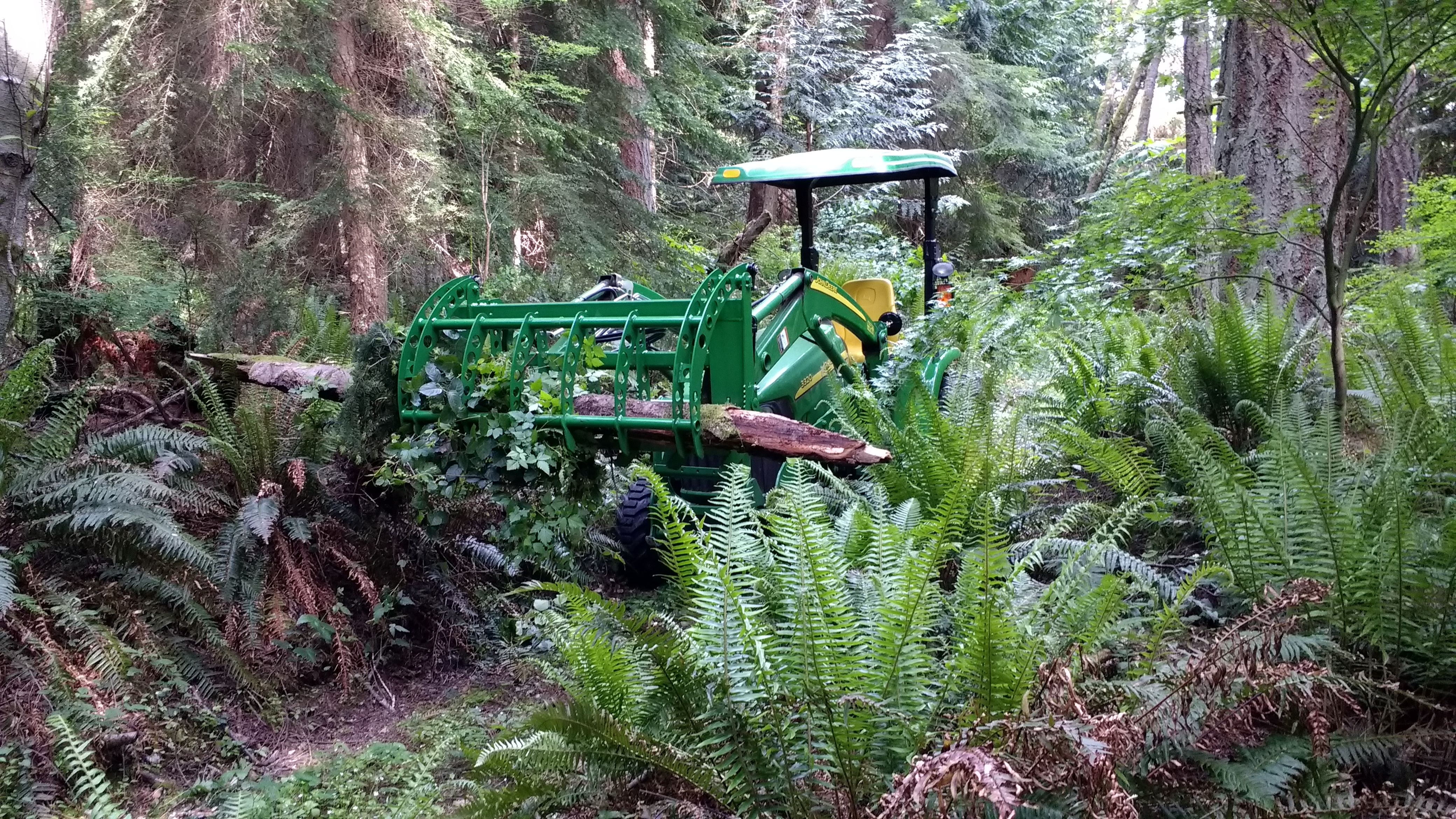

Then there's those who are using their tractors in the bush/woods... things can get 'tight', manoeuvring-wise. A ballast box is ideal as it doesn't hang out that far.
That would be me, used to use a box blade or backhoe for ballast but that got old quickly whenever they would hang up on a tree or stump. Switched to a Titan ballast box recently and its been a huge improvement for working in the woods and also around buildings and fences.

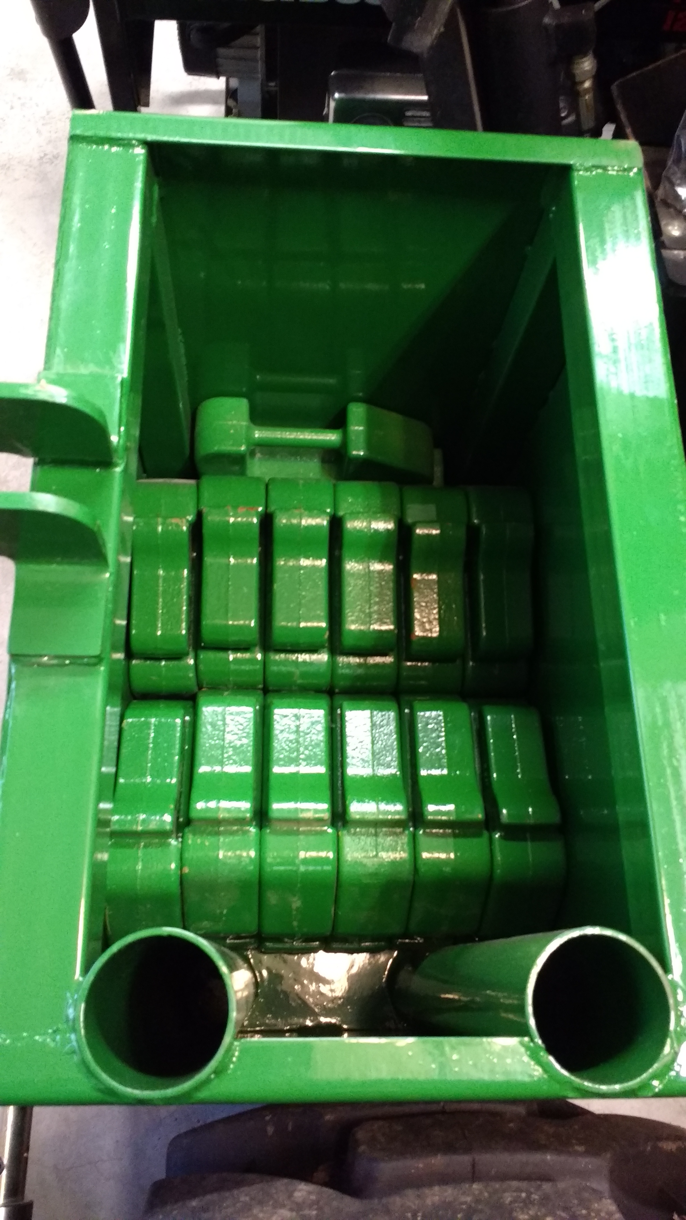

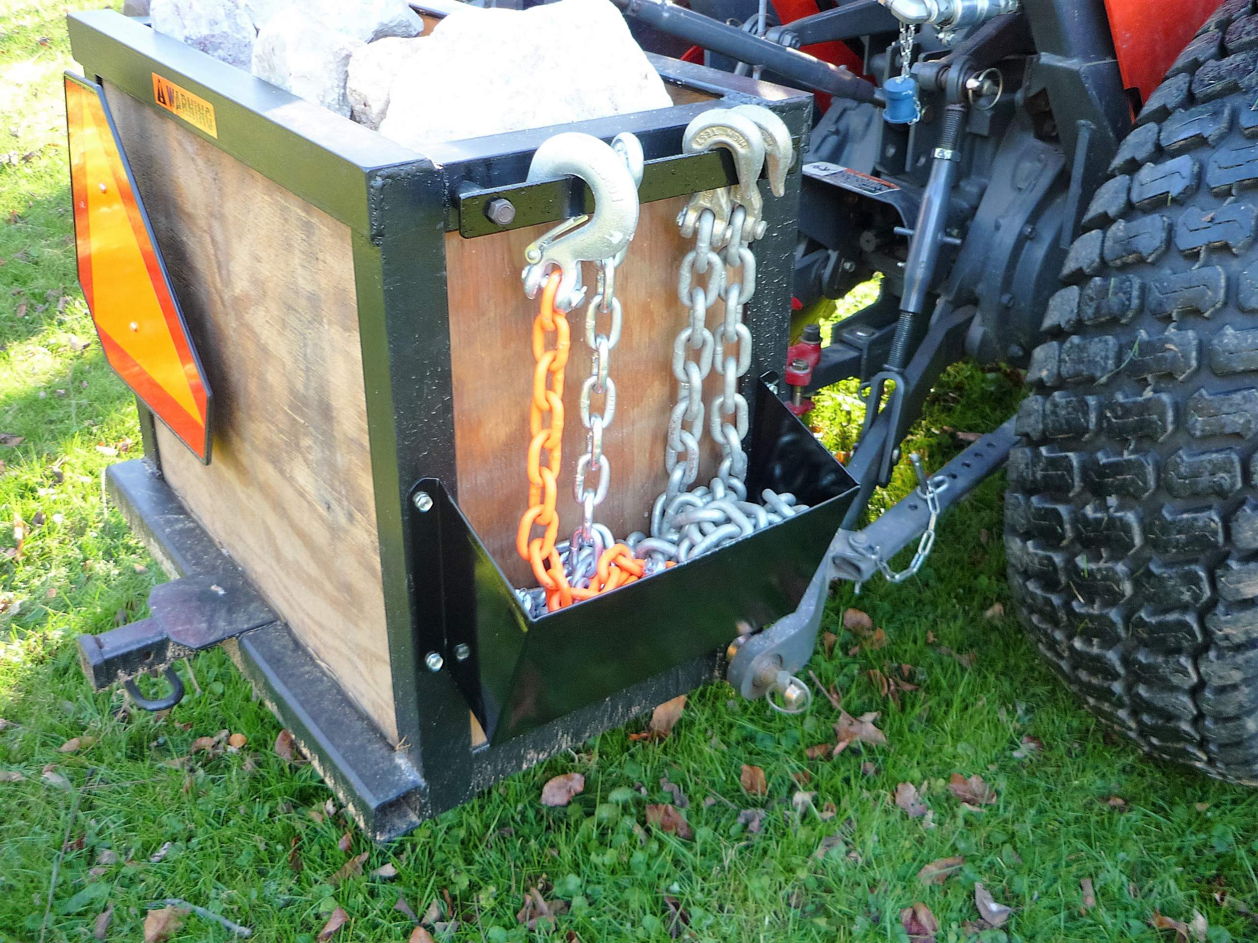

I built a ballast box because I got tired of worrying about whacking things with a big box blade out back. Then, I discovered how handy it is to carry chains on it, and with a trailer hitch as well, it serves me nicely. I wanted removable or adjustable weight, for depending on the task, and stones work for that, plus it's a lot easier to remove or install when it doesn't have a full load in it. Had I known you could buy one like the OP's, for just over $200, maybe I would have gone that route?
   / Ballast box #17
Nice job on the box and chain storage! Like you I think its a good idea to having adjustable weight in the ballast box. I'm using iron suitcase weights in mine which leaves room in the box for other stuff.
