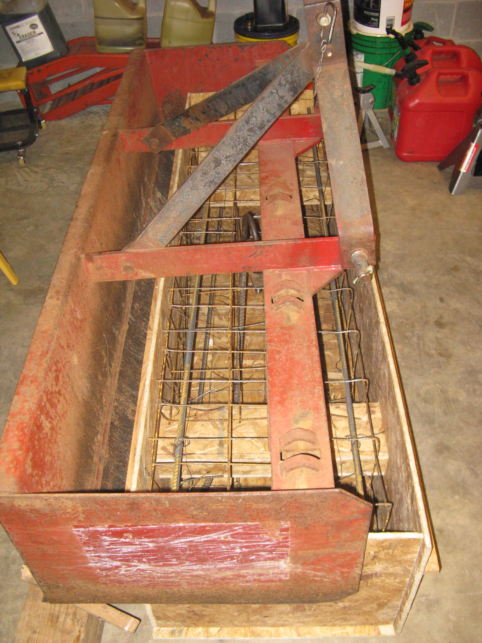

   / Ballast Photos #42

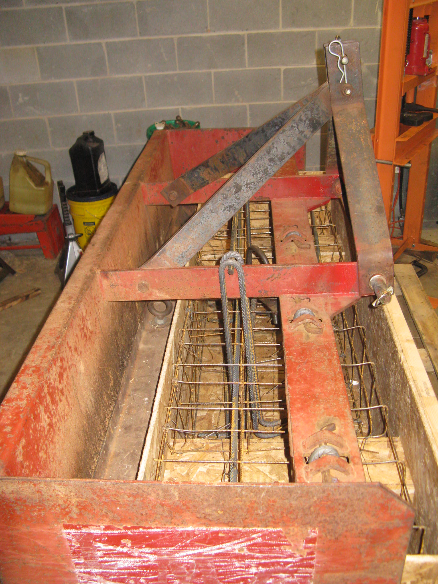

Ballast 002.jpgBallast 001.jpg Getting Closer and becoming a little more obvious now. 2000lbs when complete (not including the landscape box). I need to make sure I cast this baby close to the front door of the garage to get it out when she is done. It will have dual capability. I can pick it up using the scarifier slots and pins or the slots for the pallet fork. I am working on getting an attachment for the 3 point that will allow me to use my pallet forks on the back. I also need to pick it up with the landscape box when the pallet forks are on the FEL. Also, I could pick up my 4in1 and mount it on the adapter on the back.
   / Ballast Photos #43
Looks cool! Make sure you brace the front & back of that OSB real good. I delivered concrete and saw a lot of wooden forms blow out from the weight of the concrete. You might want to run some wire completely thru the OSB To the other side in several places to keep it from spreading apart. Good luck.
   / Ballast Photos #44
Will do. I am not finished with the rebar work as I am forming the hangers for the scarifier slots now. Once I get her all mocked up, I am moving it onto a pallet with an plywood base just for a way to brace it all up. It will have 2 sheets of 6"x4'X8' Rewire in it and over 60 feet of 1/2 inch rebar and a stick of 3/4" for a single hook lift in the middle.

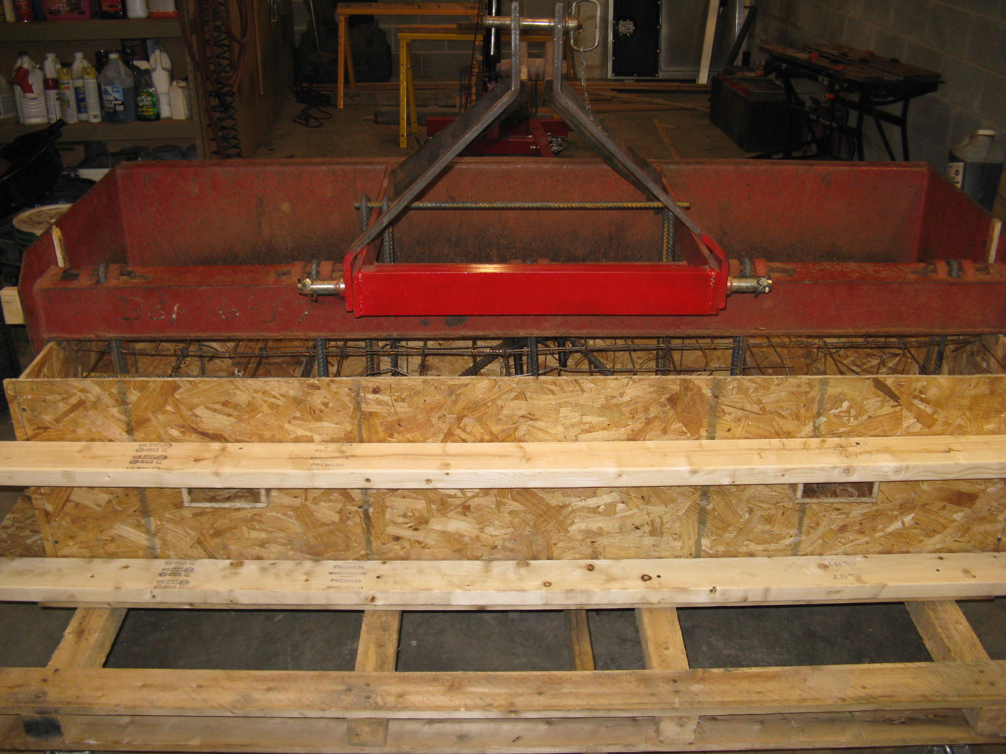

   / Ballast Photos #45

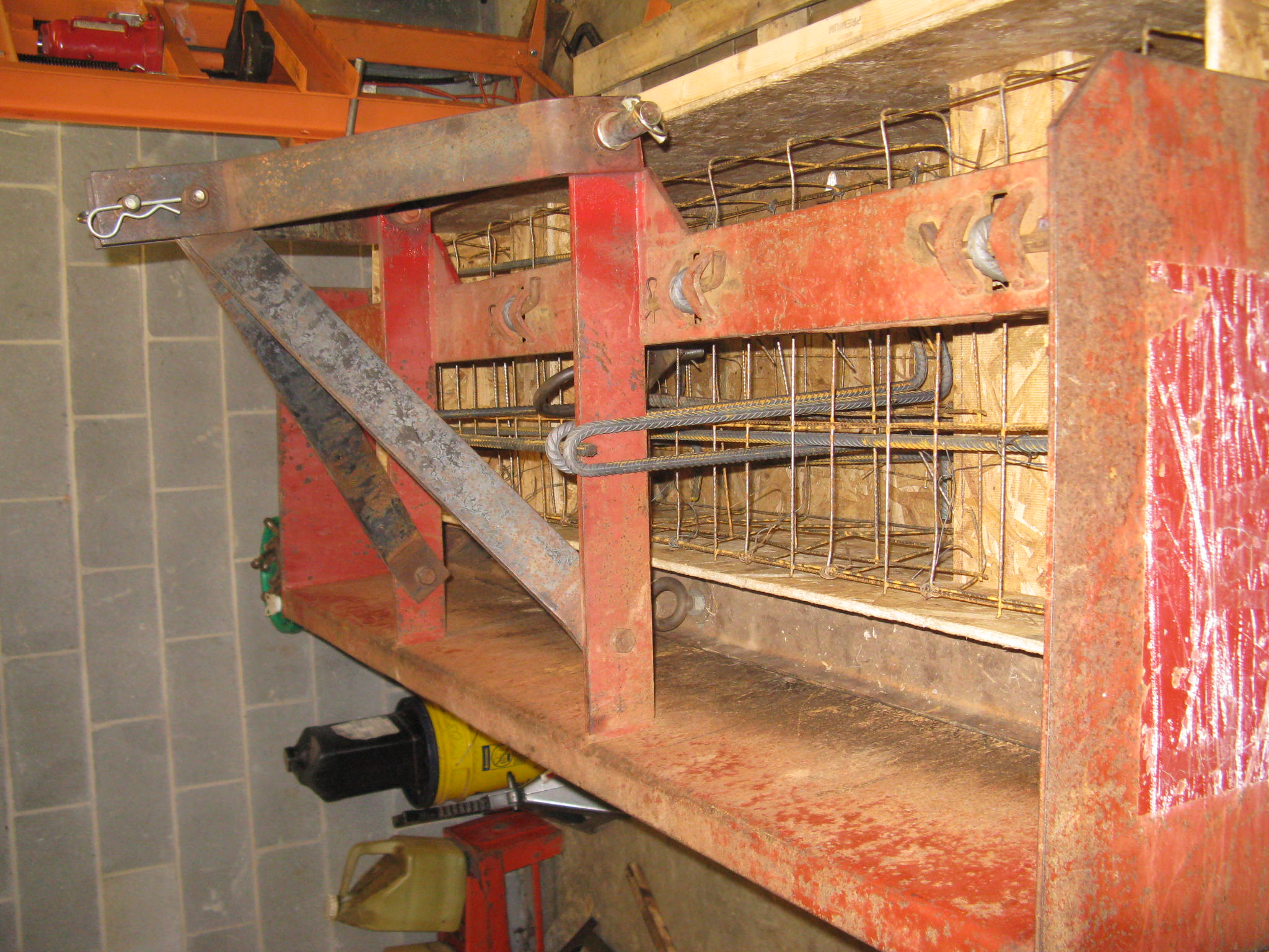

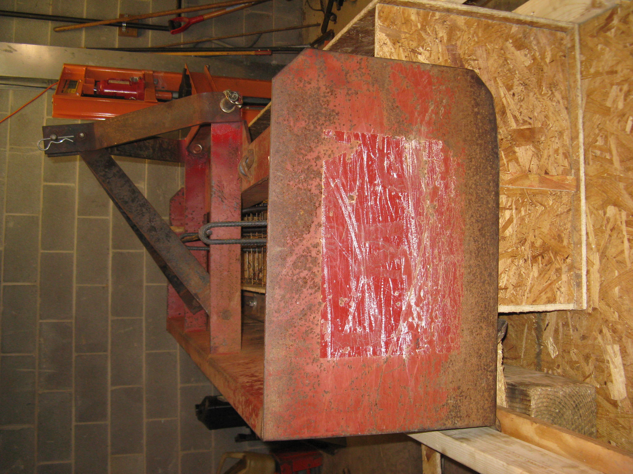

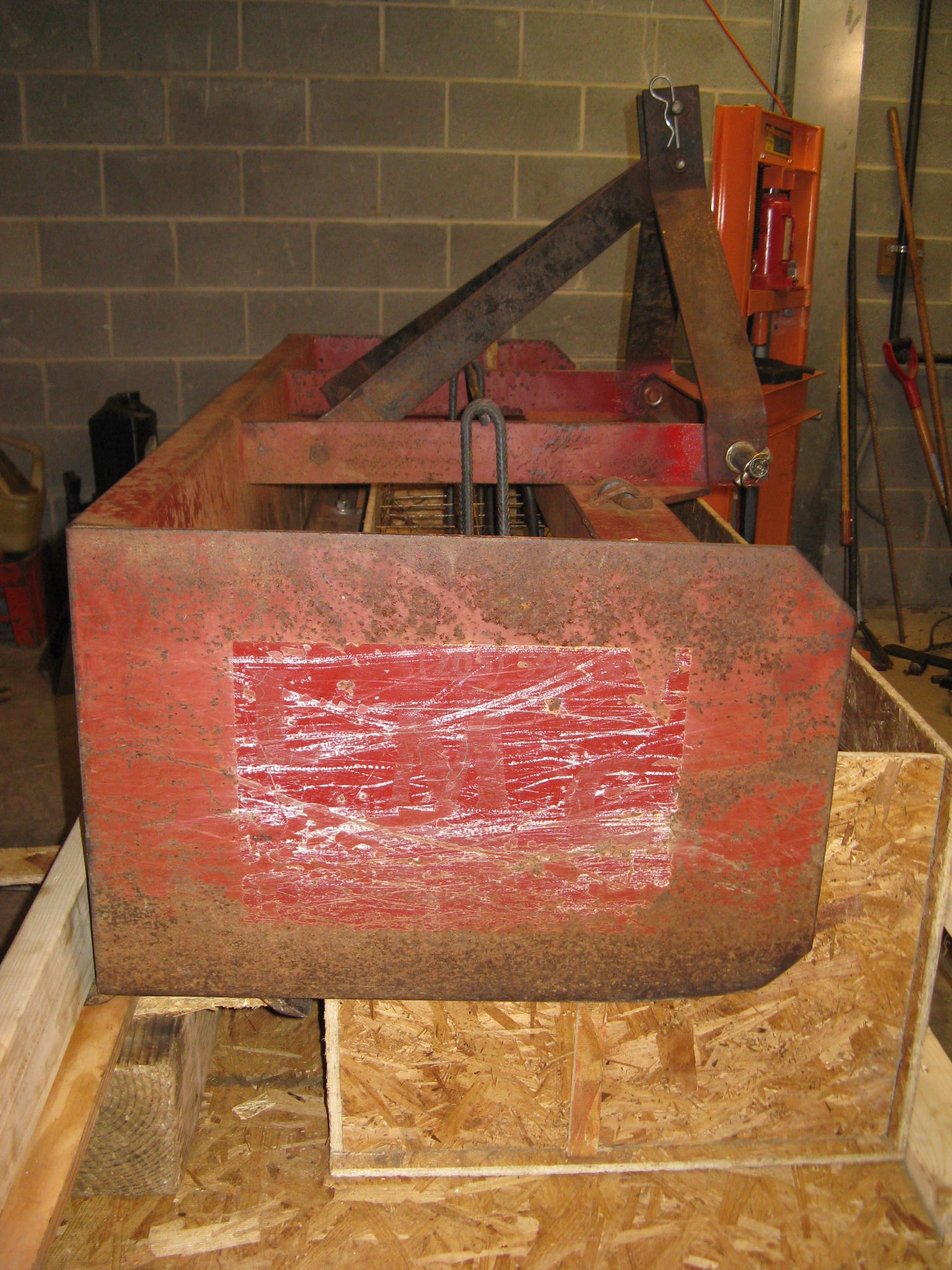

Ballast 005.jpgBallast 003.jpgBallast 004.jpg Have it mocked up with all but 1 piece of rebar. As usual, come up short of something on a project. I will strap the front 2X4 to one in the back but it is pretty tight. Don't think I will blow anything out.
Should I paint the inside to prevent the OSB from soaking up the water from the concrete and then spray it all down with motor oil for release?

   / Ballast Photos #46
I think all you need to do is spray the inside of the OSB with diesel fuel for form release. No need to paint.

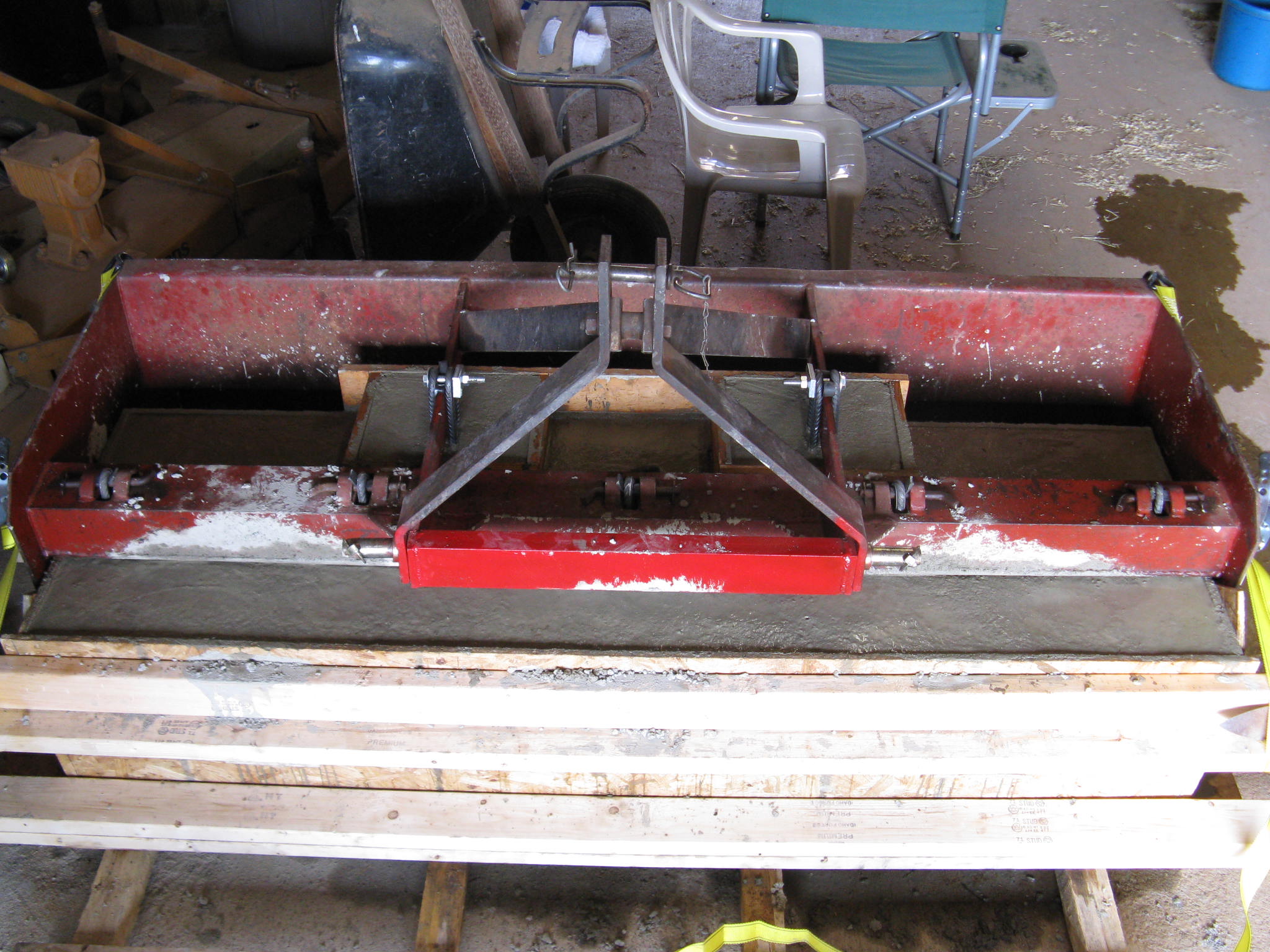

   / Ballast Photos #47

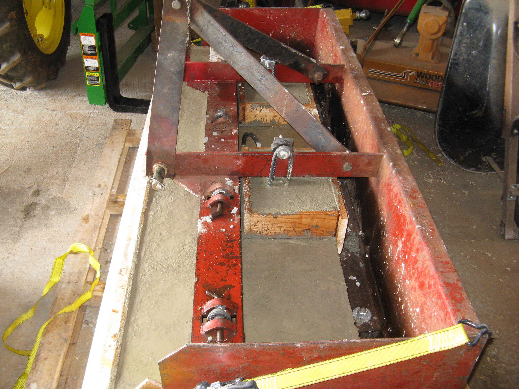

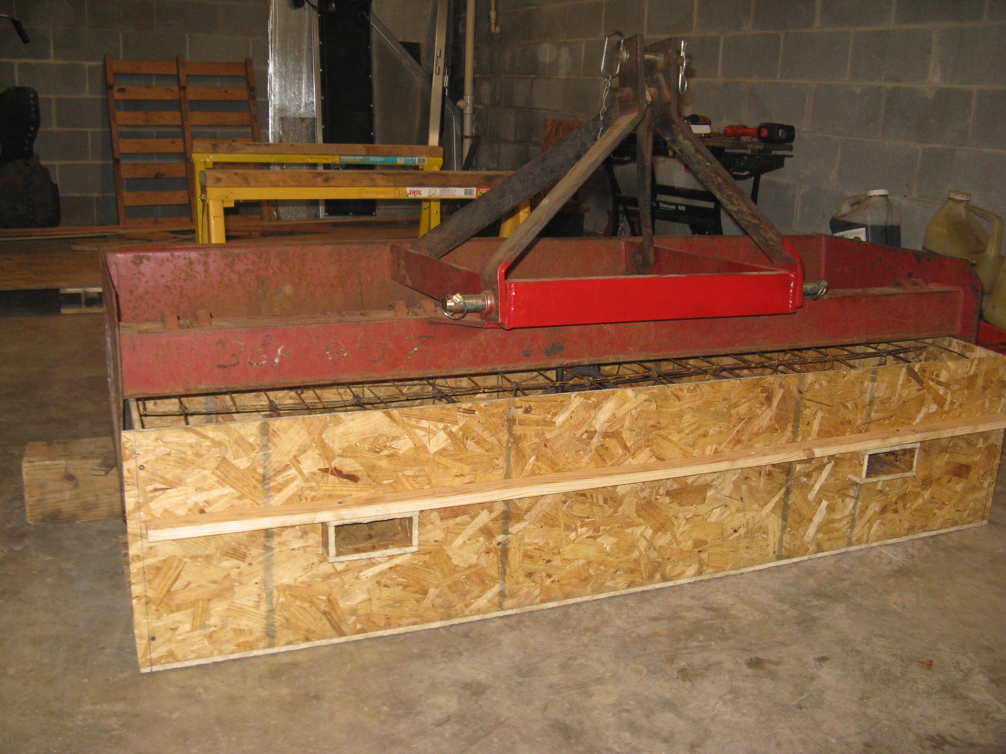

Ballast 007.jpgBallast 006.jpg Concrete poured and curing. 21 - 80lb bags. With Rebar and water, should weigh in some where around 1750lbs without the landscape box attached. With box I should be about 2200lbs.

   / Ballast Photos #49
Very nice job, that is a nice counter weight. Be sure to post pic's of it in action. I am in the planning stage of building a concrete cw myself.
If you do much work in the woods, you don't want anything nearly that wide. I tried using a box blade as a counterweight when I was doing light work in the woods, and I got it hooked on trees, and stumps more times than I can recall. I only tried that because the ground was pretty soft, and I thought 1,000lbs less total weight might be better, but it wasn't worth the hassle. I went back to my steel CW, and had zero issues, other than working around soft spots.
   / Ballast Photos #50
I am going to keep mine compact because I do lot of work in the woods & swampy areas.
