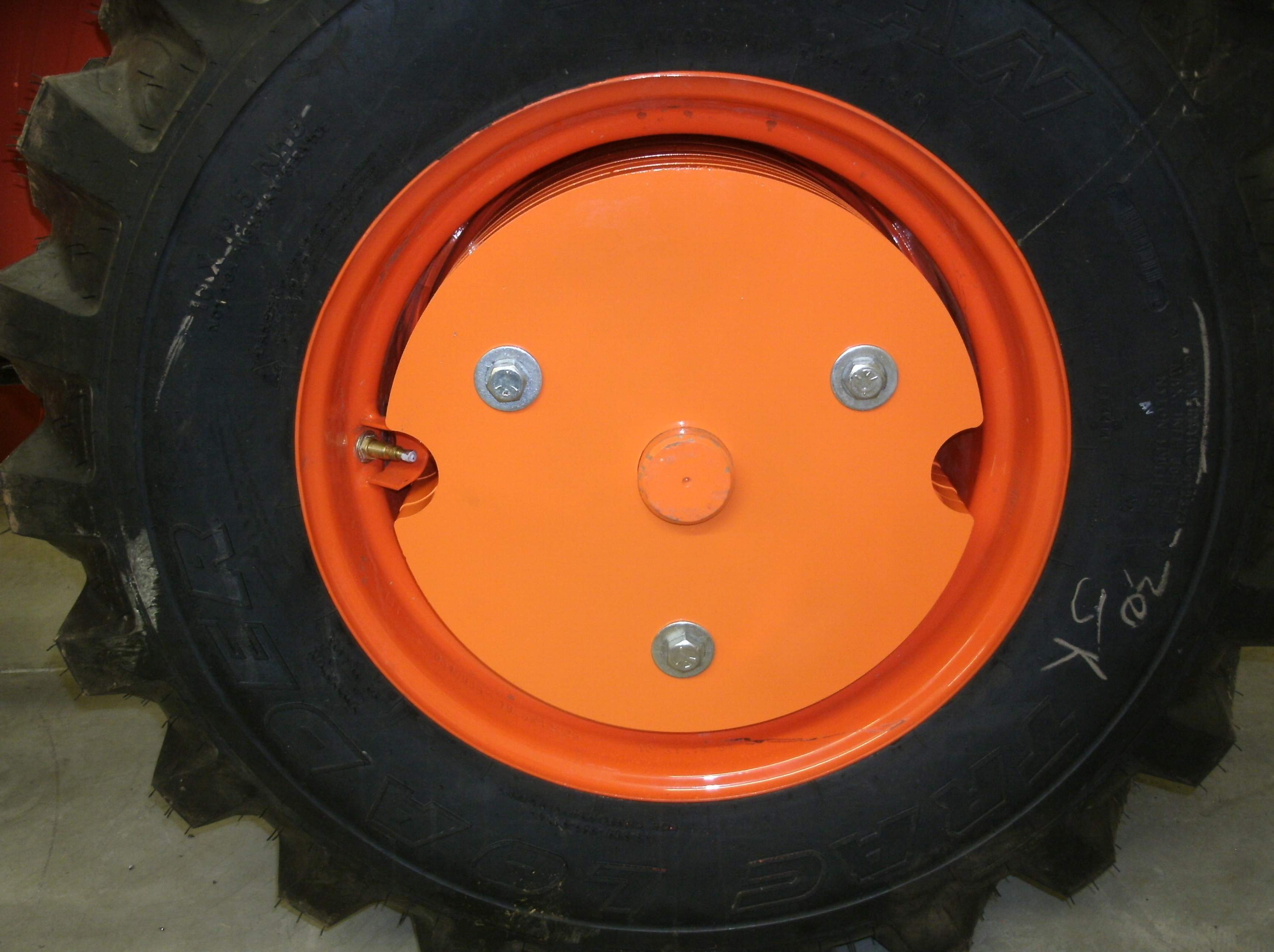

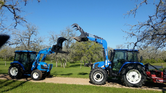

Here are a couple of pictures of the wheel weights that I made. You may not need to add this much for FEL work, but for grapple work it just made things operate so much smoother. Just love this tractor, BTW.

Mostly grapple work clearing junk trees and brush off my property. Used the FEL for a little bit of landscaping and moved some snow with it last winter. Meets or exceeds my expectations so far.

I wouldn't load front tires, just unneeded stress on front axel. If 1300 lbs. is too heavy for 3-point on that tractor you should consider a slightly larger tractor.
My front tires are loaded. Not sure I understand the additional stress on the axle? It is not like adding suitcase weights to the front of the tractor. Loaded tires would be the same as adding wheel weights?
I understand the additional stress if you would lift the front with the loader. Should I unload my tires?
   / Ballast ? #26
No added stress on the front axle that I can see. Just added footprint weight that you usually don't need.

I added the weight thinking it would be minimal help with plowing snow.
