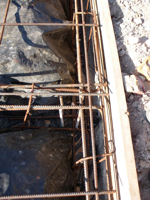

Still waiting for the City permits, everything is framed up and ready to receive lining and rebar. We have not started with the rebar in case it rains.

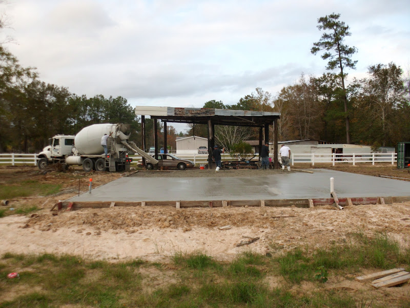

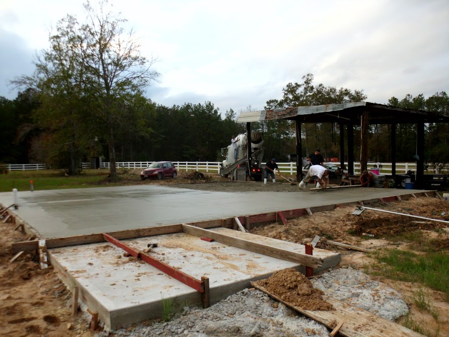

We poured concrete on Wednesday! 5 trucks with each 10 yrds at $670 per truck.

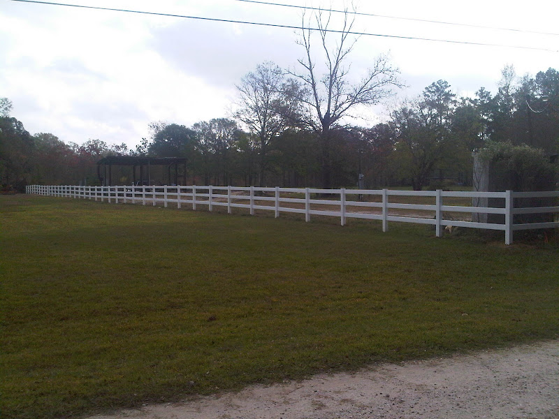

While I was waiting for the progress on the barn I started fencing. Here are some pictures.

I had a sloping ground - it basically gave me 12 inch in the front and 18 inch in the back.
You can see the height - especially on the right edge of the form.
Hope this helps!
