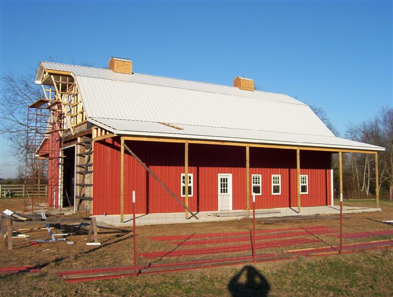

A little tin is on.

   / BARN going up #82
All the old dairy barns around here are giving up the ghost and falling by the wayside. Most of the replacements look so industrial, like a California mini-mal.
Your building has real class and craftsmanship, I would like to have that building with my window-view. (I would NOT want most outbuildings to share that view with.)
Congrats on a job exceptionally well done.

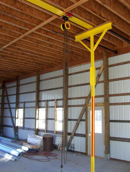

Way back when in this post I installed a 16' x 8" Beam to install a trolley and chain hoist on.
Here it is!

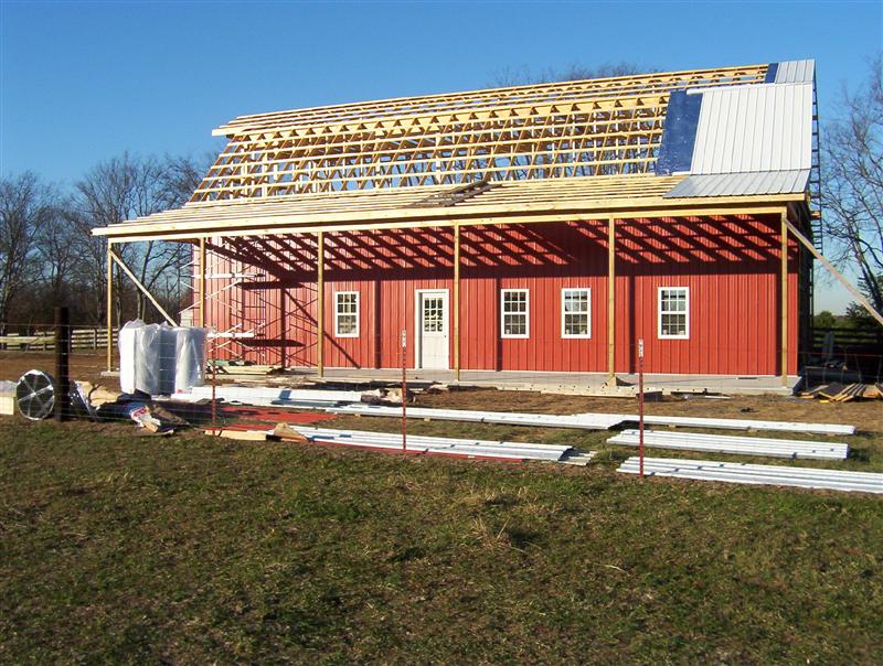

Shot of back of barn. Hole at top for a ventilation / exhaust fan not yet installed.

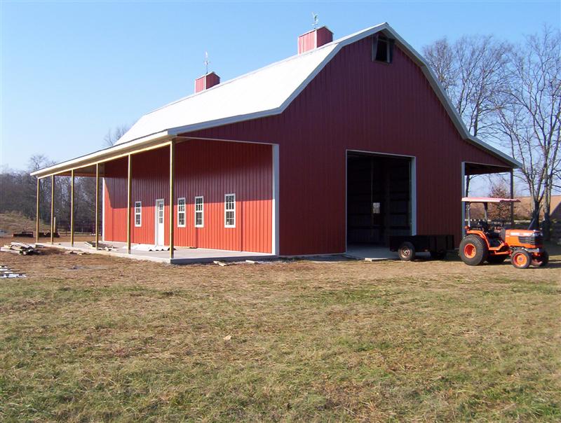

   / BARN going up
#86

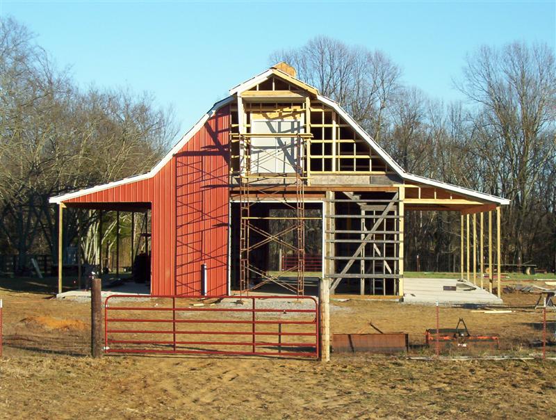

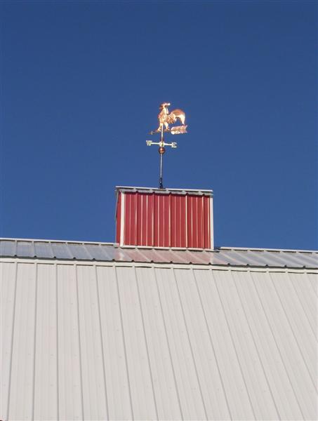

Pic of the long side with Cupolas of my own design. Can't wait to see the weather vanes mounted.
Also pic of front.

   / BARN going up #88
What size are your wood I beams and what kind of spacing are you using? I am slowely doing something like that, I have 16" X 24' beams and mine are 16" apart on a 31 pound per foot 16" tall H beam, pictures in my gallery. I know just what your going thru. Thanks
Jim:)
   / BARN going up
#89
Wood I beams for loft floor joists are - 16" deep X 32 ' long , Georgia Pacific WI-60 I beams.
They are 16" on center.

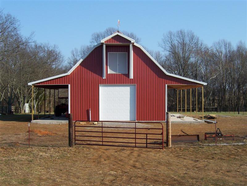

Time to close this one out I suppose. Don't see anymore progress , or dramatic pics coming. Barn is essentially finished. A little paint, some wiring, install a sink, etc. All dull work that really does not warrant pics. Possibly some pics when I get work benches, shelves in??
Thanks for all the kind comments , hope some have been helped in like endeavors by this post.

   / BARN going up #91
It's a beutiful barn and one to be proud of!!!
But there is no way you can end the thread without finishing off the inside. Work benches and storage are almost as important as how it looks on the outside.

   / BARN going up #94
Beautiful!
You should be proud. It makes my new barn look like a chicken coop.
