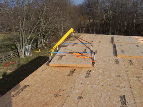

As promised, this is how I get subfloor up on deck. Welded this frame together out of scrap. Really saves a lot of work. Should work well for lumber to frame roof as well.

#64
Up on top.

/ BARN going up #65
That's a pretty nice looking lift arm. I'm looking @ making one soon but have not decided on the tube size or length.
What are the dimensions on yours?

/ BARN going up #67
I have a project coming up that is going to require putting some 4 X 8 sheets on a roof. I have already downloaded your pictures. Great project. /forums/images/graemlins/cool.gif
/ BARN going up #68
Do you have additional pictures of your fel boom posted on the site? I'd be interested in making such a beast and would like to know what size/type steel you used. Are you having any problems with twisting? ... Scozz
/ BARN going up #69
Nice call on the Advantec. That stuff is awesome. I left a sheet out on my deck for about four months in the snow and the rain and it's still perfectly square and flat. It's a bit more $$, but way worth the cost....blows away standard plywood for subfloors and now they're using it as roof sheathing. Excellent product.
