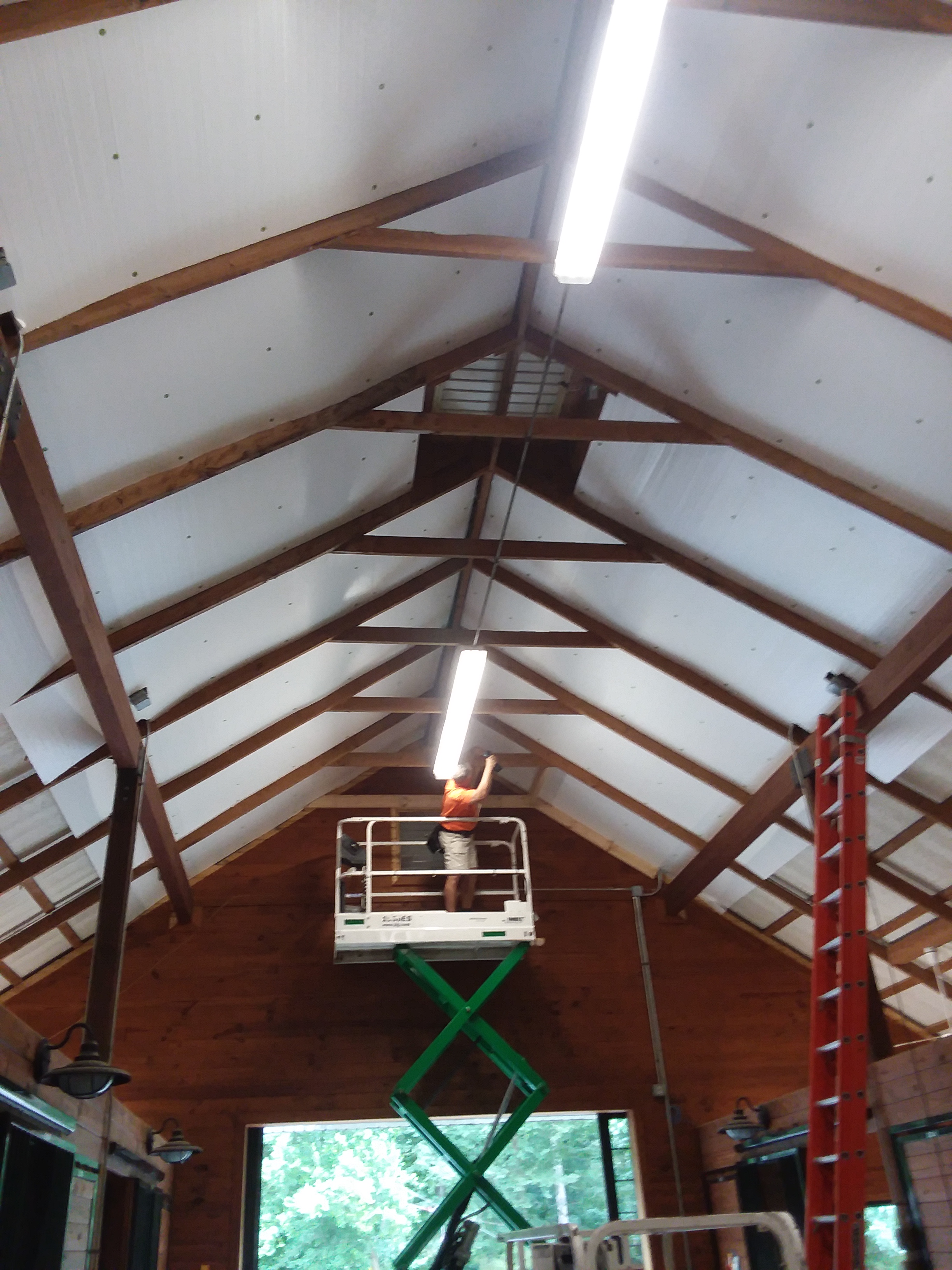

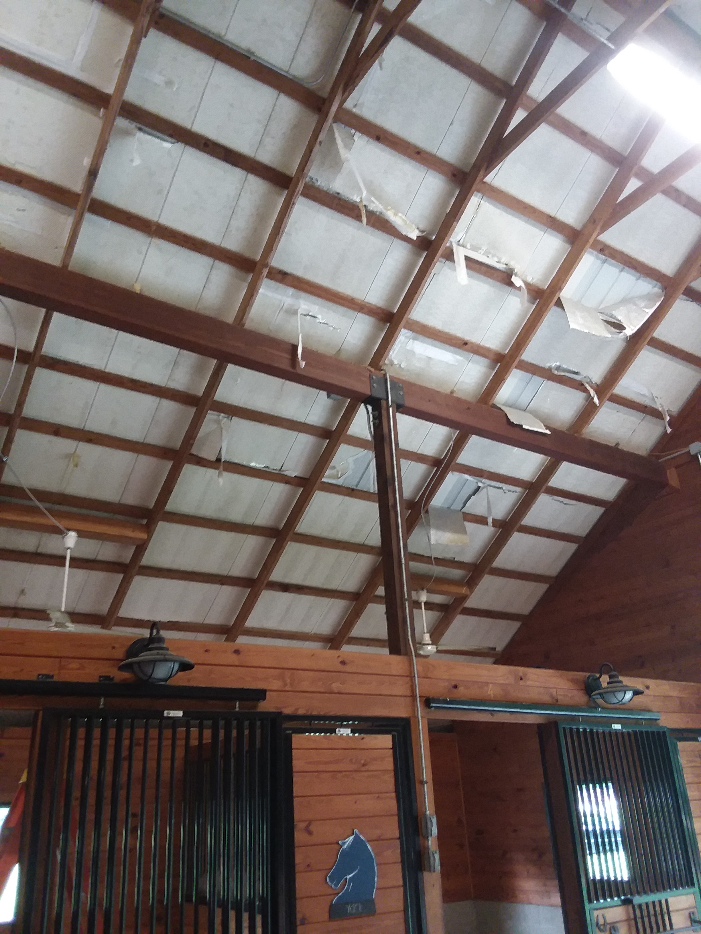

Finally got started on this project yesterday. Upper part will be t&g yp. Lower part will be galvanized 5v. Electricians are replacing lights with cans. Removing ceiling fans over stalls. Installing fans mounted to stall walls.

   / Barn roof insulation #44
Sure looks a lot better. Wish I had the bucks for a barn like that.
   / Barn roof insulation #45
That’s looking much nicer.

Closed cell foam will keep out moisture. That's why it's used for floating boat docks. Open cell foam absorbs it. Open cell is cheaper and easier to install. It has a lower R rating then the same thickness of closed cell.
Yep, as Eddie says, I have closed cell docks that are well into 20 years old.
While some used the open cell foam it absorbs to about 80% over time and is impossible to carry away due to the weight.
It also disintegrates over time causing pollution issues.
I usually created 'skirts' around my dock floats to prevent abrasion, also we never take them out as even the ice does not damage them over winter.
(we will get as much as 8-10" of ice here.)
