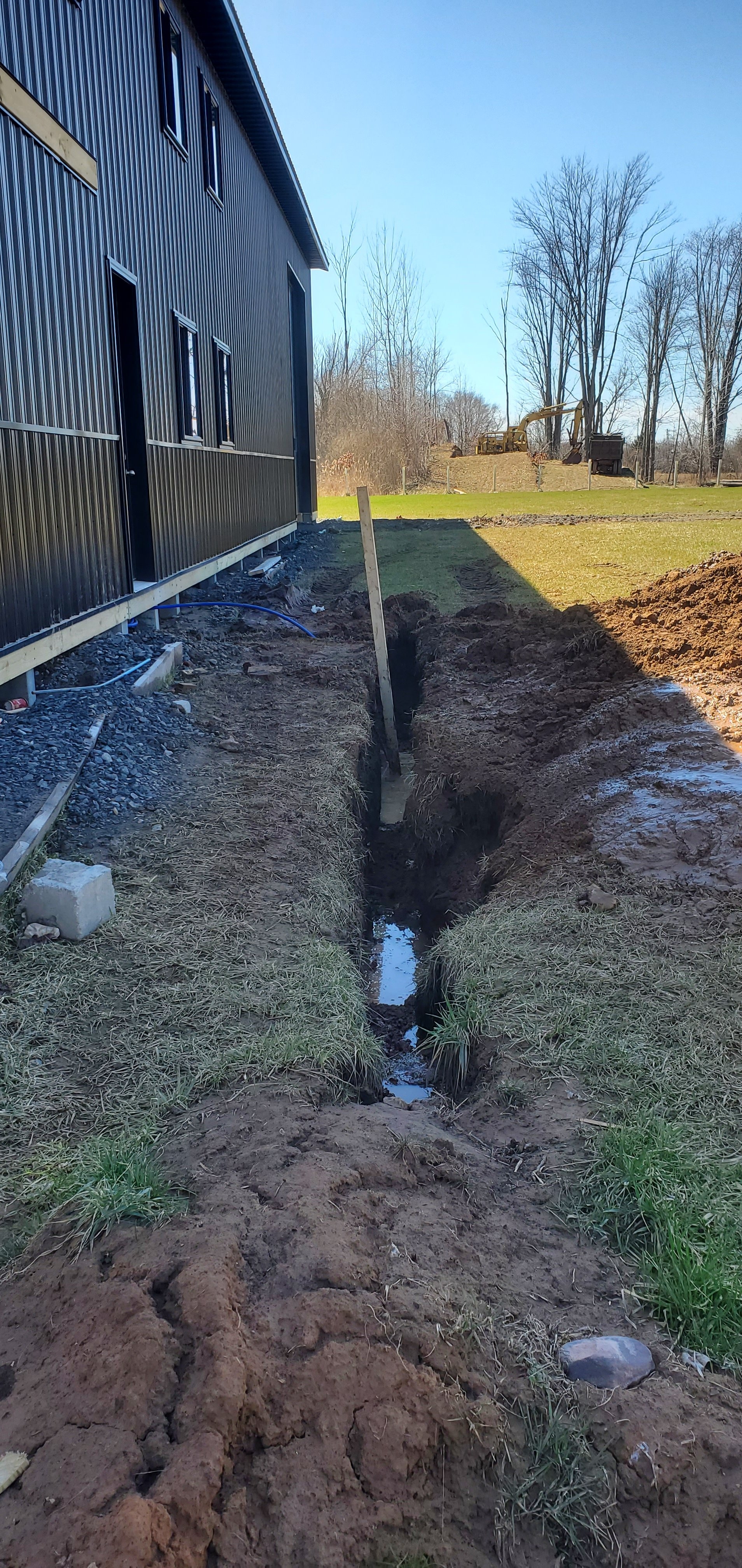

I was able to get the water line trench dug up to the building, between all the rainy days...

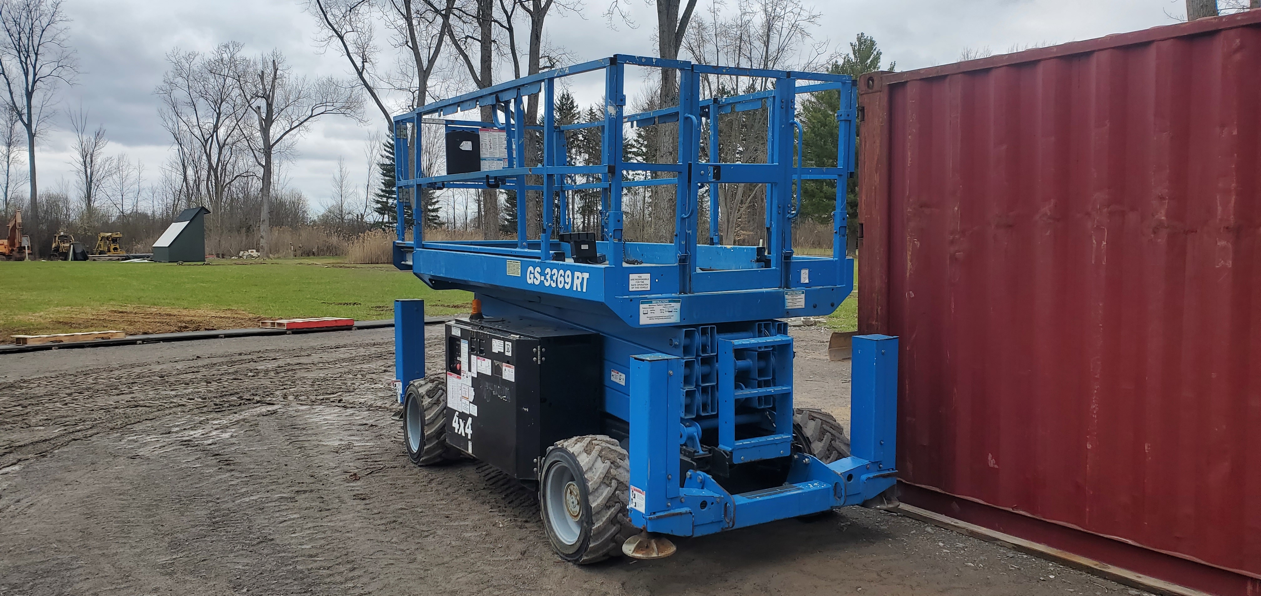

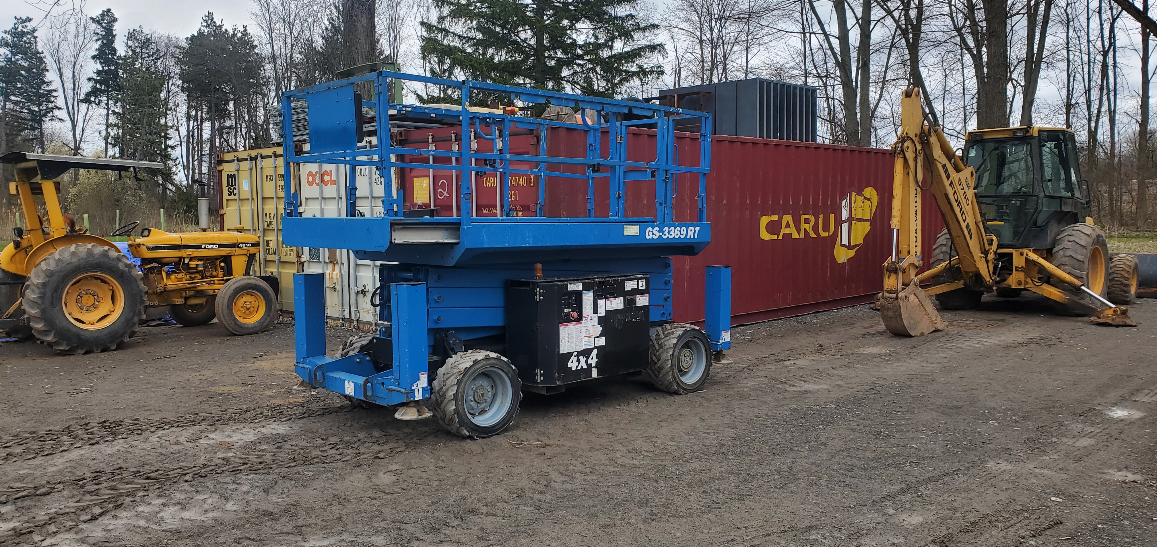

I added a piece of equipment to help me finish out my building:
It wasn't cheap, but I'm hoping it's insurance from falling off a ladder.
Wanted to make sure I got one with leveling cylinders. I kind of don't understand why they even make 4X4 all terrain lifts without them.

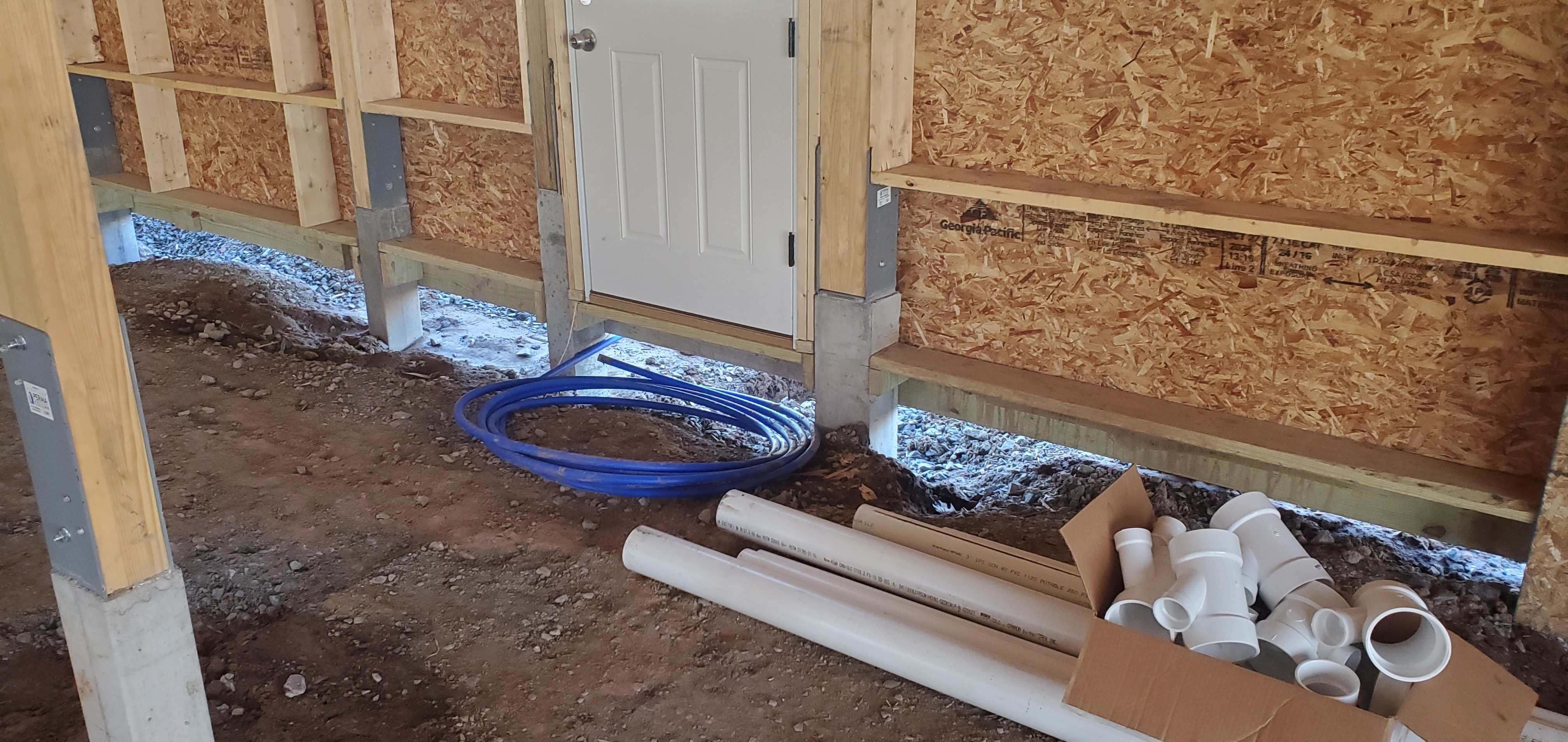

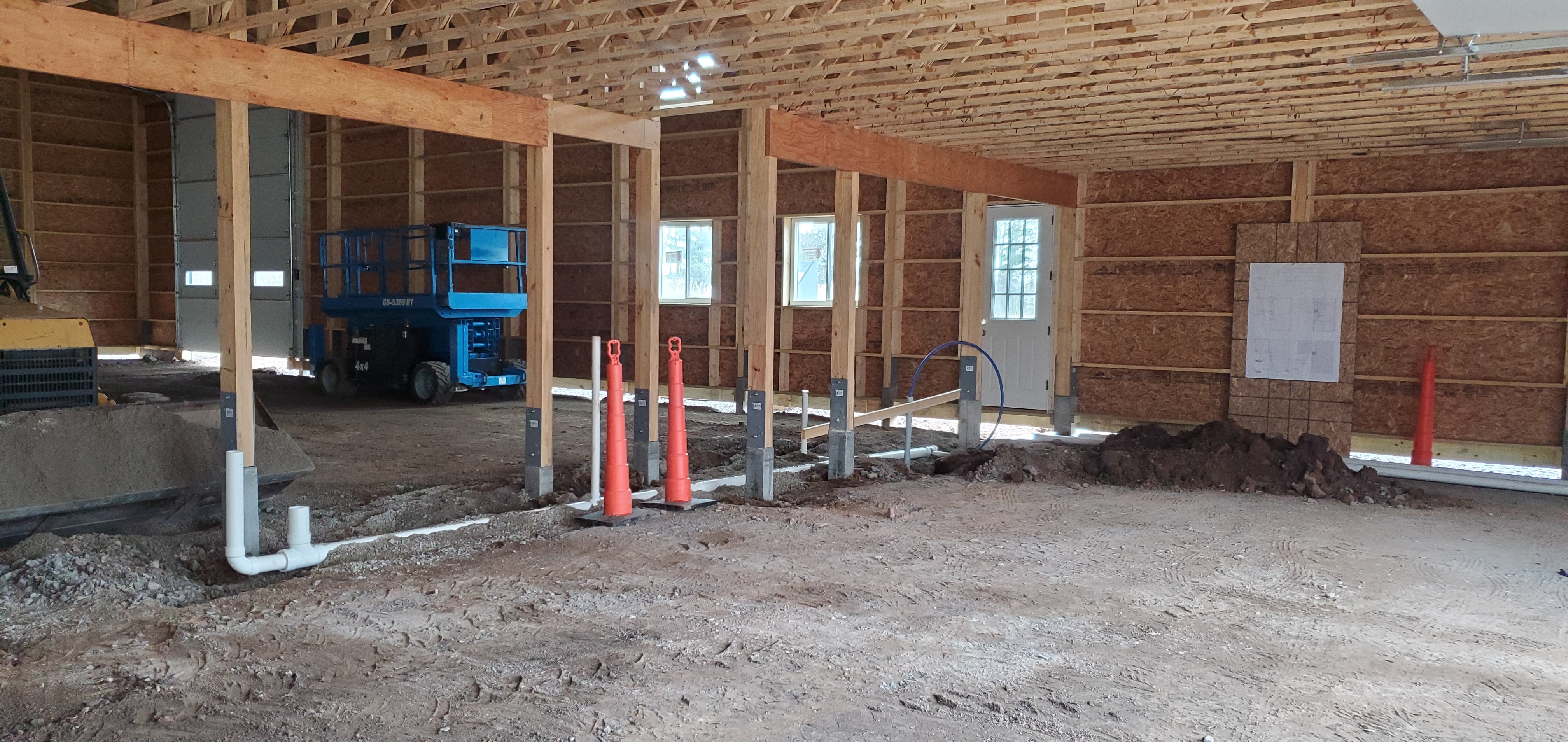

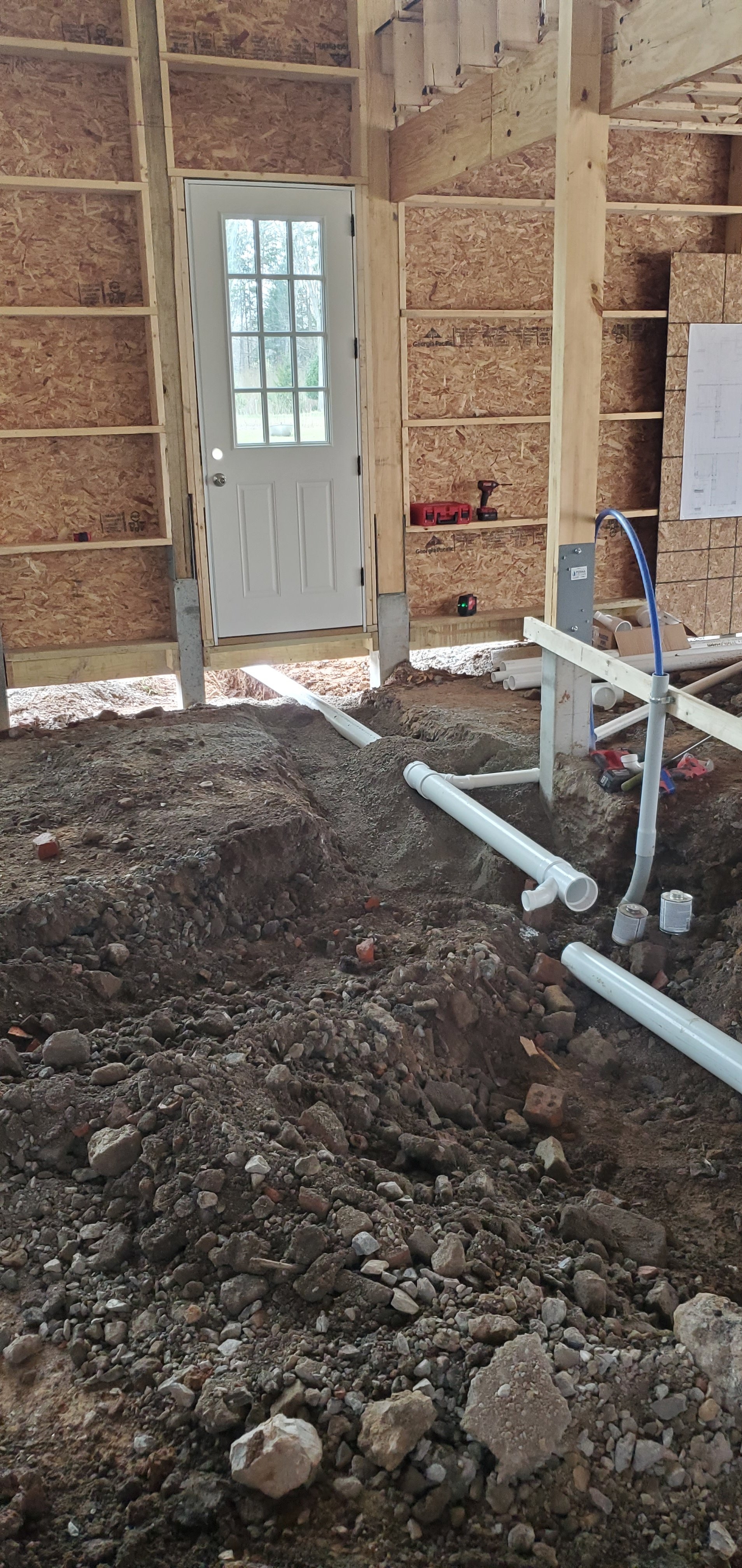

Got the under-slab plumbing and electric done today. Can't fully backfill until inspector has a look at the plumbing.
   / Barndominium/Shop or "real" House? #520
There is something about drain lines that I always find interesting.
I see two cans by the pipes, but I don't see any purple primer on your pipes. Are the pictures just dry fitted in the photo's and you used purple primer after you took them?
