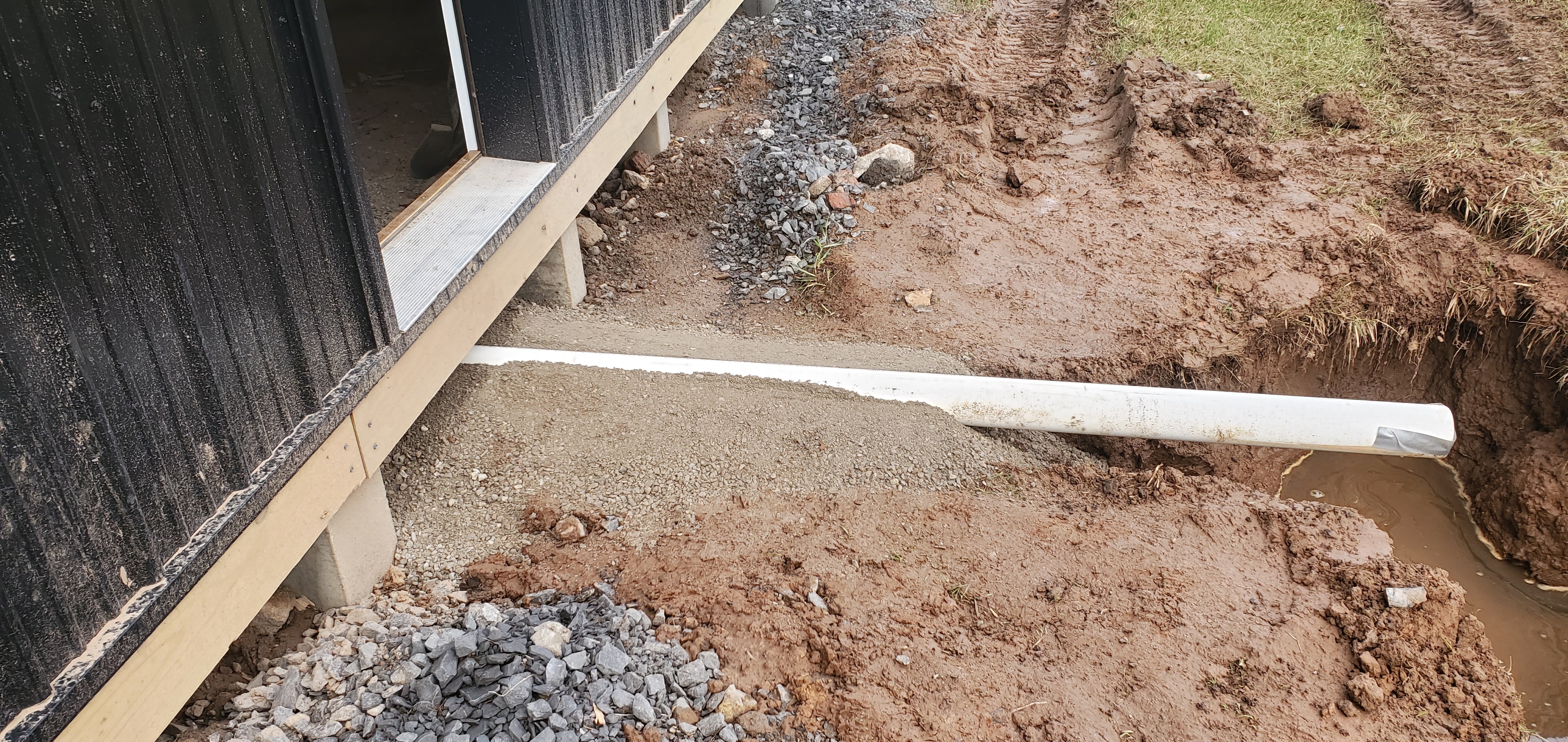

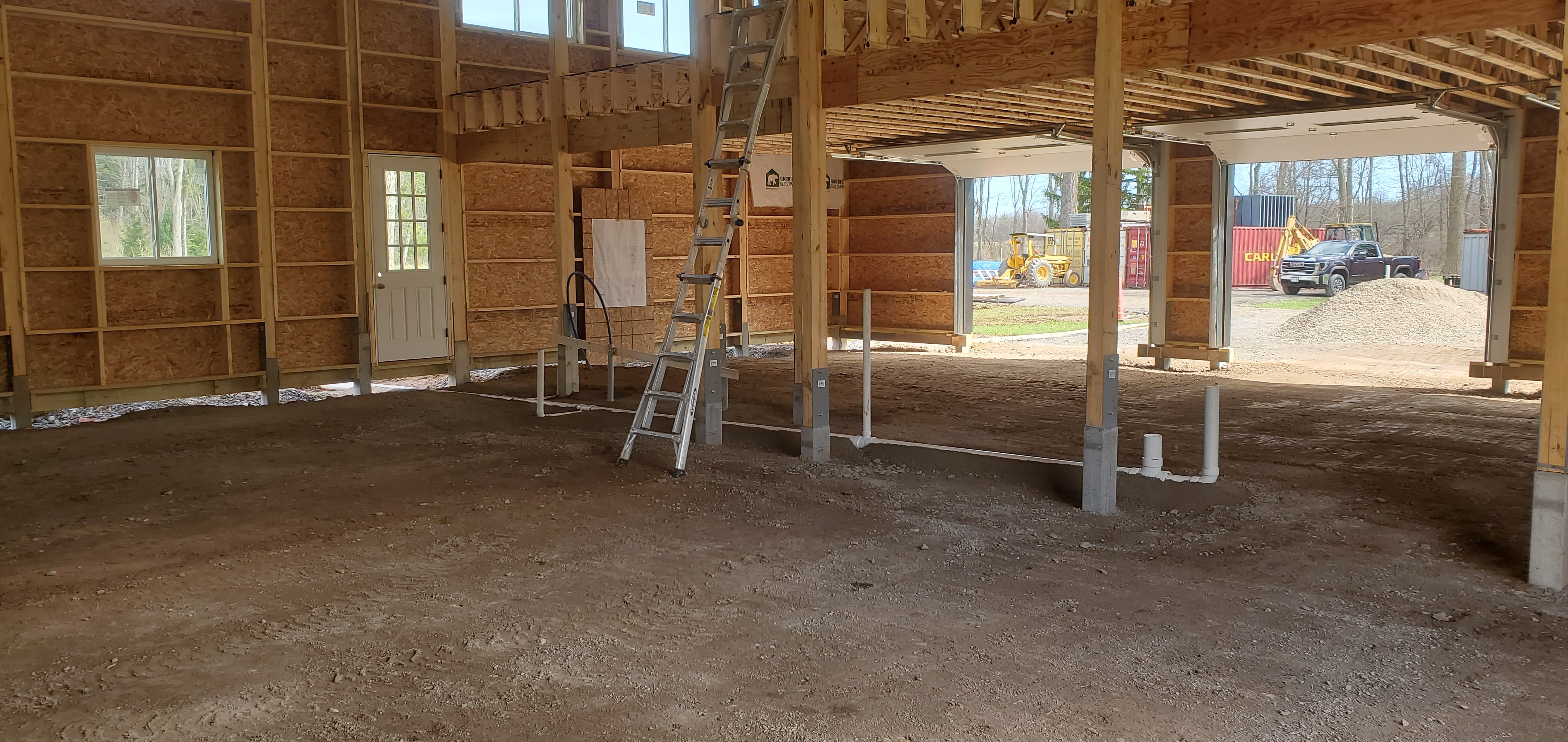

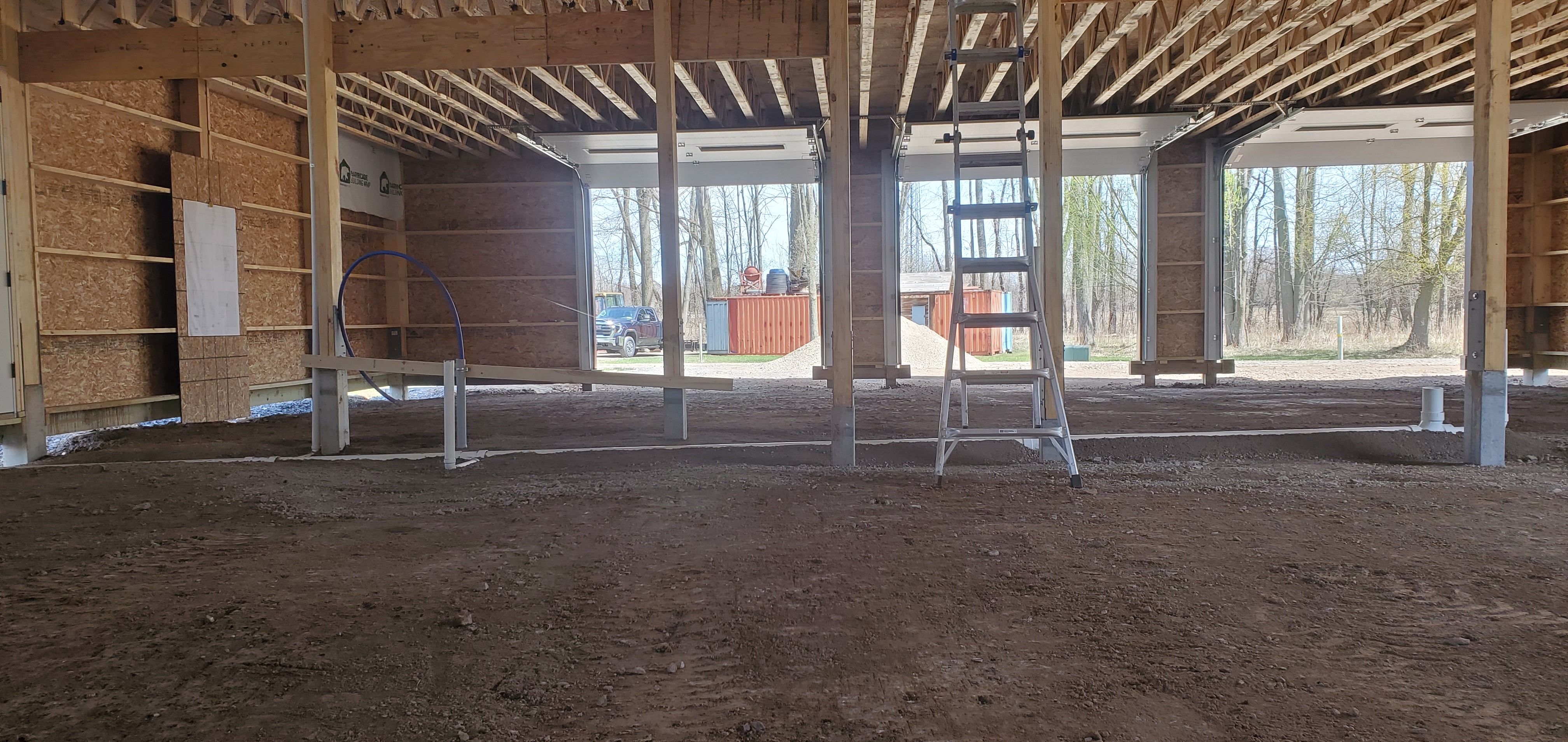

I think I am ready for the plumbing inspection. Might of backfilled a bit too much, but wanted to make sure nothing moved. Left the tops of the pipes exposed to the pitch can be checked.
   / Barndominium/Shop or "real" House? #527
That is the cleanest drain line install that I've ever seen!!!
If I understand what's going on. This is for the living quarters that will be on the second floor. And you are getting this inspection done so you can pour concrete, but you will have to get another inspection when you run those lines?
#528
Yes, this is just the under slab plumbing. Need to get this inspected so I can get the concrete going. Once the concrete is done then I can do the interior framing, then the rest of the plumbing and electrical can be finished.

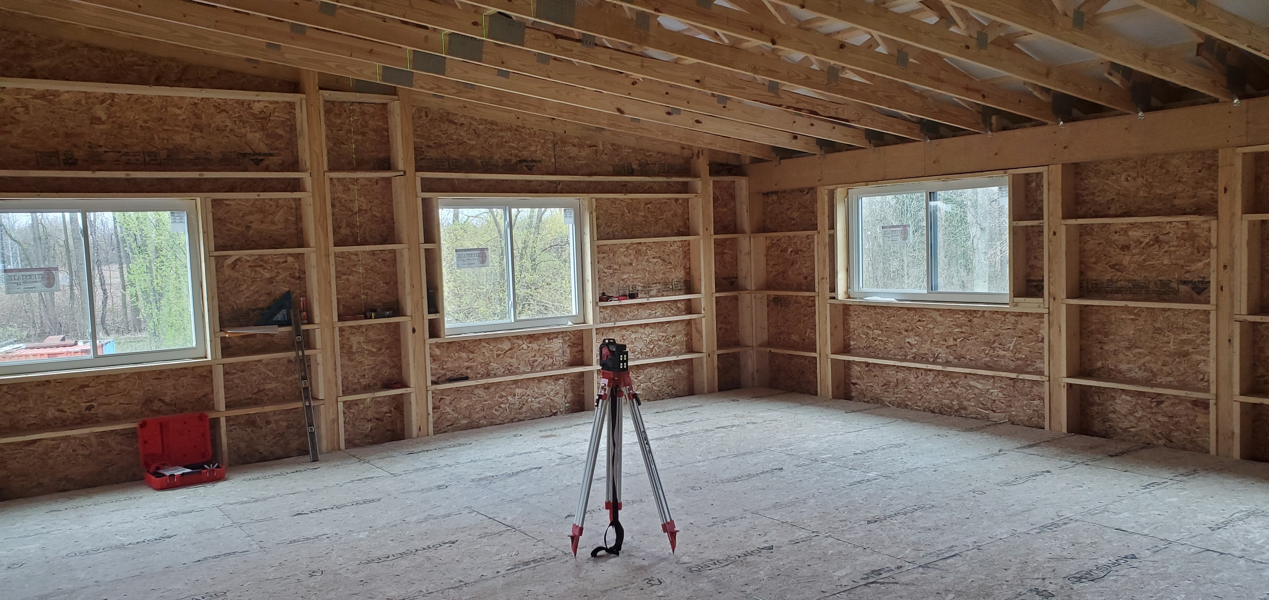

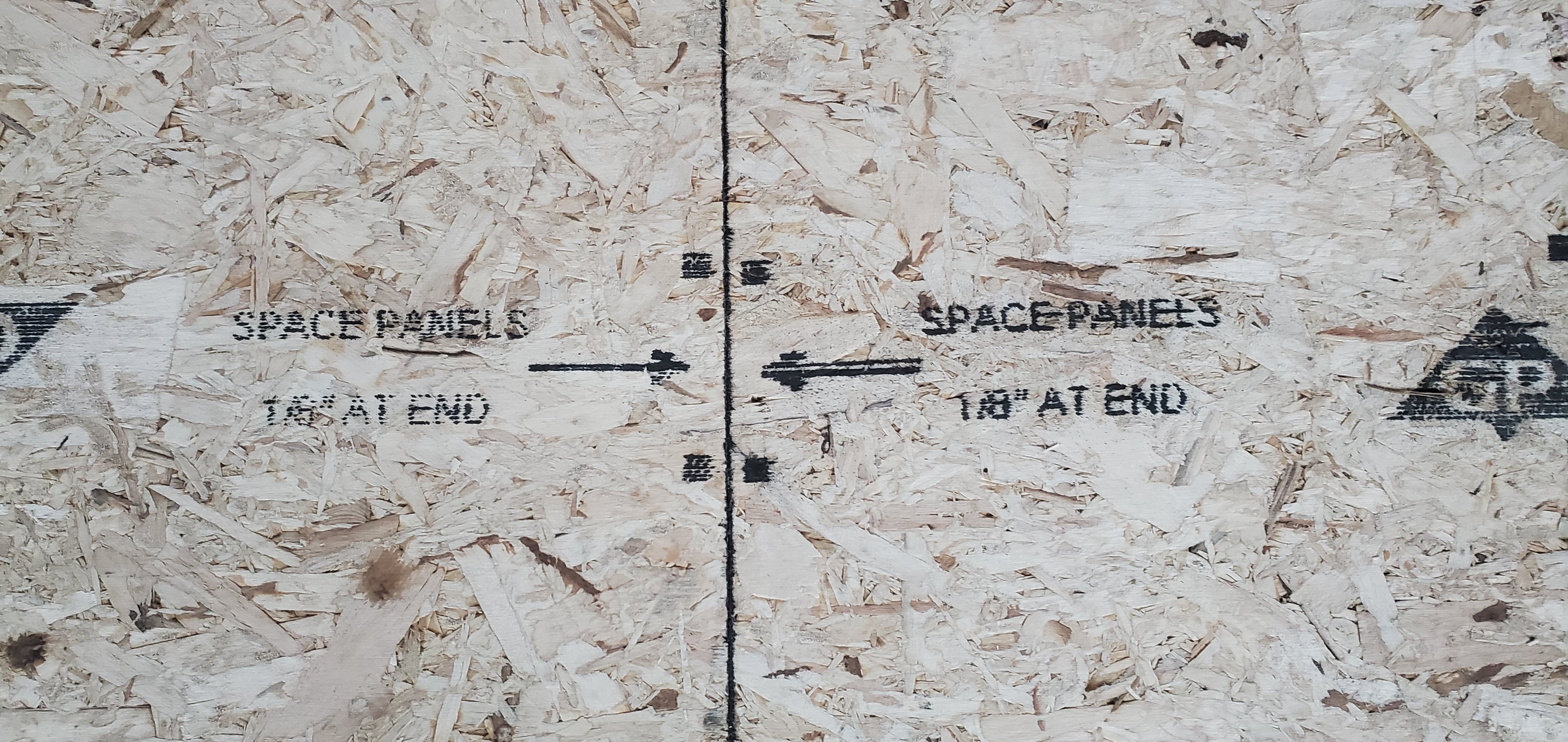

Found something else the Amish crew messed up:
They did not leave a 1/8" gap at the ends of the OSB subflooring. I assume especially with radiant floor heat I will need those gaps. So now I have to use a circular saw and create them I think.

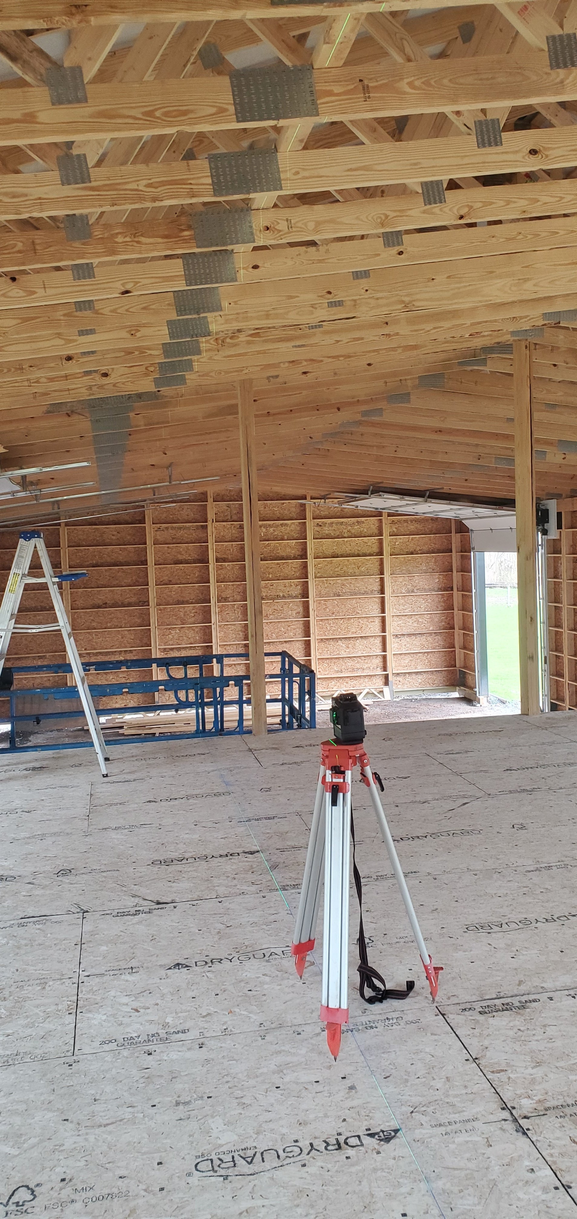

Started laying out the walls:

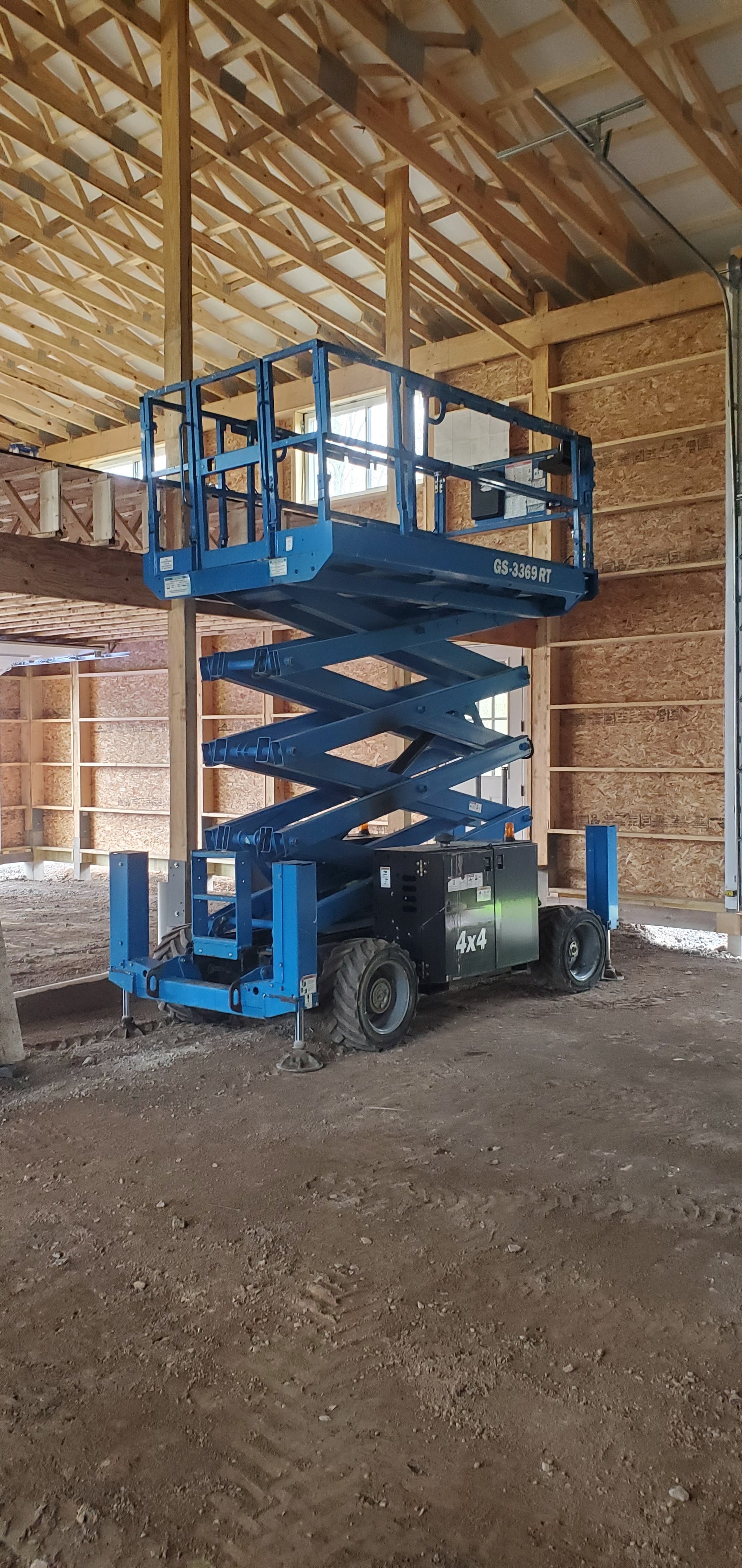

The manlift is already super useful:

Is there any sign of ridges forming were the sheet of plywood touches another sheet? I believe the gap is do minimize swelling when the plywood/osb gets wet. With a roof over your decking, and your decking remaining dry, I wonder if you need the gap.
