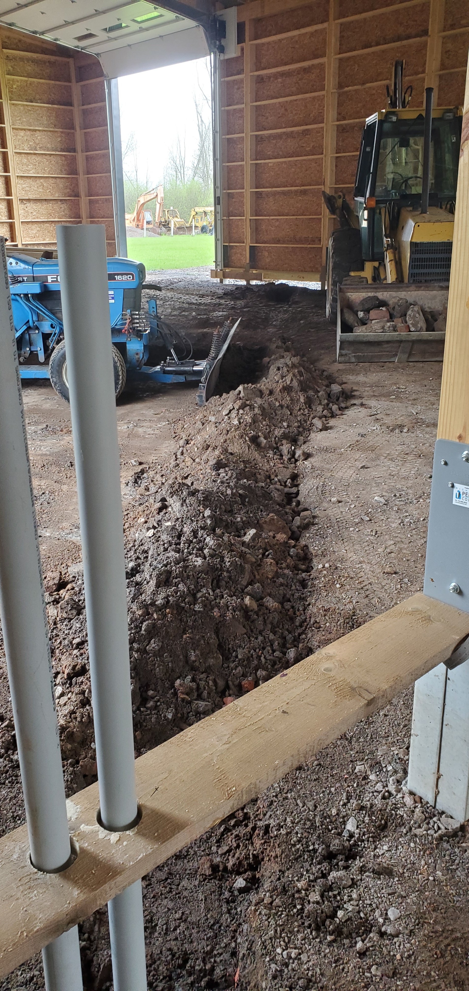

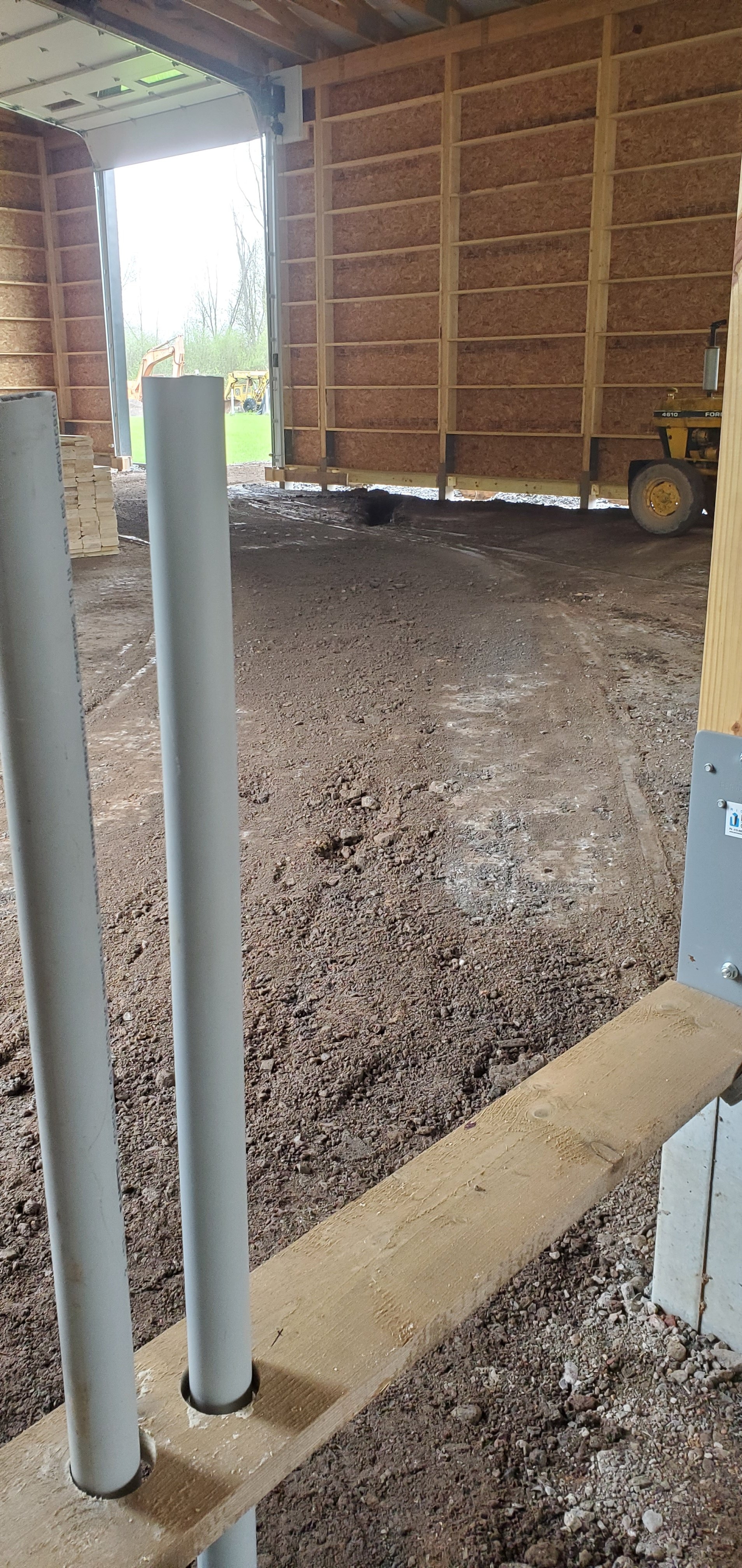

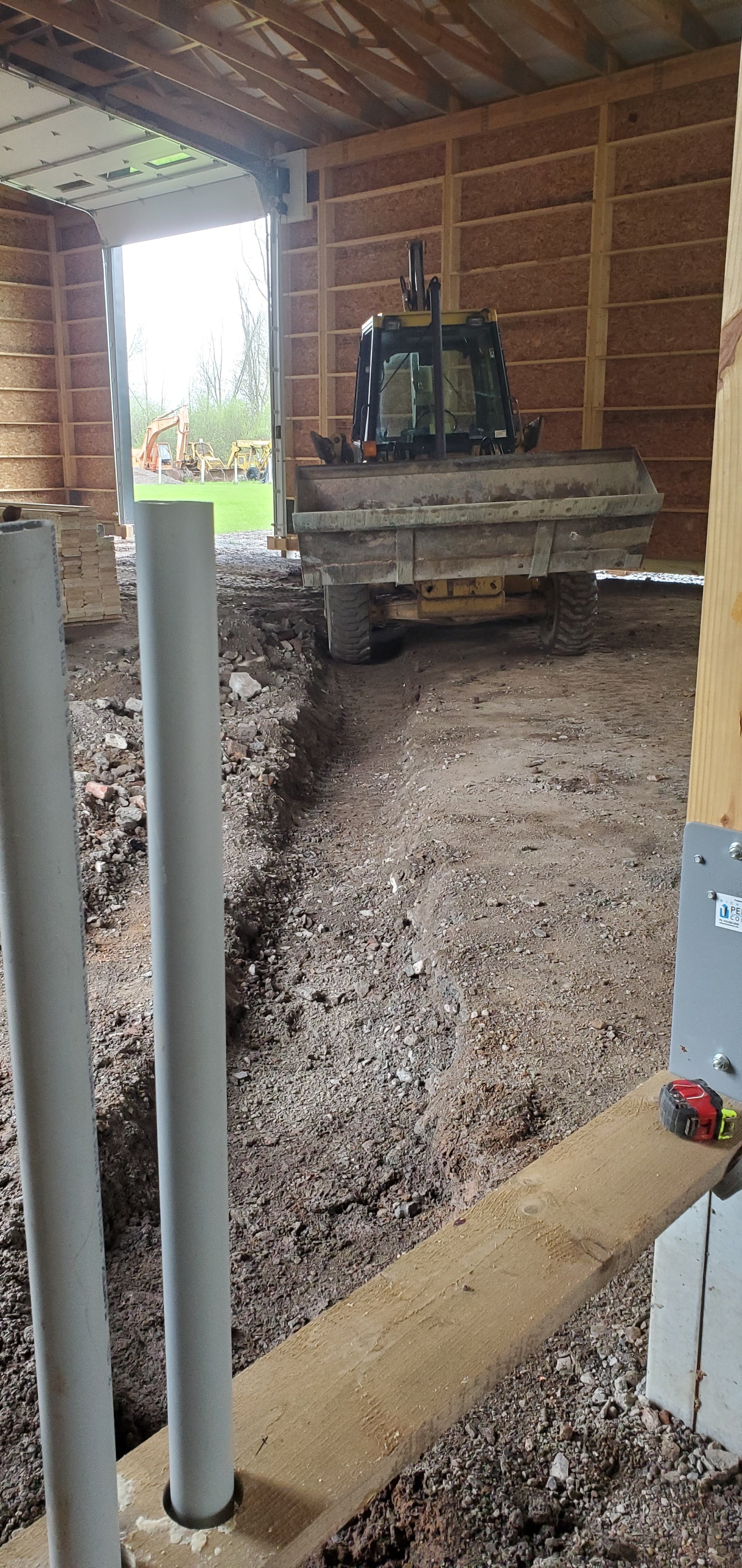

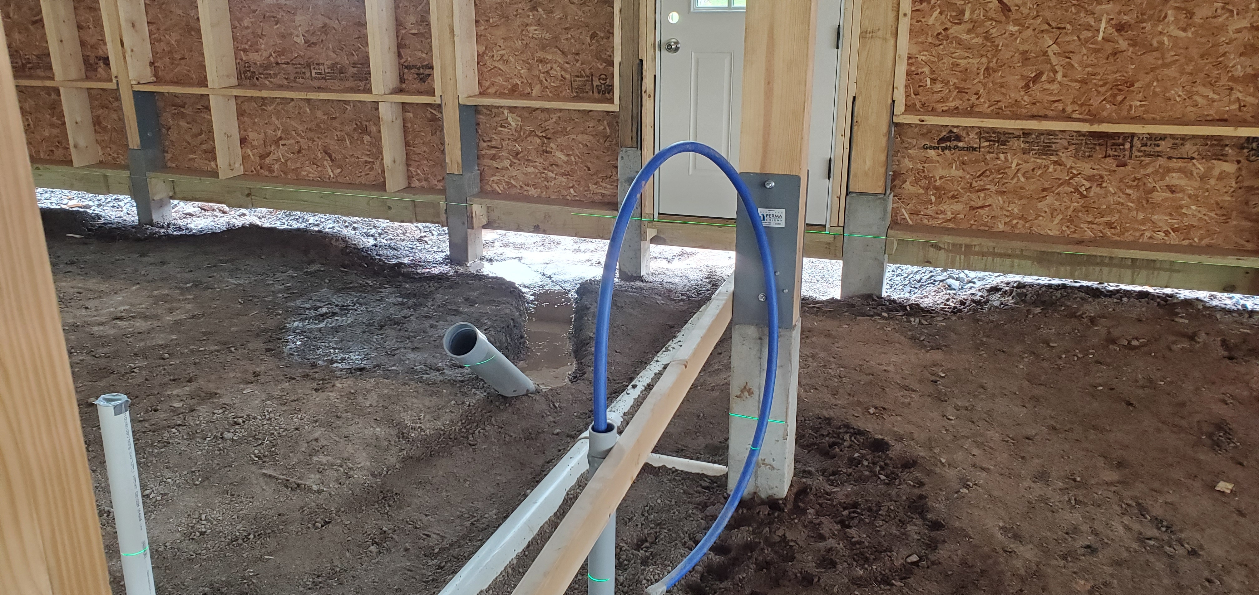

Worked on some 4" conduit today to be used in the future if I ever want to change/supplement my radiant heat system with an outdoor wood boiler or geothermal.
It will come up through the floor under the staircase.

Will 2 - 1" lines fit inside 4" conduit? I see you have a second stub line coming out at 45* is that for electrical or the second line?
When is electrical coming in?

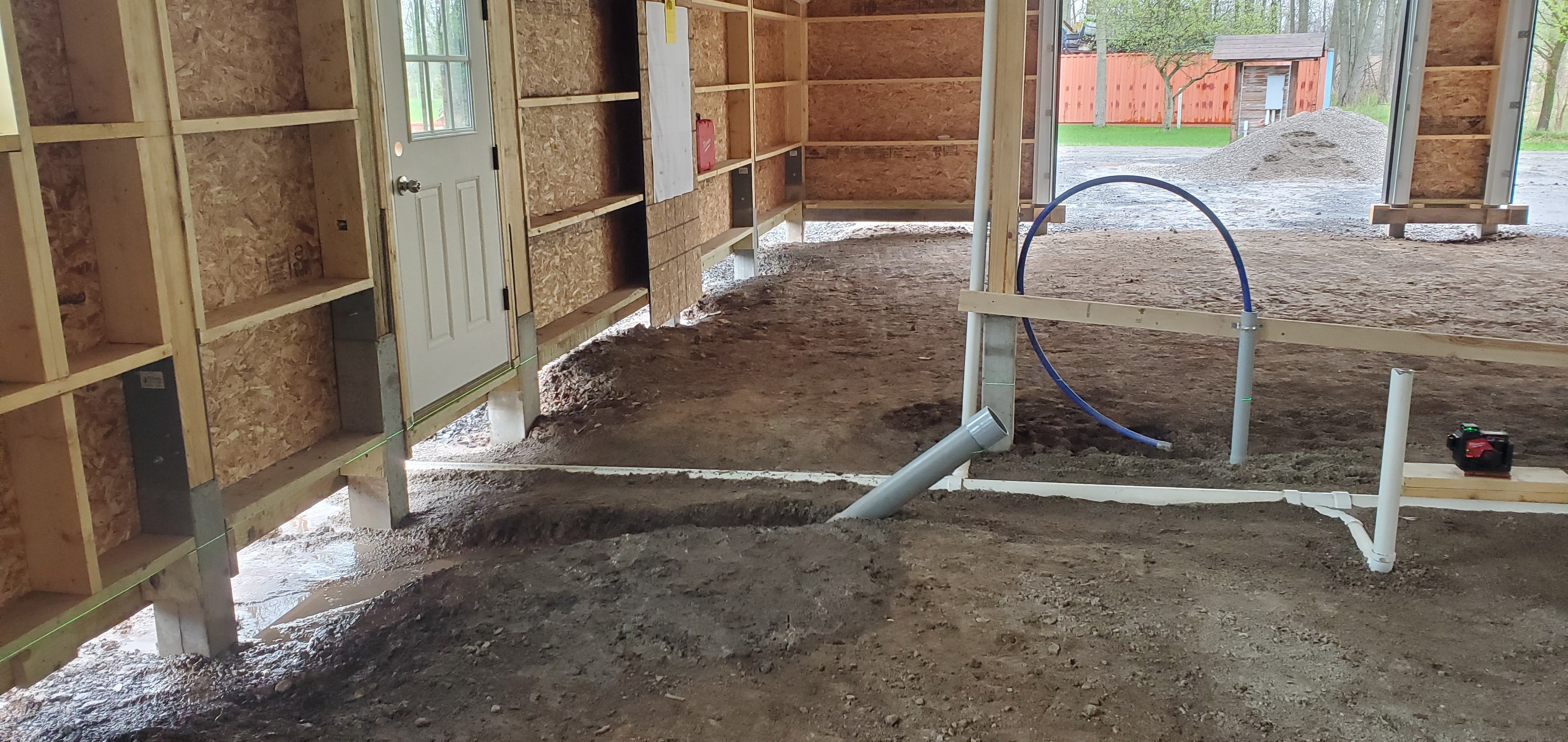

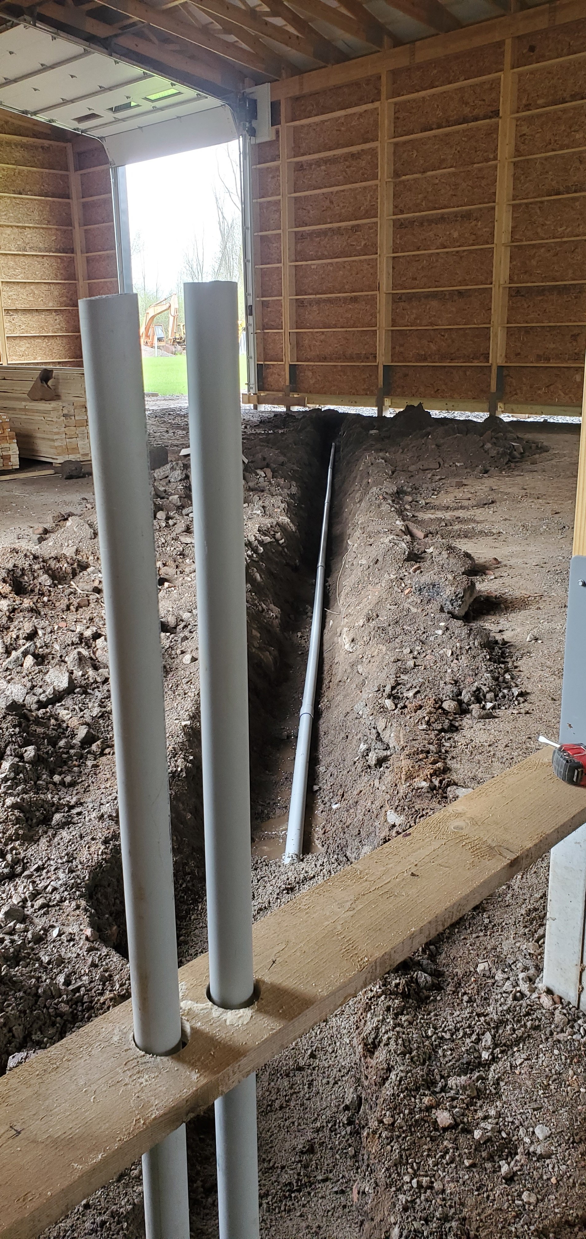

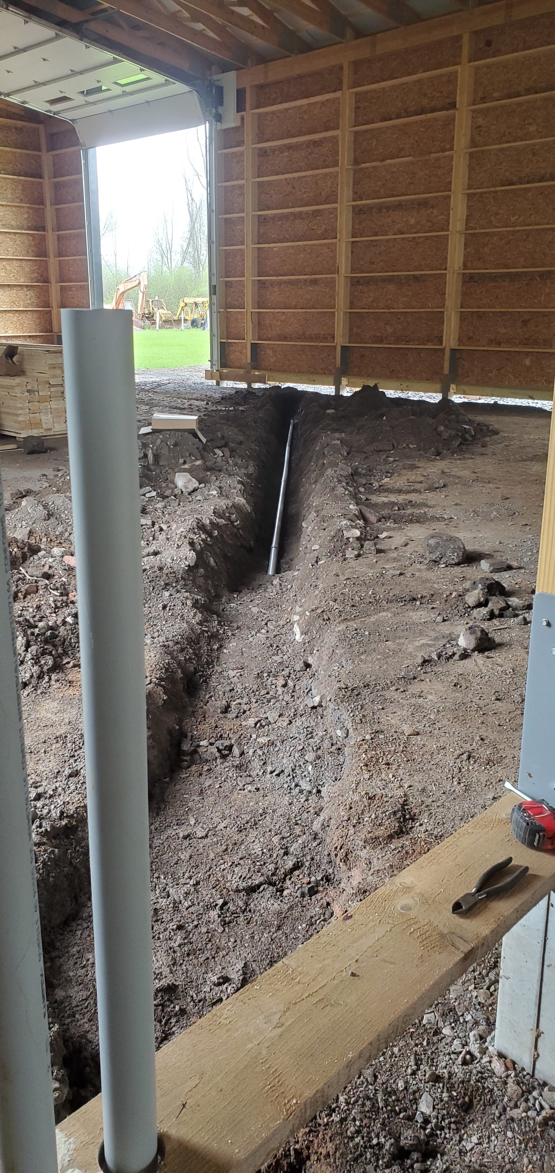

So the incoming electric conduit was done a few weeks ago:
The 2" on the left is for 200amp service from my meter pedestal. The conduit on the right is for cable.
The 4" conduit would be for insulated wrapped (2) 1" pex lines, similar to this stuff: Insulated pex
This 4" conduit it a "just in case" I want to ever change the heat source from a NG water boiler to an outdoor wood boiler. I may never use this conduit, but easier to put it in now than busting through a concrete floor with heat tube in it.

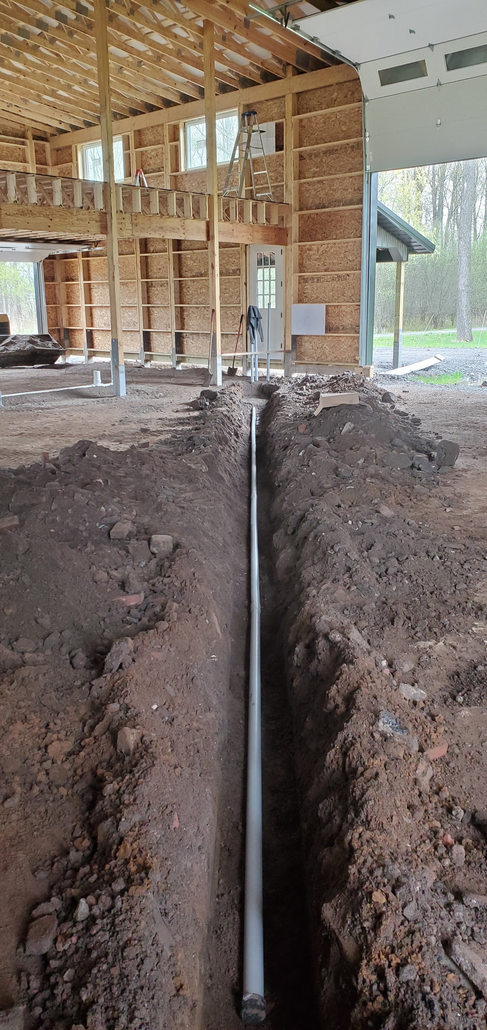

What I did today was run 2" conduit from the main panel to where I will have a secondary panel on the other side of the shop. So I don't have to run so much steel conduit along the ceiling to power things on that side of the building. My plan is to have a 200amp bus bar pass through from one panel to the next, so I basically have a main panel with full 200amps on either side of the shop:
Probably will not pull the electric from the meter pedestal to the main panel until the electrician comes back to do the rest of his work.

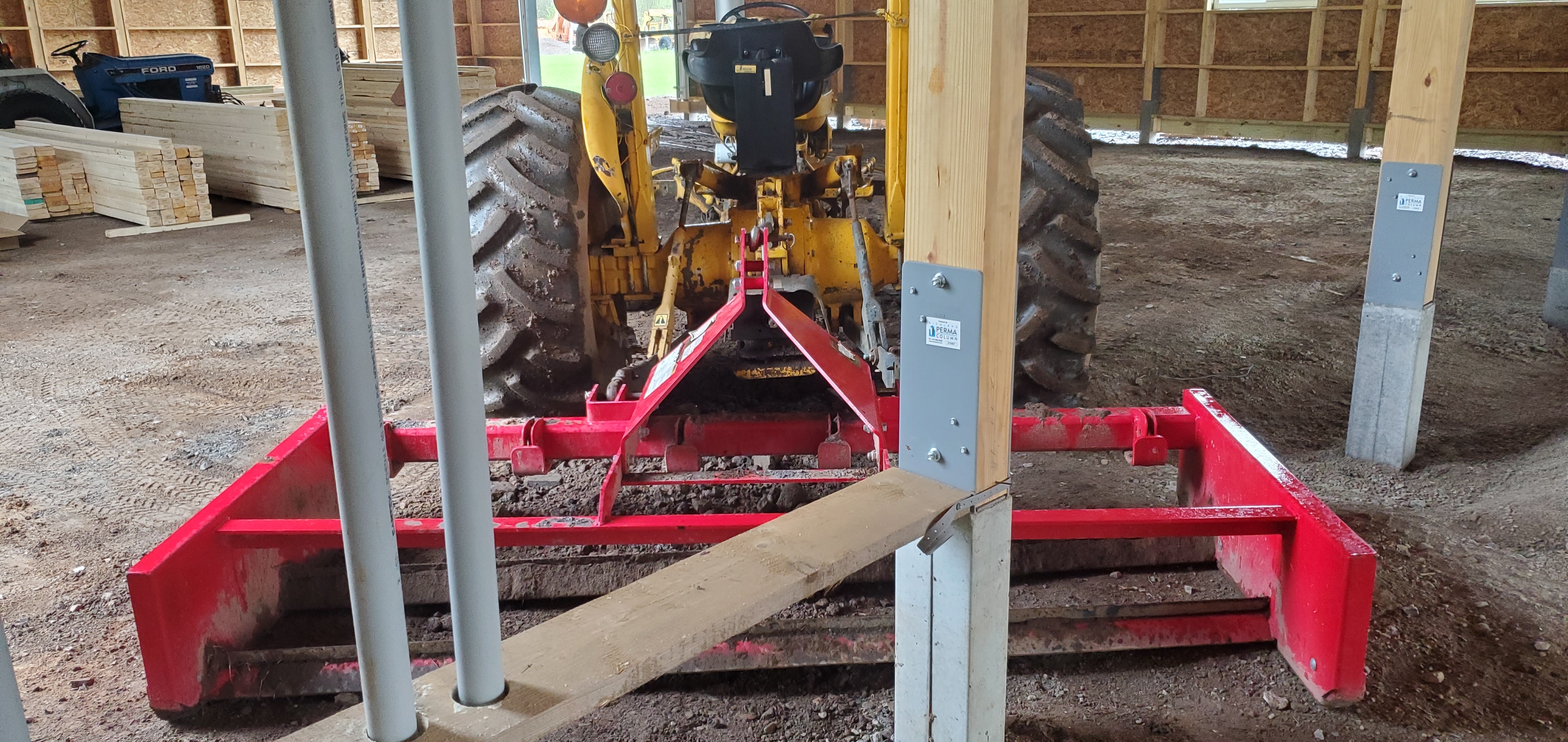

Very nice work and well thought out - and you have all the tools and machines to make it look easy. Its a lot of work working alone, doing conduit and backfilling.
Like the older iron you have the Ford 1920 with plow, the older Ford with land plane? and is that a JD BH or Case?
