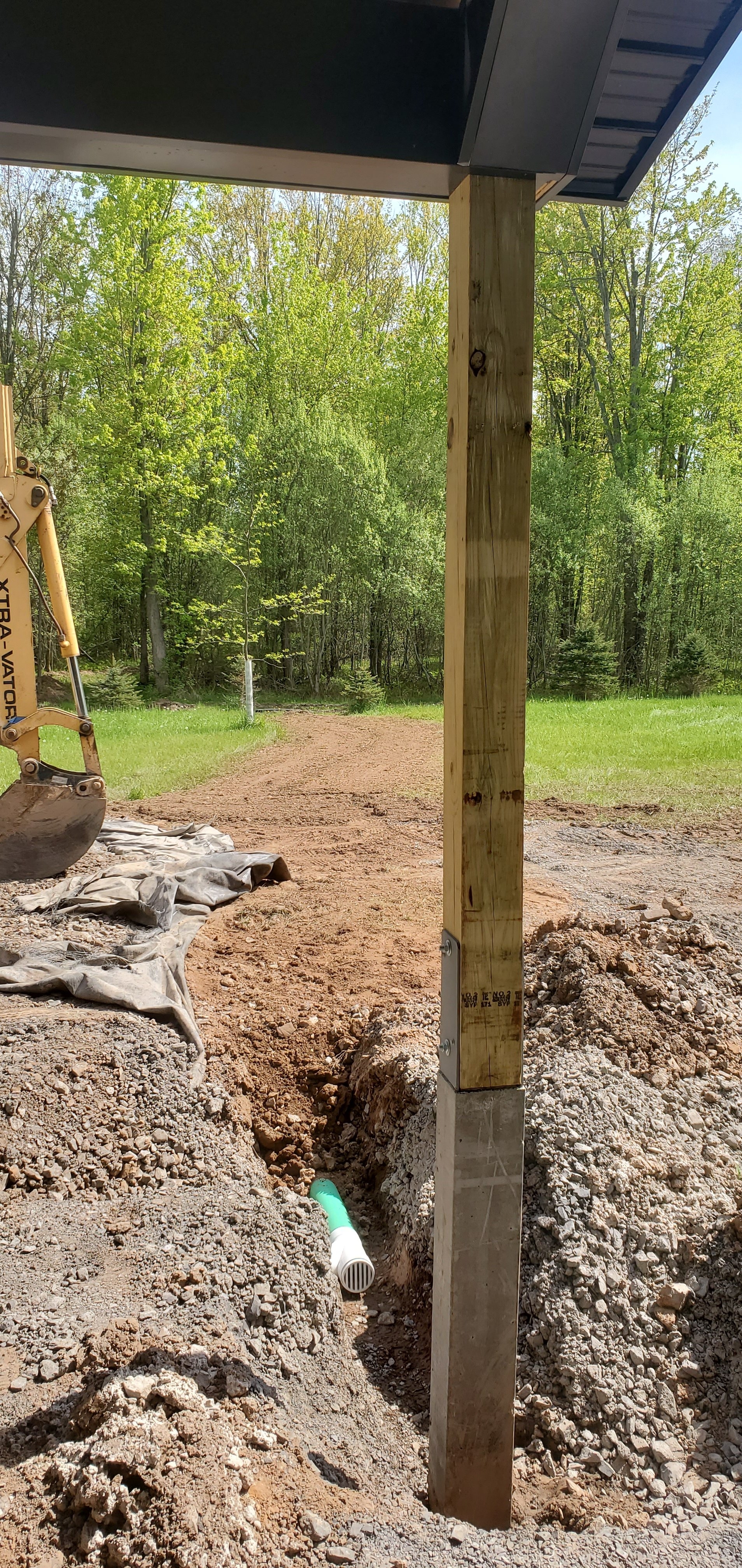

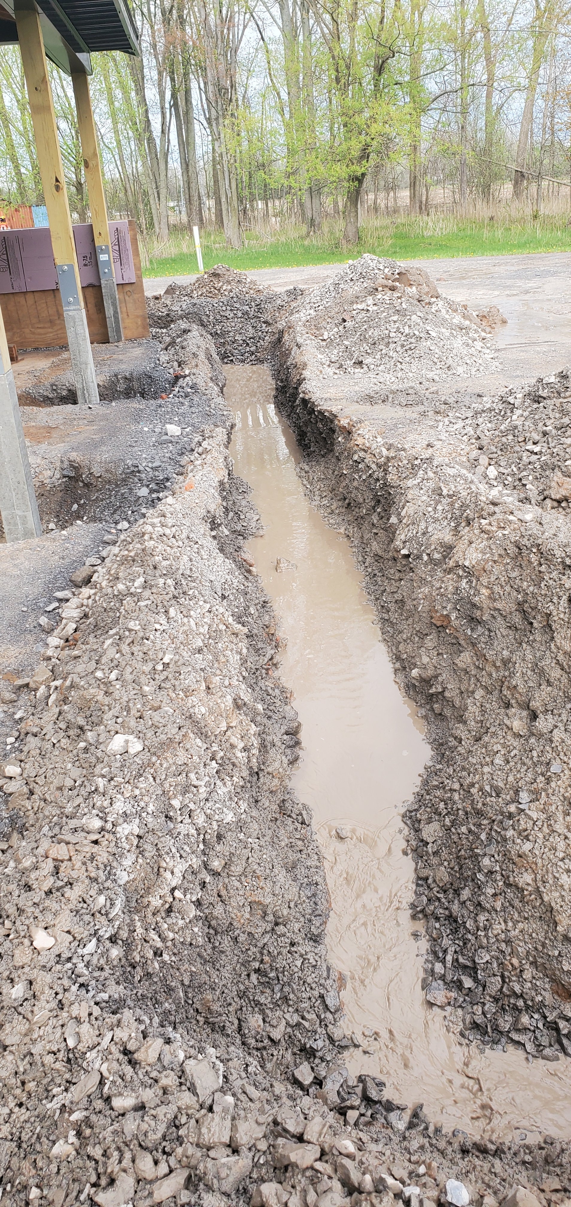

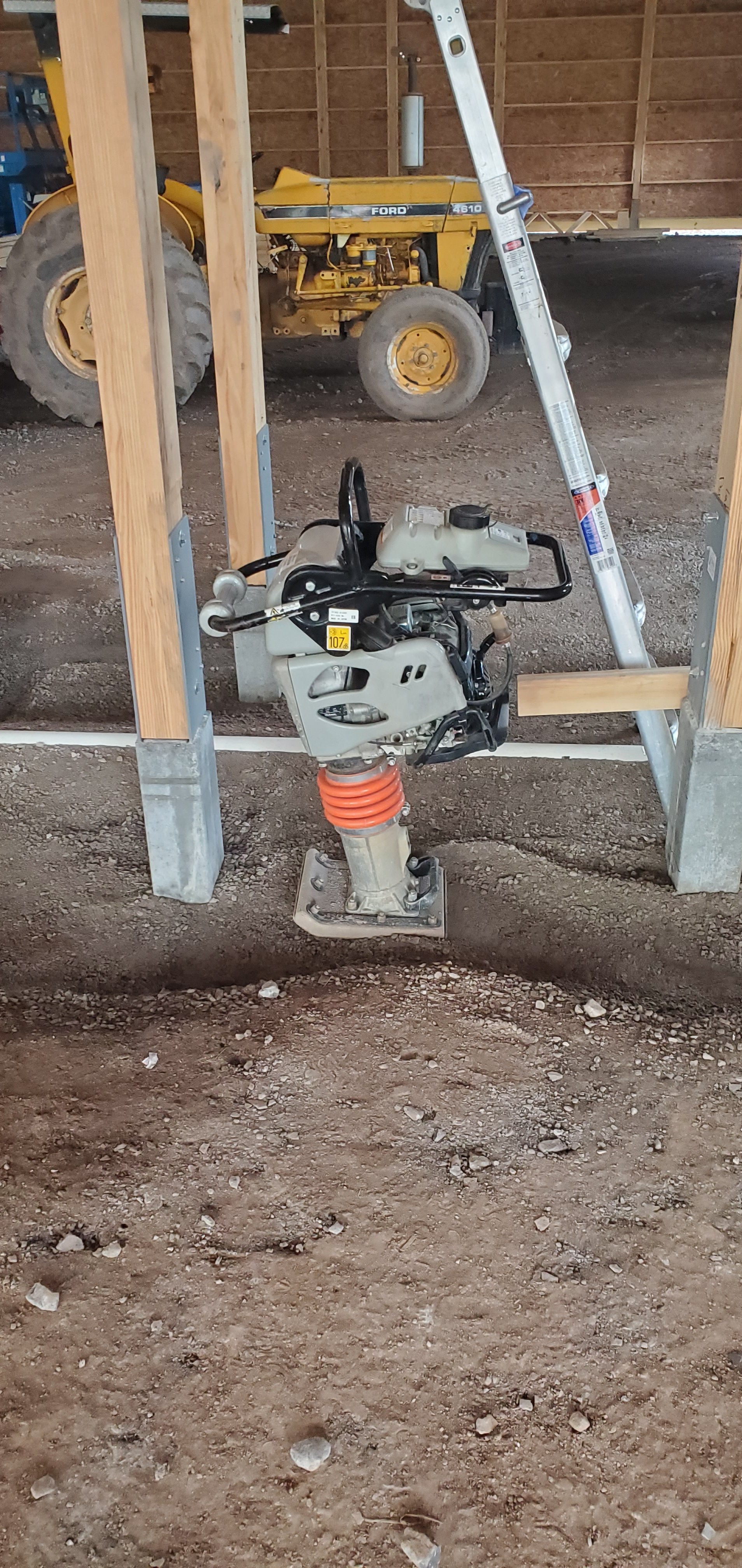

I bought a jumping jack compactor to to compact around all the columns and my conduit trenches.
Unfortunately there was quite a bit of water pumping up in some spots.

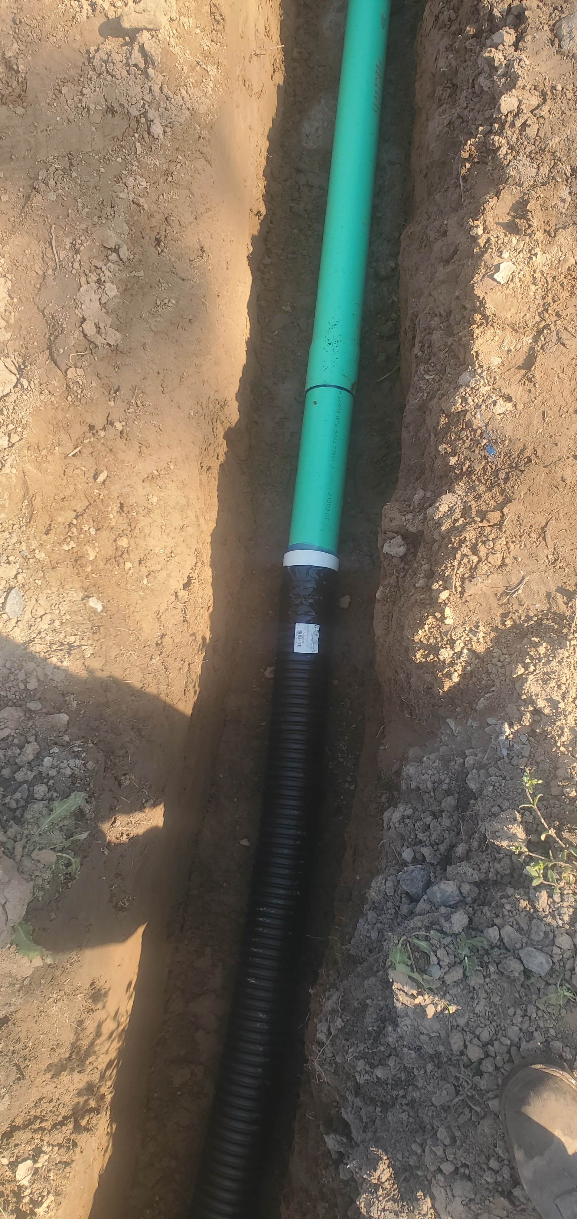

I knew I should have put in a drain tile when I backfilled the build pad last year. I decided to start on that today.
I'll probably use 6" corrugated pipe with filter sock near the building and then switch to non-perforrated to carry the water away.
It's probably going to take a couple weeks to dry out the pad so I can resume compaction.

Is all that water from the water table?
   / Barndominium/Shop or "real" House?
#545
Yes, the water table starts very high here in spring, and it's been raining pretty much every day for the last 3 weeks. From now until August the water table will drop about 5 ft.

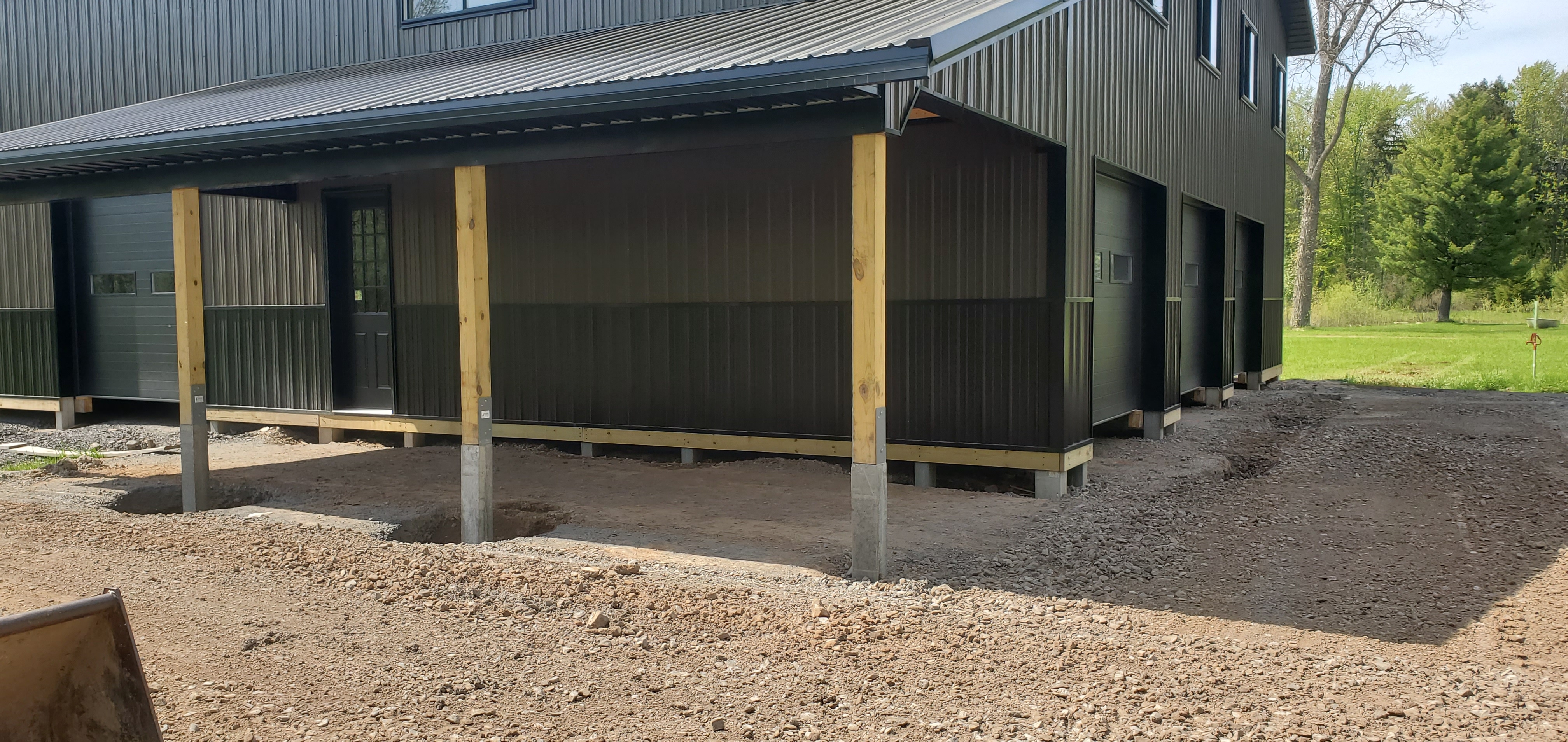

However, this water was sitting under the building pad because of the way I put in my driveway approach to the building. So definitely want drain tile on this side of the building pad so every spring I don't have so much water under the concrete pad.

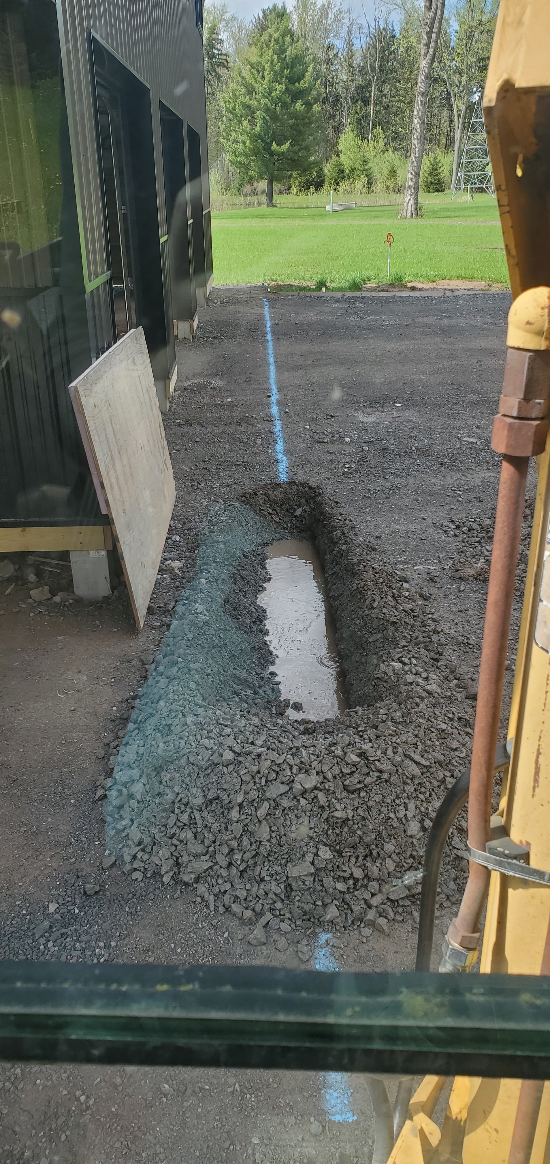

Pad Draining
I did put this drainage pipe in when building the driveway, to get water from one side to the other, but water is still getting underneath the building pad.

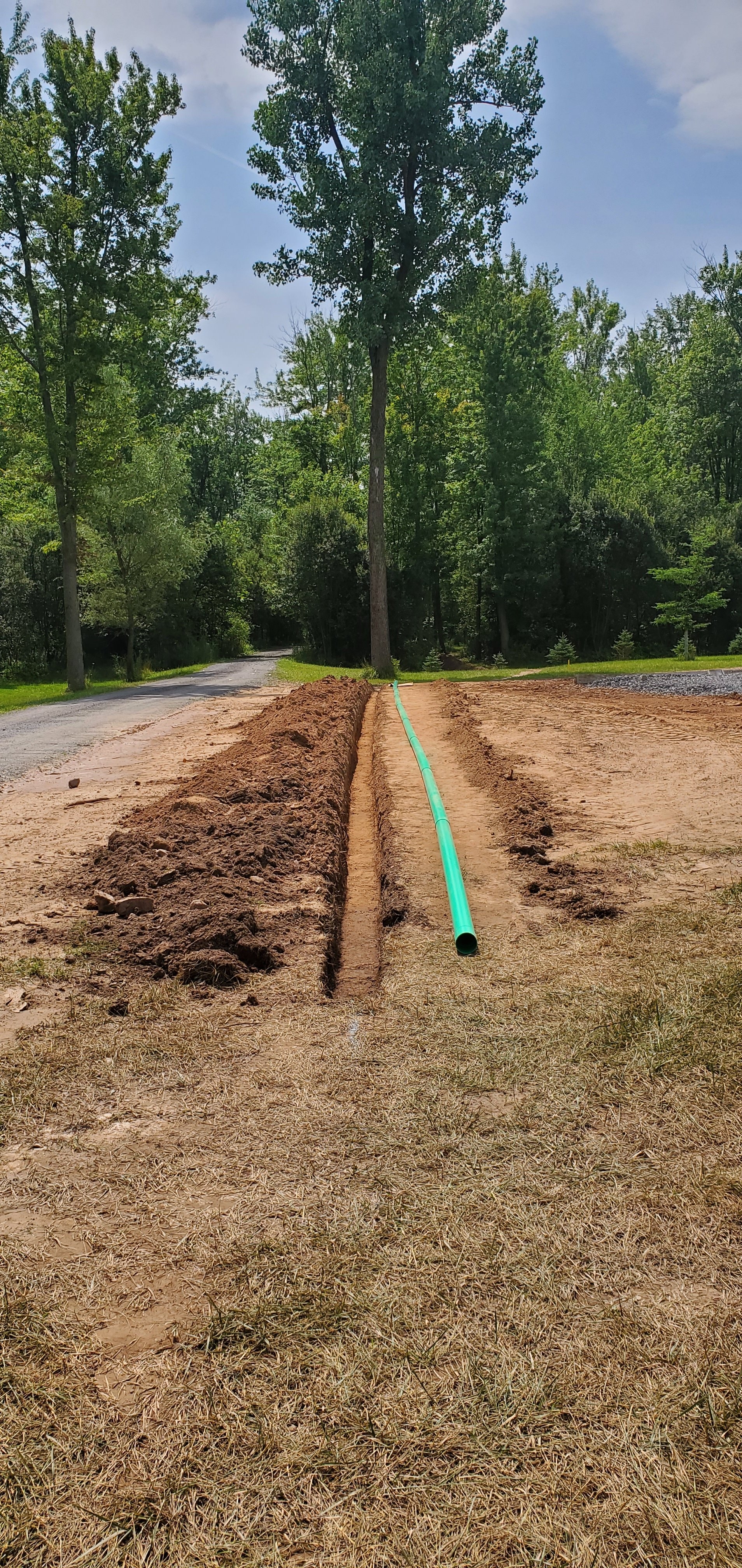

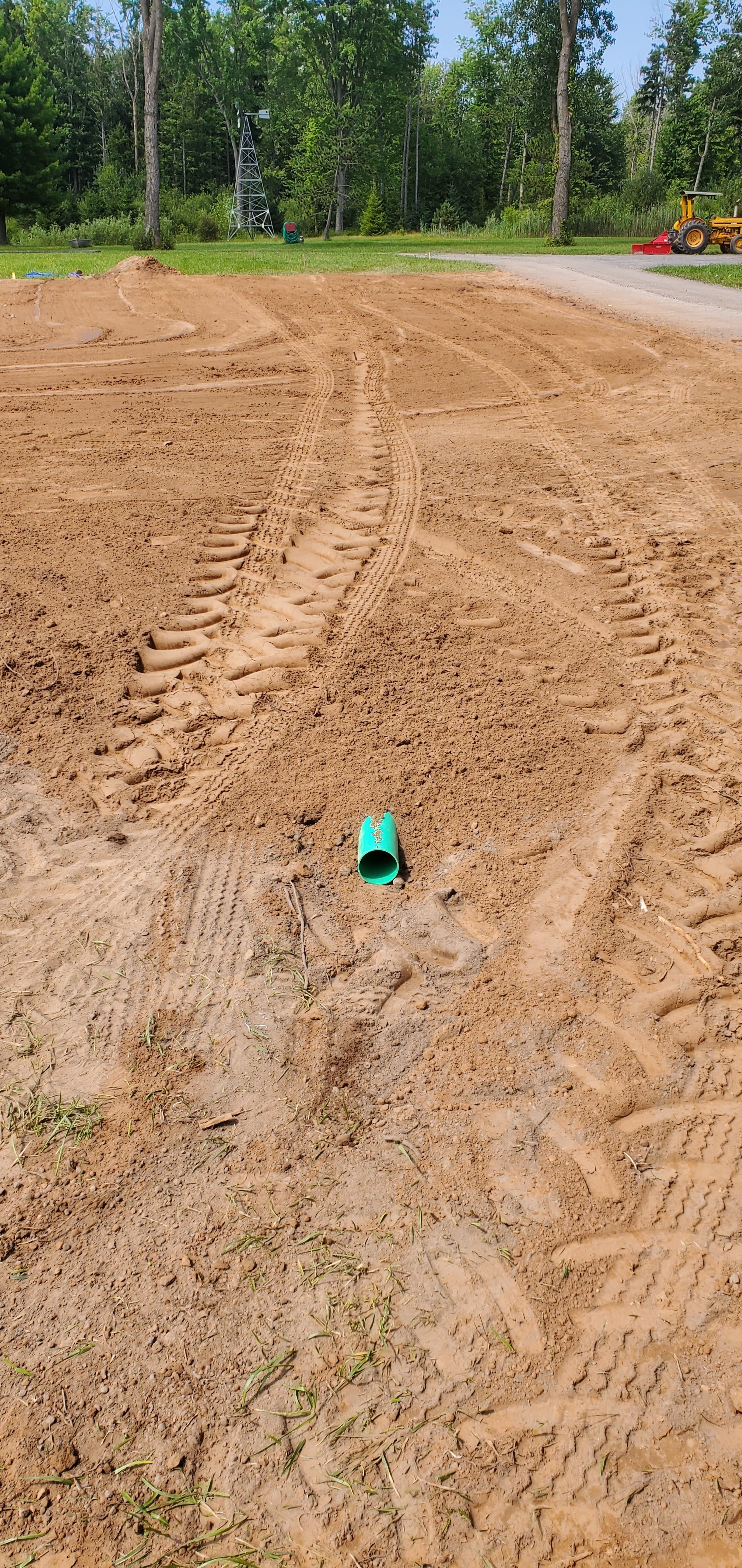

There is a drainage swale about 100ft from the building, I've already rough trenched out to it to get the water away from the pad.
I don't have any kind of fancy laser setup when I dig so will have to go back over everything with my transit when placing and backfilling the pipe to get proper pitch.

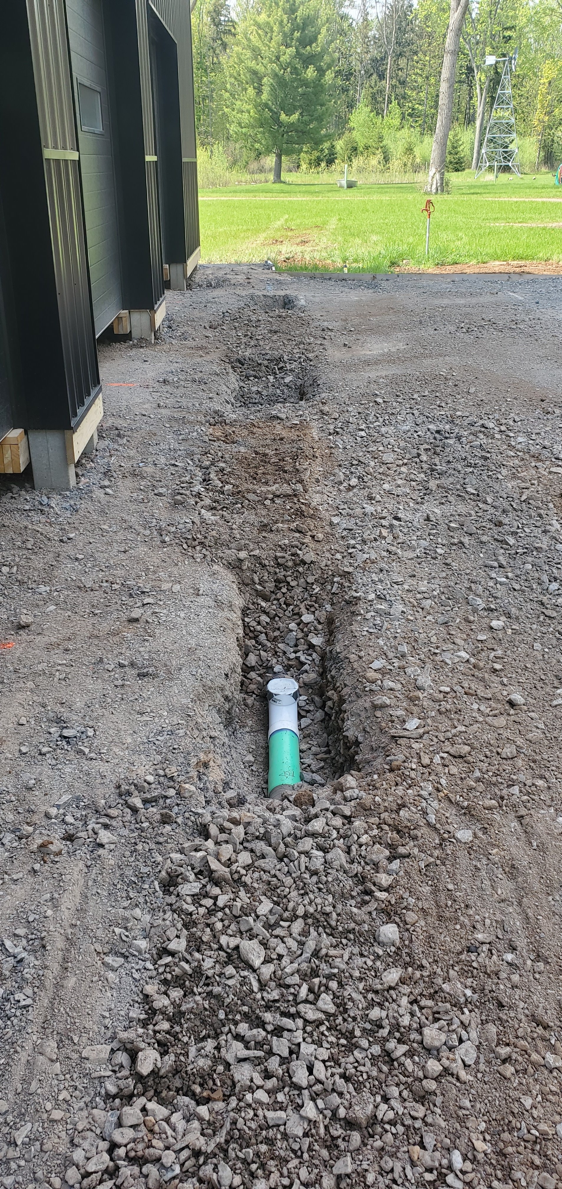

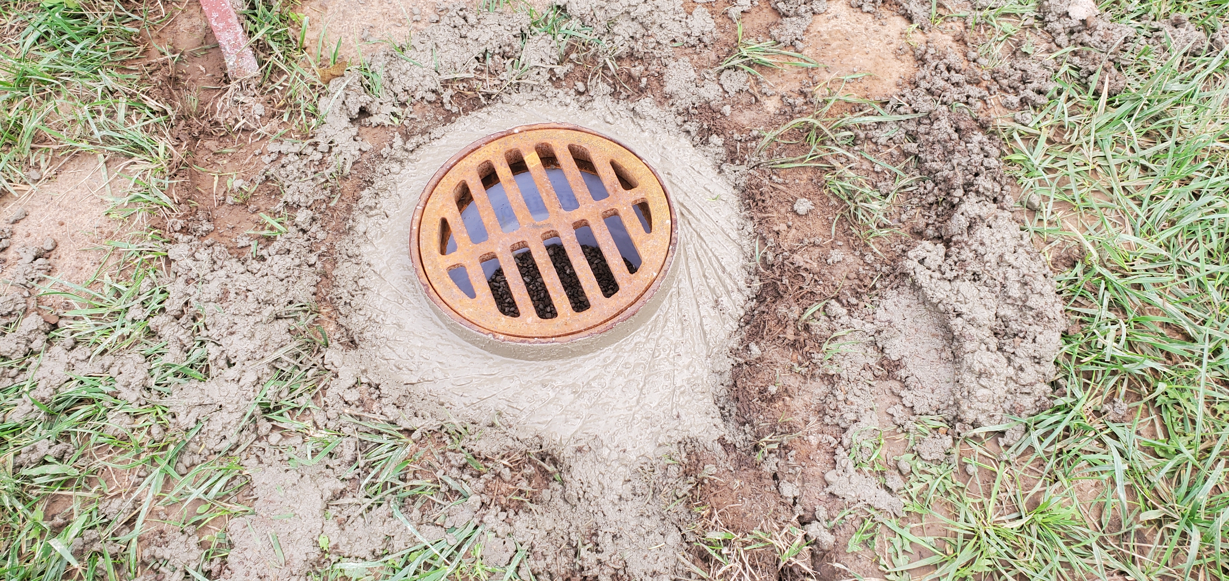

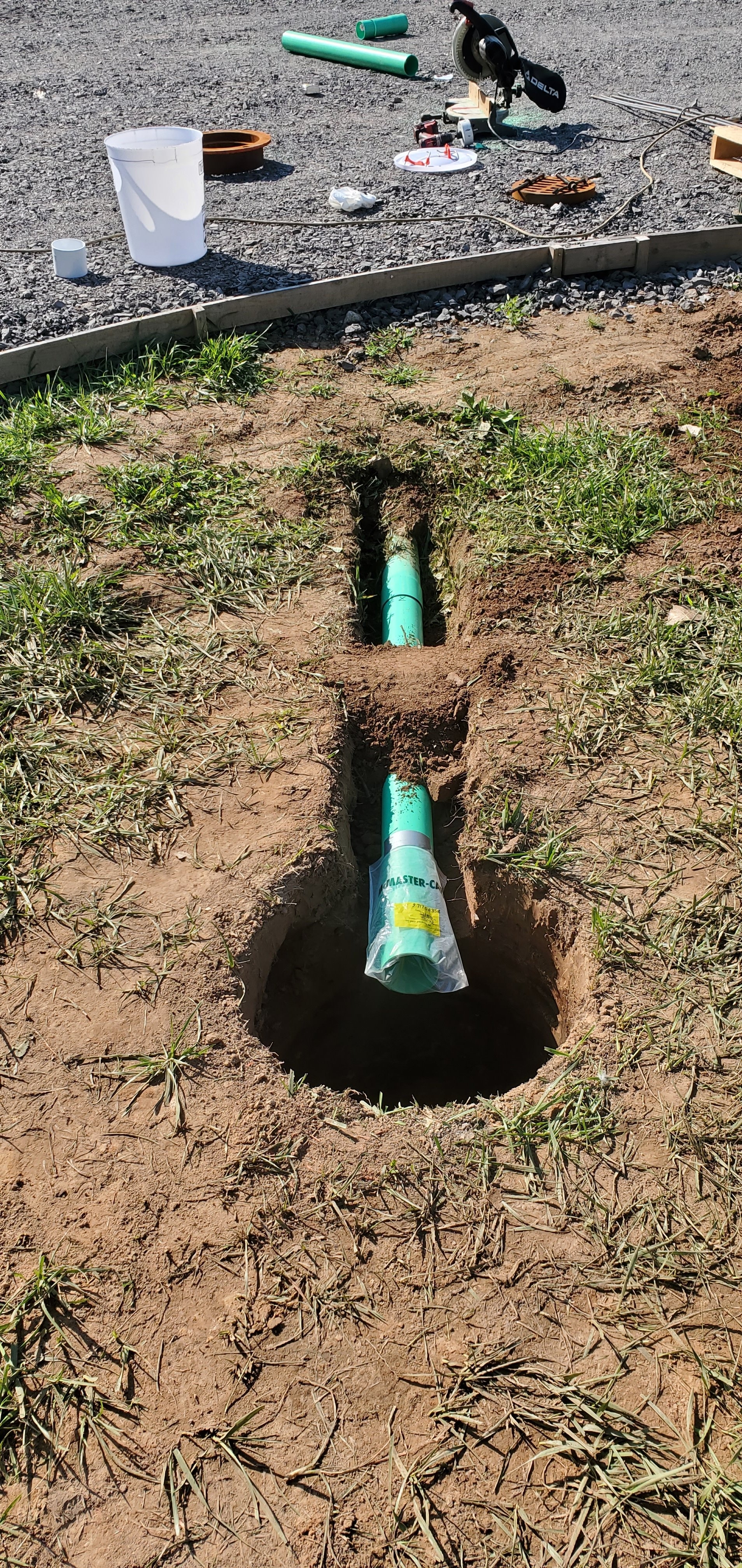

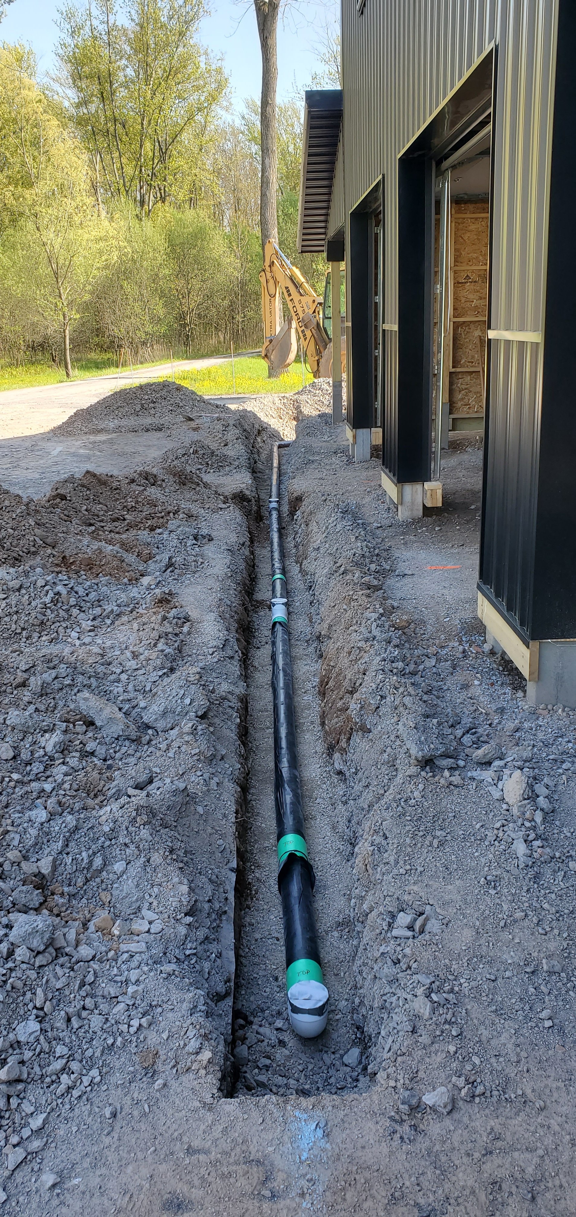

So I am mostly finished with the drainage.
That grate on the tee fitting is temporary, I will eventually connect that to the gutter on the lean-to.
My big decision now is whether or not to go with floor drains. The drains will ultimately be going to daylight so I don't need p-traps for sewer gasses. My plumber is recommending to go with drop-in check vavles to keep out drafts in the winter and critters year round.

The ditches sure dried out nicely. It's smart to take lots of pictures of what you are doing. It seems like it would be easy to remember where everything is, but in ten years, those pictures will be priceless!!!
