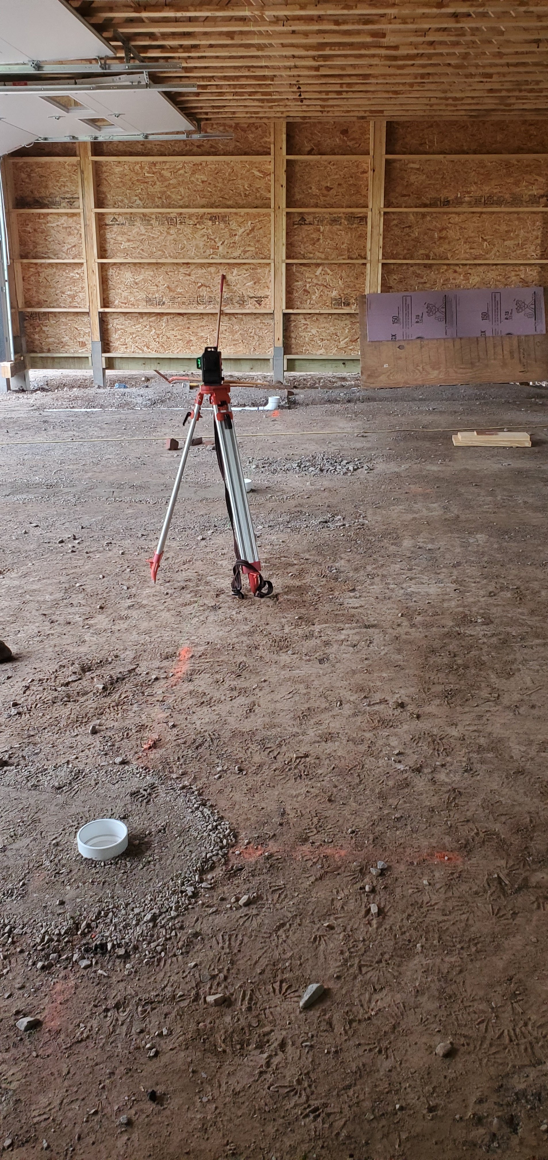

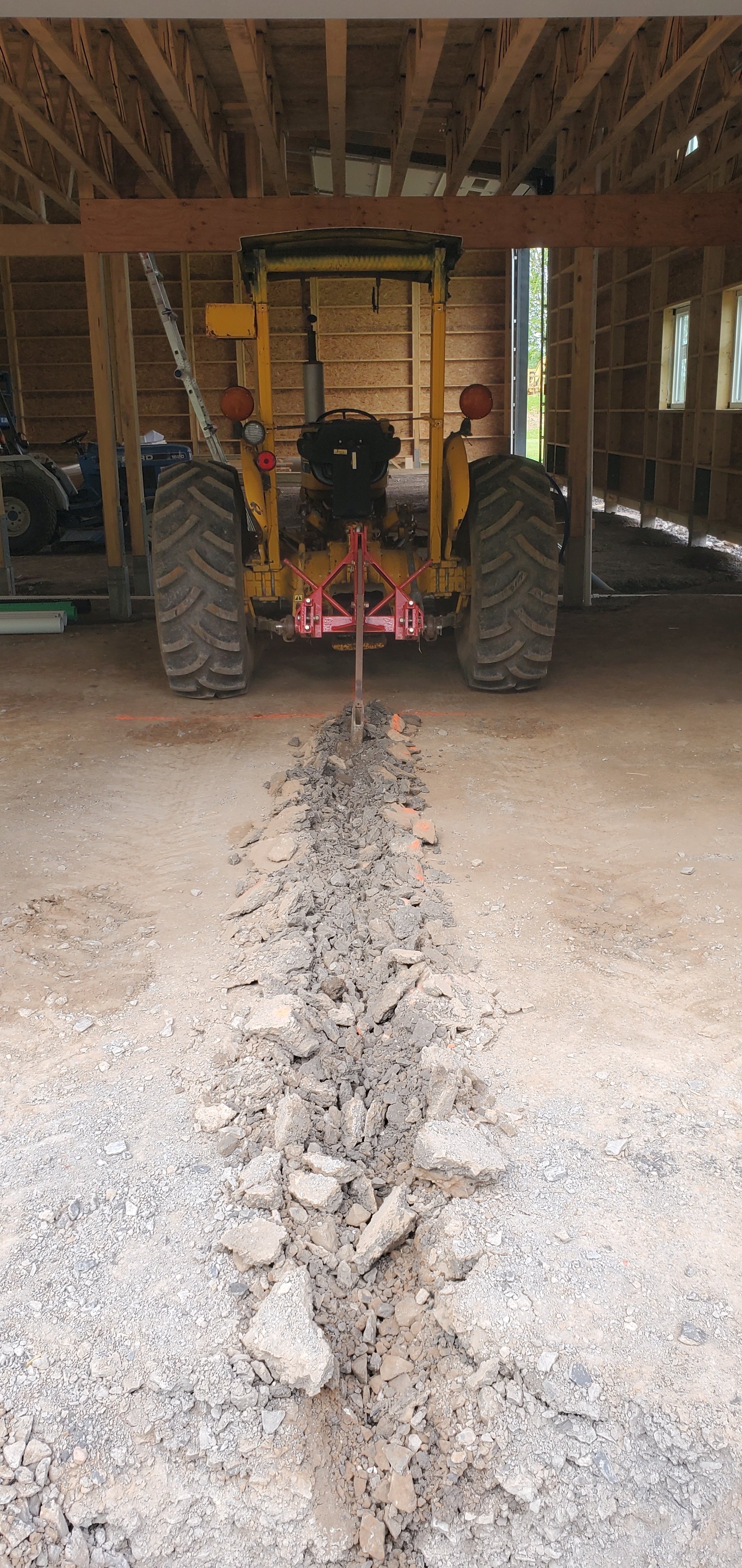

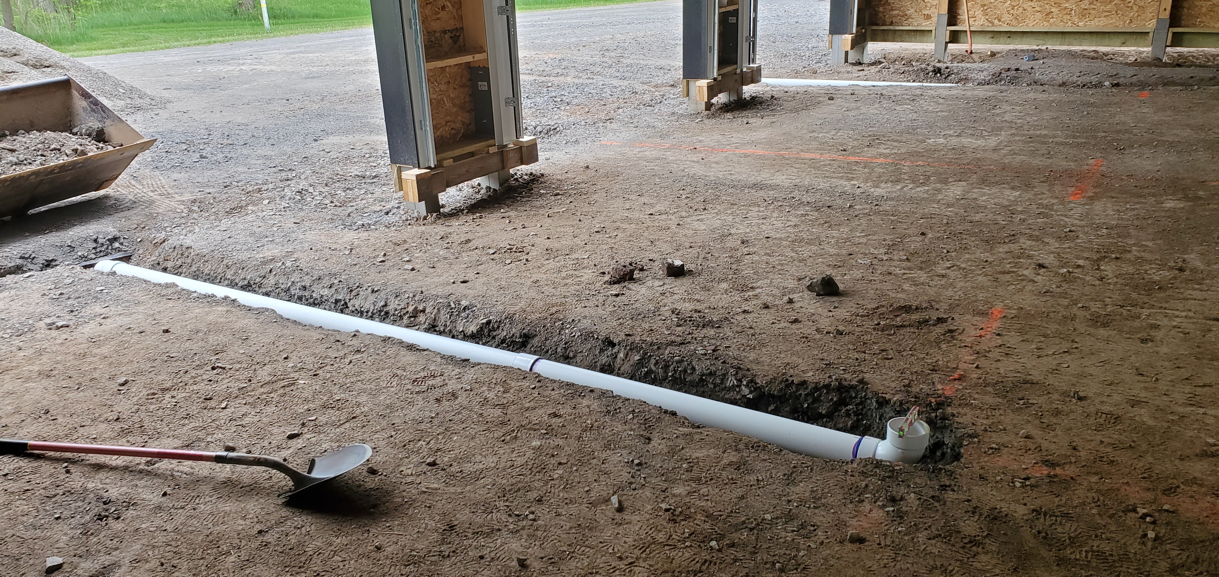

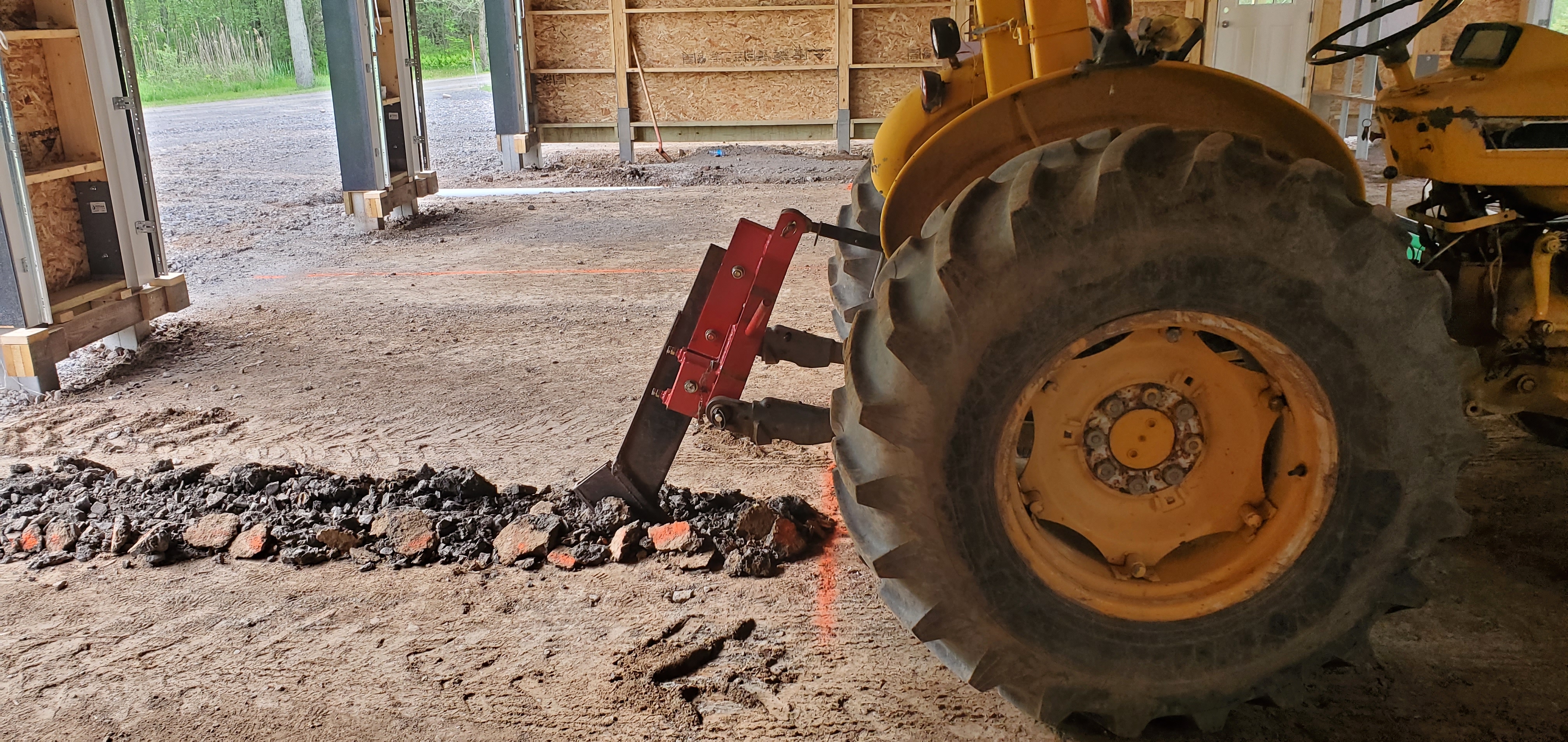

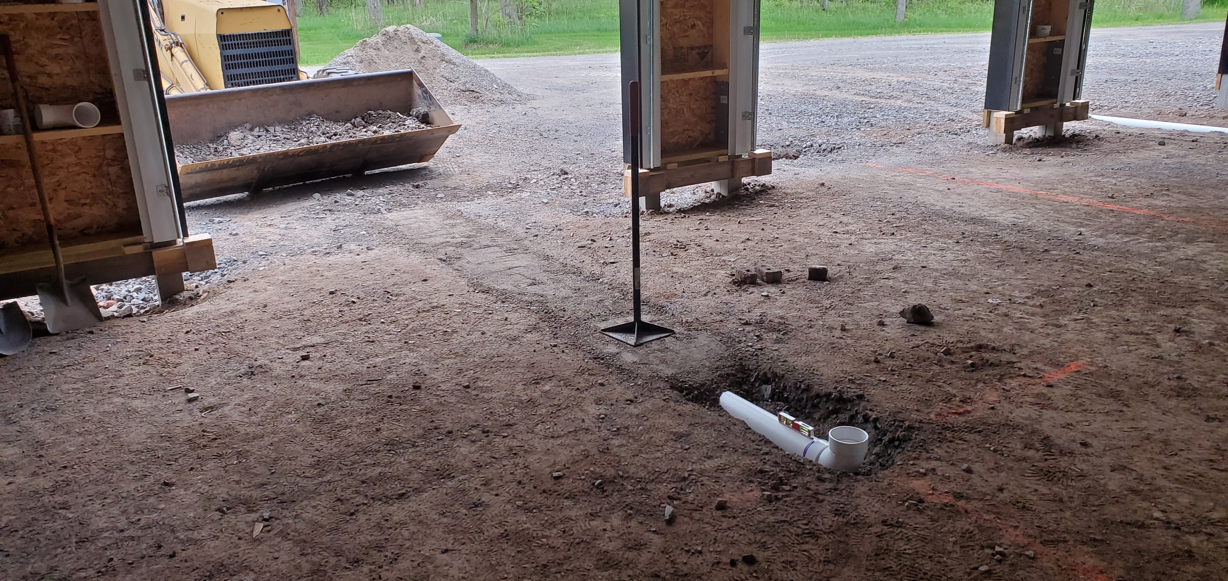

It was a backbreaking day today. But got all the garage drain plumbing installed:
Even though I had the ripper on the 4610 tractor to break up the compacted stone & hard fill, there was still a lot of manual labor. Lot of pick axe and shovel work.
I'm going to be using Sioux Chief 832 4" adjustable drains.
I didn't have a ton of elevation to work with. I set the drains to be 1" below the finished floor, with another 1/2" adjustment downward if the concrete contractor want's them lower for some reason. From my research a 1" depression sloping to the drain in an ~8ft x 16ft area should be enough for ice melt off of vehicles.
   / Barndominium/Shop or "real" House? #560
First time I've ever seen a subsoiler used indoors! :D
