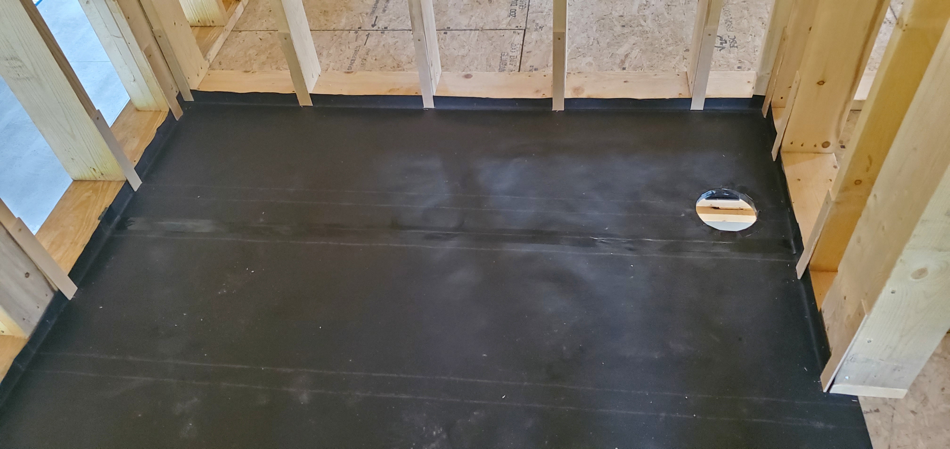

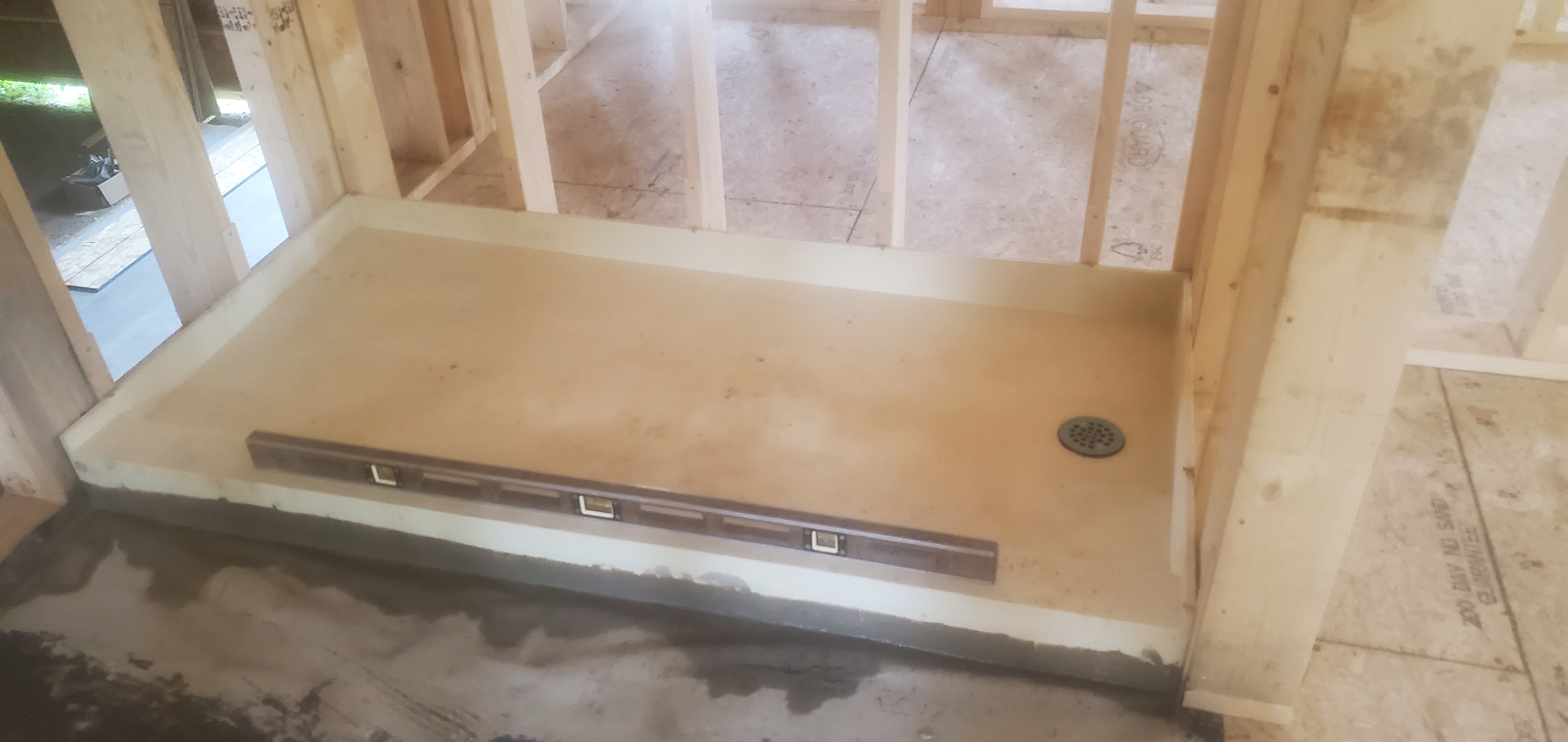

I put in the shower pan today, seemed to go in ok.
   / Barndominium/Shop or "real" House?
#664

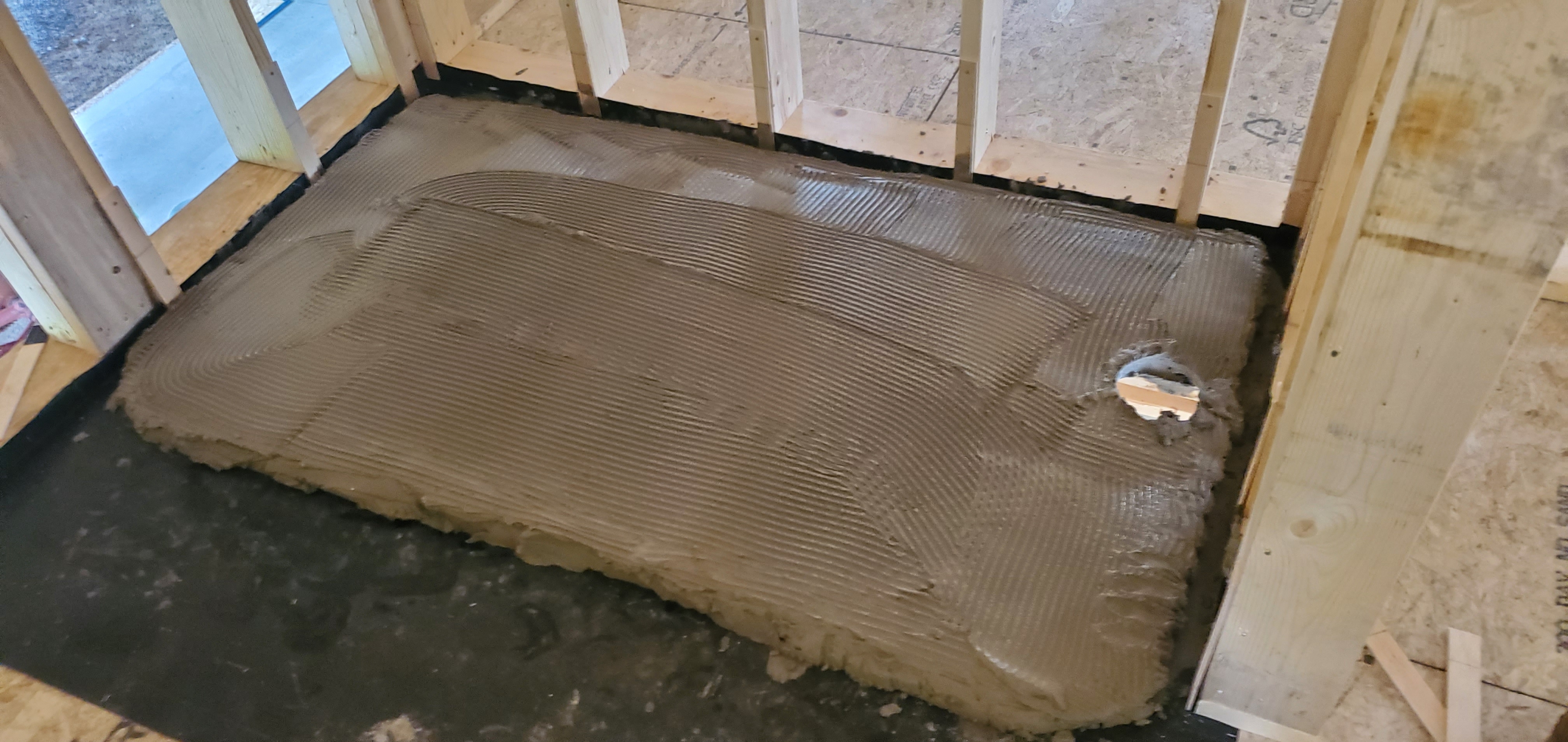

I was concered about the pan a bit, as the directions said to mix the mortar quite wet. The pad slogged around a bit if I pressed on it in certain areas after I had it set in place and put in set screws above the lip to keep it from floating up. I was worried some parts would not be fully solid after the mortar started to cure.
Checked on it yesterday and the pan seems to be very solid in all places, no weak spots where the tiles could move and cause grout to crack.
The instructions also showed how to calculate the mortar thickness, I calculated it at 2", and there was supposed to be a 1/8" gap between the bottom ribs of the pan and the subfloor when the pan was fully pressed into the mortar. I ended up with about 3/16" - 1/4", so a bit more mortar than stated (or I had it mixed drier than the instructions). I watched a few YouTube vids on installing these and mixed the mortar like the guys in the vids. Not sure if that is an issue or not. Kind of too late now...
