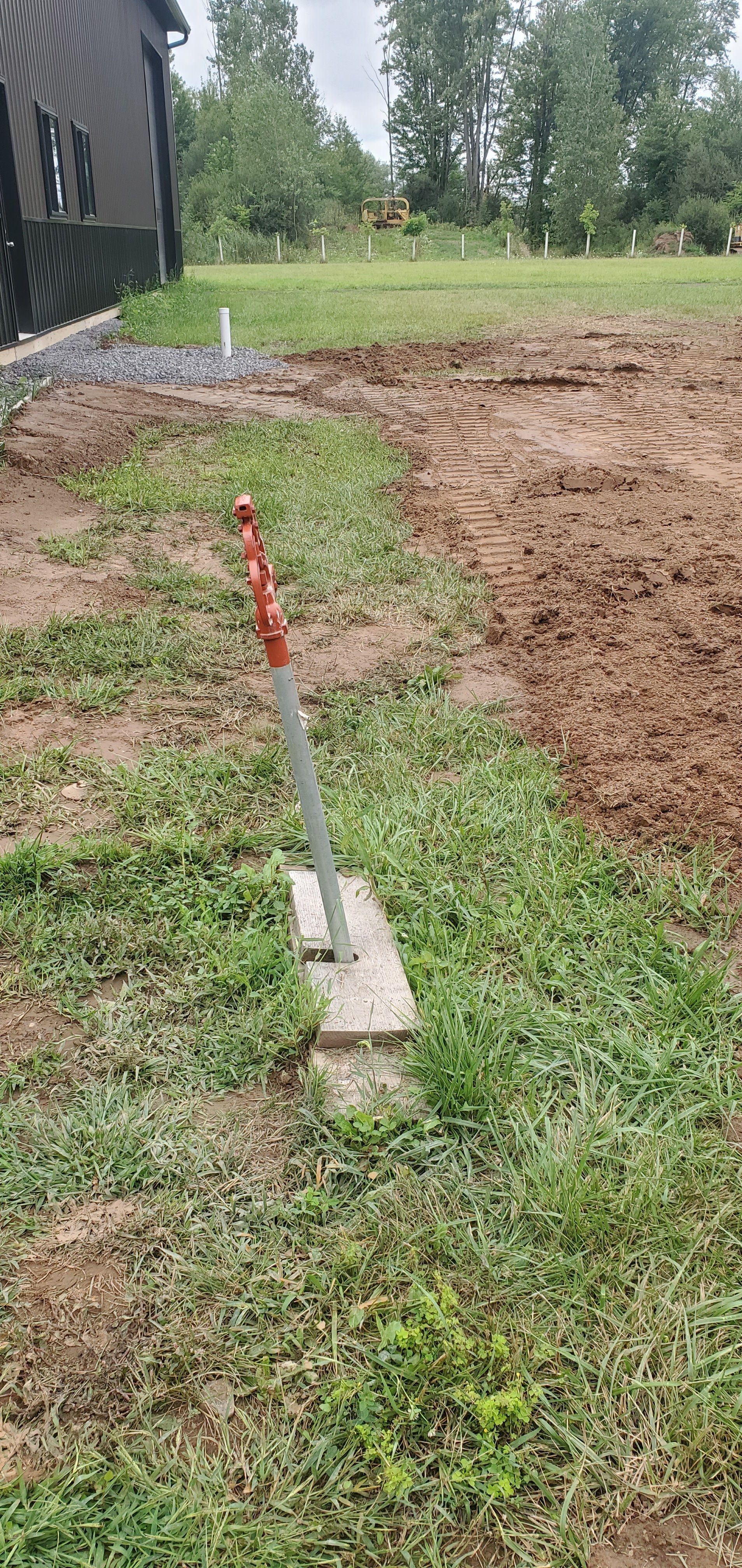

I hate days like this. Guy putting in the septic was on his last day. I noticed my yard hydrant was hit and bent to the point that it no longer functions.
I tried texting him to ask if he hit it, but no response. He was not there when I got to my build site and all his equipment was gone.
Sigh
   / Barndominium/Shop or "real" House? #676
Sometimes it's one step forwards, two steps backwards. Hopefully he'll make it right, but it sounds like another project that you'll have to do yourself. Maybe move it closer to the house so you can mow around it easier in the future?
   / Barndominium/Shop or "real" House? #677
I like Eddie's idea of moving it closer to the house. Now would be the time to do it as the lawn already needs some seeding.
Why not just eliminate the hydrant and have a tap attached to the house?
   / Barndominium/Shop or "real" House? #678
I much prefer hydrants to house taps. Less maintenance most of the time and all connections are outside.

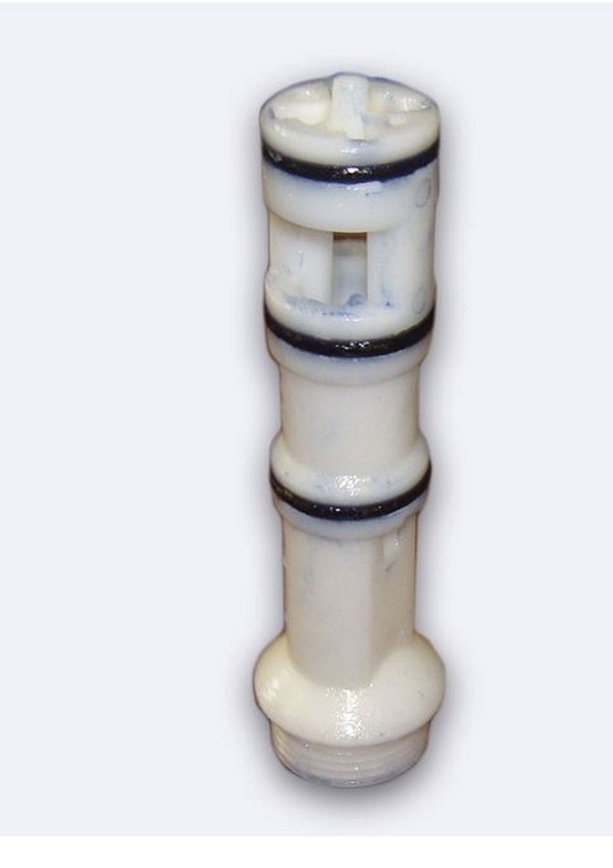

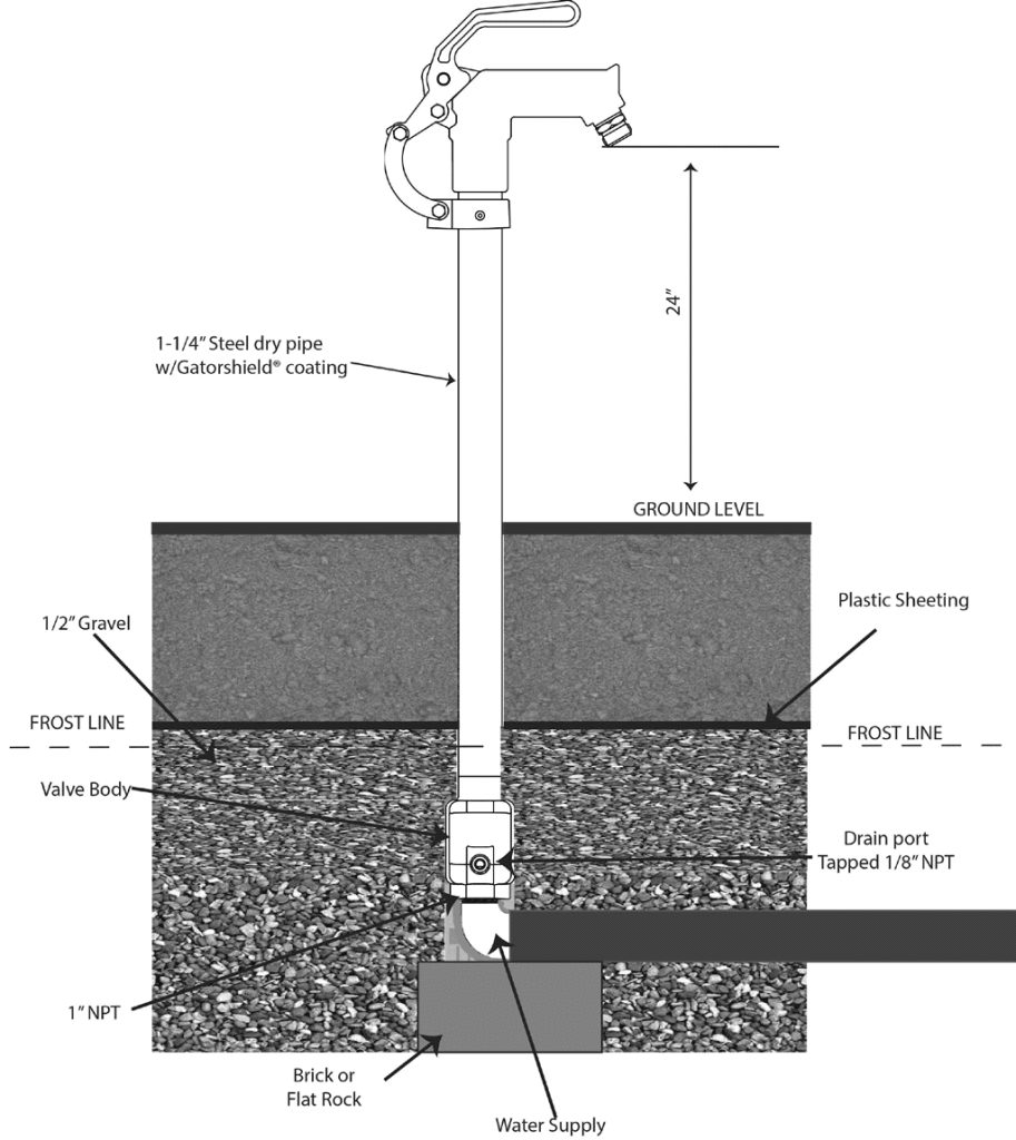

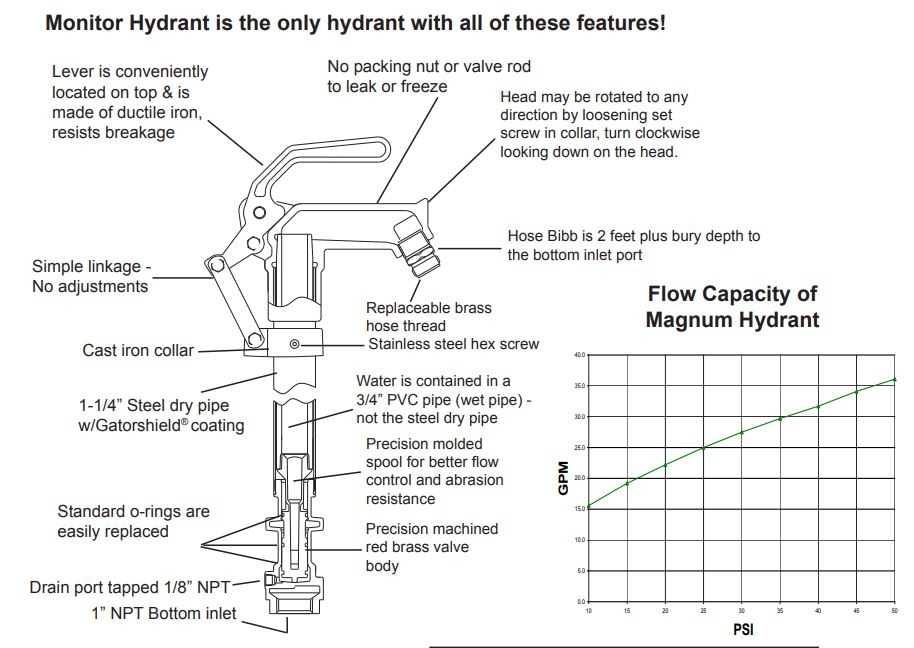

This style is the best frost proof hydrant that I have ever had: Baker Water Systems - Monitor® Magnum Yard Hydrant
The water valve works just like a hydraulic spool valve. And after the hydrant is installed the handle can be rotated to any position desired then held there with the set screw.

Hydrant can't move due to a deck that will be built off the back. And I specifically went with a hydrant so I didn't have spigots on the outside of the building.
I just put this in last year, pisses me off it's already another project that needs taking care of.
