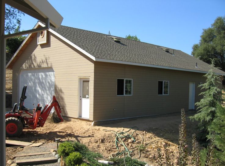

Here is one of the few pictures I have from the inside of the property showing the shop. This is earlier in the construction and shows the side door and bathroom window. I was digging some trenches for drainage earlier and parked the tractor over the area after I finished.
I forgot to say in the earlier post this is 30'x50' shop with 10' walls.
