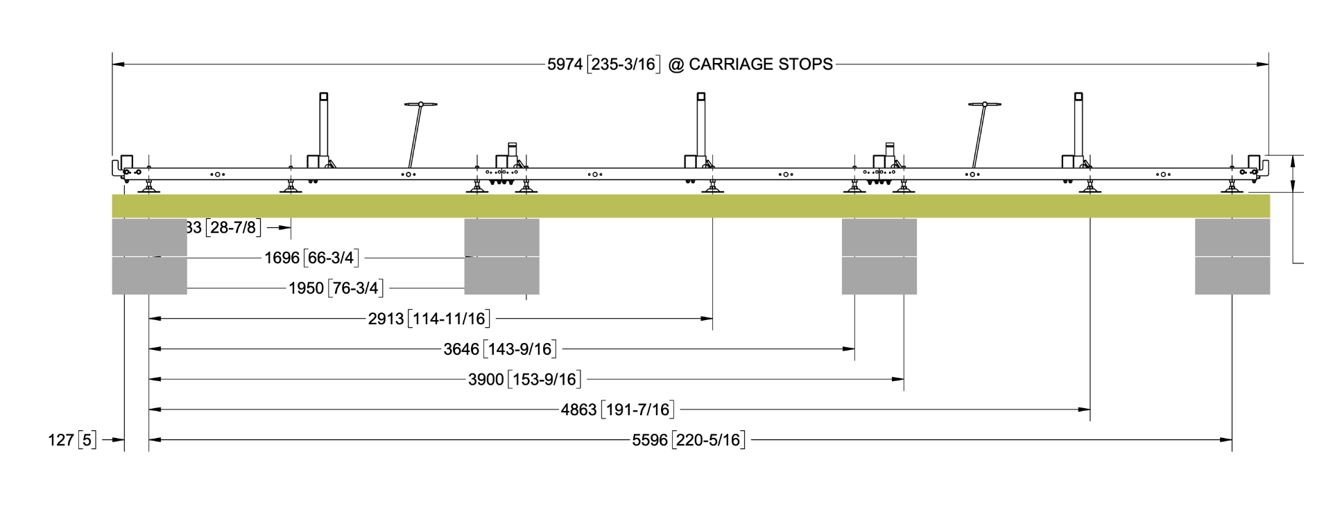

I'm in a chicken and egg situation, since I need a base to set the mill on for deck/track assembly before I can cut any wood. So I can't really cut beams for the base unless I whip out my Alaskan chainsaw beam jig, and that's a slow process. To be honest I am a little wary of using green wood for the mill base anyway. I don't want to have to level/true the deck every time I use the mill while the beams dry out over 6-8 months.
Here's what I am thinking -- piers that are 1-2 blocks high, with a beam or timber on the top. I think I can get away with 4 piers per side and let the timber support the other feet on the deck frame. The piers would spaced about 6'4" (on center).
attachment.php
I have to dig down about 8" to get through loam/roots in this soil, before hitting clay/sand. So I either need to set the first block down low into the ground and turn it flat side down (so it won't sink into the dirt), or pour concrete to make a little base there. Based on past experience, it's about an equal amount of work to level a block down in a hole or pour concrete into the hole.

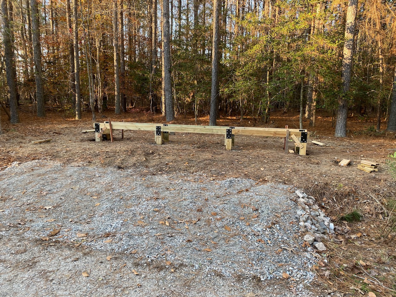

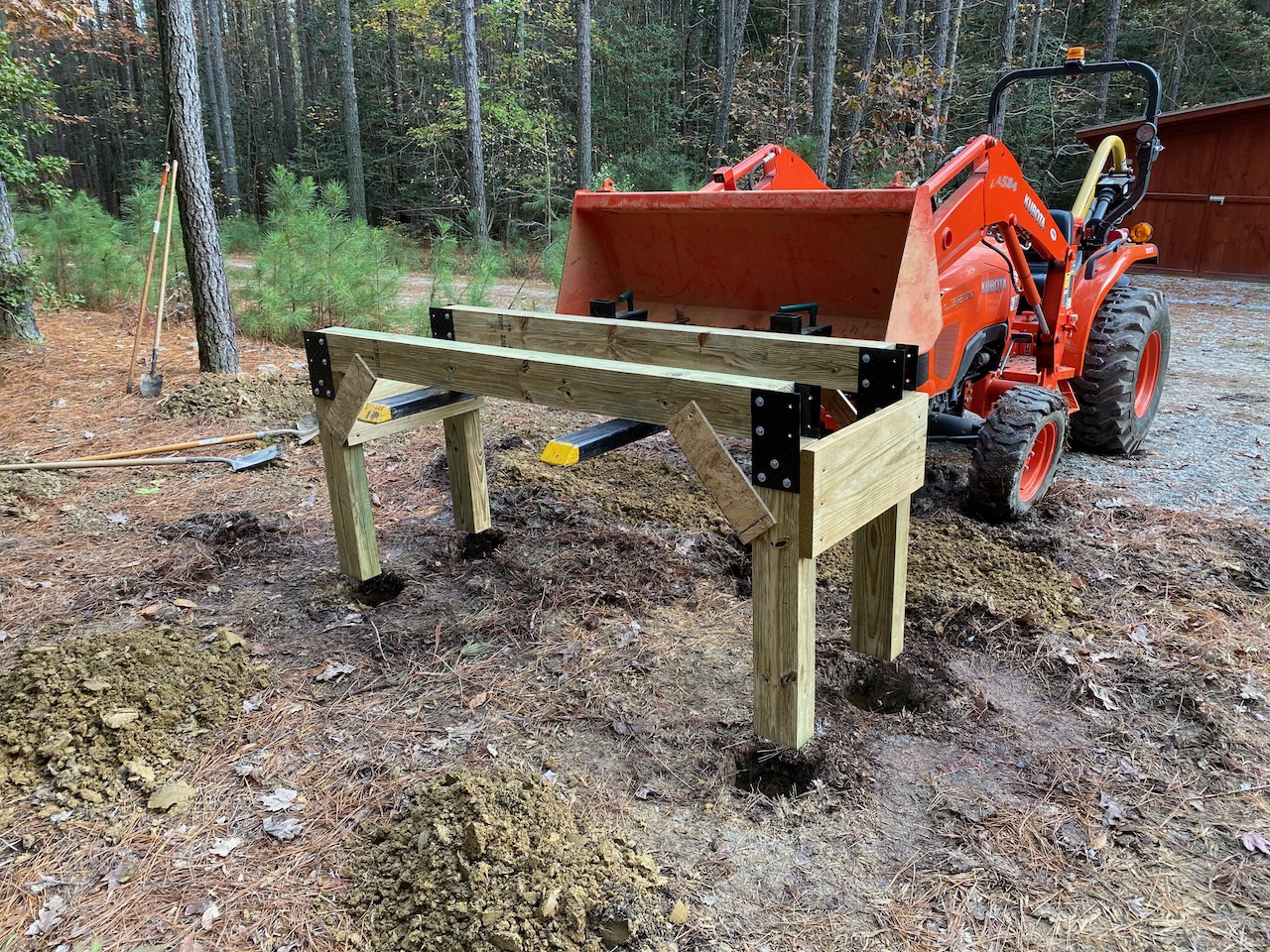

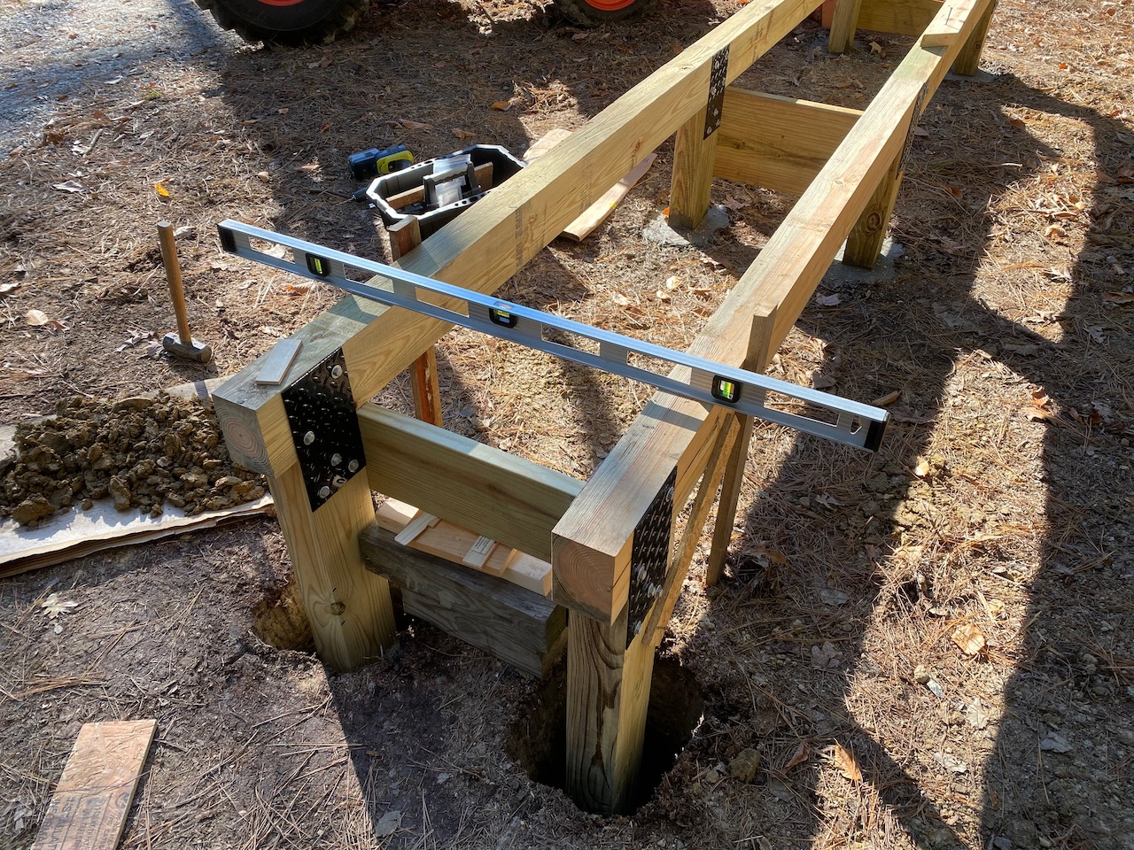

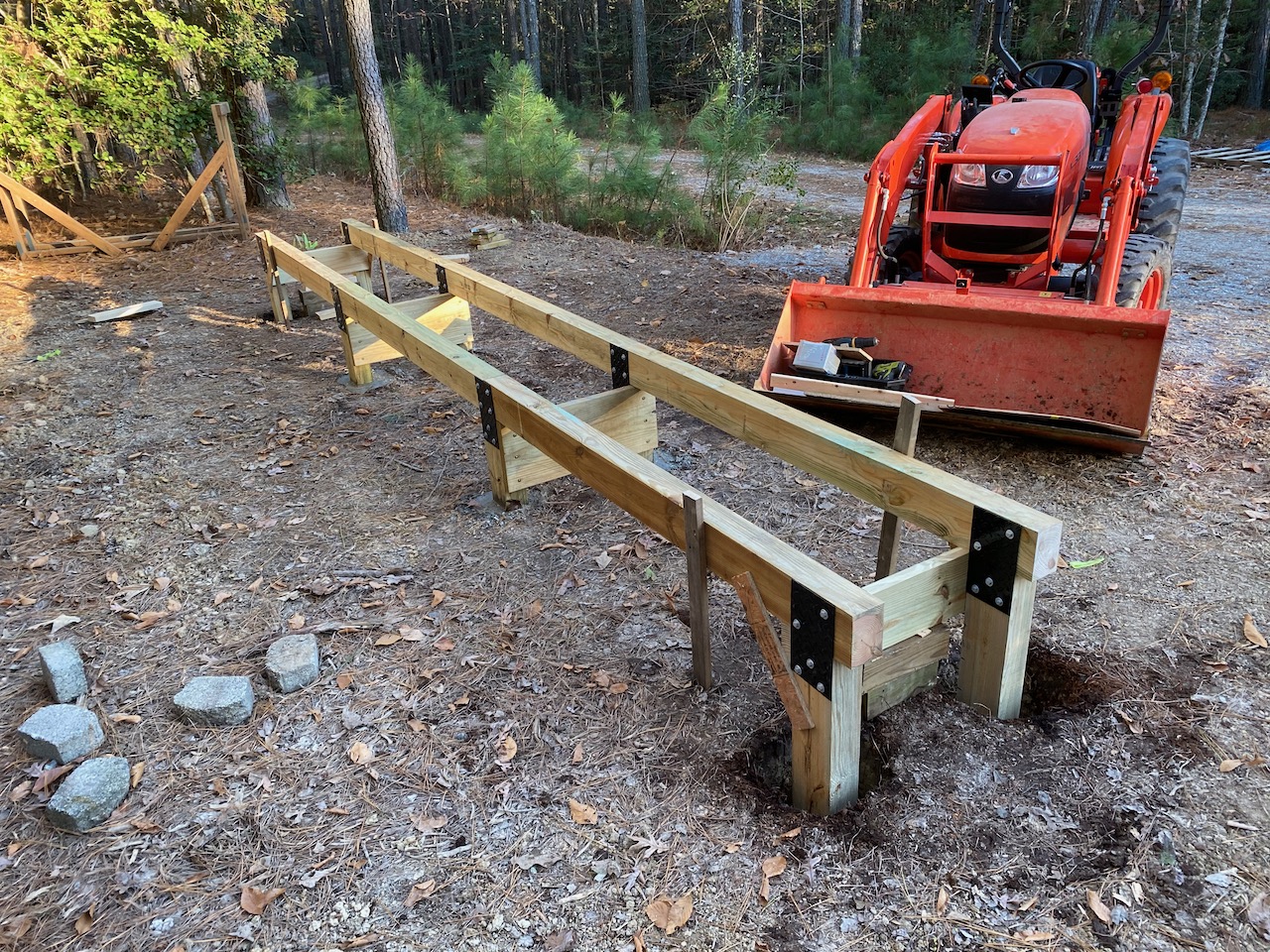

So here is what I came up with for a 26" wide, 20' long base:
All made with 4x6 timbers. I used scraps for the leg posts and just had to buy timbers for the tops. Cross-braces are also scrap lumber. All the gusset plates are scrap diamond plate steel, and it's all held together with galvanized 5/16" lag bolts. So I spent $100 on timbers, $35 on bolts and washers, and the rest I already had. Some people think it's stupid to keep 2-3' scraps of lumber but I always hang on to those pieces and it came in handy here.
I pre-fabbed each of the three sections in my barn on the concrete floor, to get everything nice and square, then carried each section to the site and blocked it up over the post holes to level it prior to pouring concrete around the posts. The posts go down 17-20" (below the frost line of 12").
Takes about 120# of concrete for each post hole. I'll finish pouring the concrete tomorrow, then give it a couple days to cure before I begin assembling the sawmill track on top.
I also drilled 4 post holes to support the roof that will be built over the top. That will be 10' wide and 26' long when done. Other than treated lumber for the posts, all that lumber will be felled and sawn on the fly. I am sure it will be interesting to build a roof frame with green lumber but I am looking forward to the process.
I'd prefer OSB and asphalt shingles on the roof, to match my barn and house, but if the price of OSB is still insane in a couple weeks (as I expect) then I'll just order some metal roof panels. Right now OSB+Asphalt will run me about $1.75 per square foot, and metal will cost $1.00 to 1.10 per square foot.
