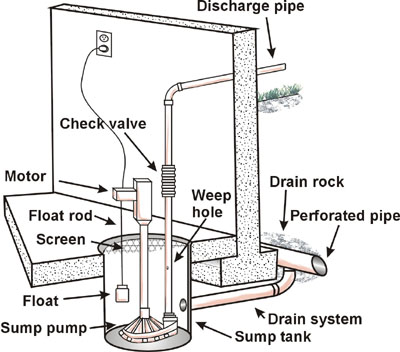

i'm going to build a kitchen in the basement. it will be used as a commercial kitchen initially to prepare fresh pasta. there is no plan to have a commode but a sink is necessary. what is the usual method used to pump the waste water up to the drainage line, which is 7' or so above the floor? how do you vent a drain like that?
/ basement kitchen plumbing #2
You will need what they call a septic sump pump they're not cheap by the way and they are little difficult to get put in I will attach a picture of one for you....... good luck Sump-Pump.jpg

the only thing i'm draining is a sink. don't be misled by commercial kitchen, its just a kitchen that can pass inspection for the production of fresh pasta. there is minimal water use involved. i was thinking of something like this under the sink in a tub. they have containers that are used for sump pumps. that should work for this.
http://www.homedepot.com/catalog/pdfImages/74/744ddebb-7531-4e85-be2f-108aff31484a.pdf
if i set something like this up i don't think i need a vent. the sink drain goes into the container.

We have a sump pump in our basement for a sink and it also pumps out the discharge when our water softener flushes itself. It pumps straight up about 8'. A check valve about 2' above the pump. The pump is one of these:
50 Series | Zoeller Pump Company

You will need what they call a septic sump pump they're not cheap by the way and they are little difficult to get put in I will attach a picture of one for you....... good luckView attachment 302444
Around here they're called ejector pits; but they are similar to the drawing you attached, except...
They aren't tied into the house perimeter drain. They don't discharge to atmosphere. They consist of a pit, the drain enters the pit below the floor, the discharge with check valve exits up to a sanitary-sewer drain, an atmospheric vent pipe (either separate or tied into the existing system) services the pit, a grinder/macerator pump with a float switch takes care of moving the glop in the pit.

Regardless of whether or not you intend to dump any food scraps down the drain; I'd bet code will require a grinder/macerator pump.

Do NOT...........DO NOT! forget your check valve!!!!!!!!!
Your upstairs waste lines MUST be separated from your new lower waste lines by a check valve...........3" check........ask for it at your plumbing supply.
If your upstairs backs up.......the first place it will go is your basement.....trust me......I know.
I hate to admit it; but I was a bad boy and removed the check valve from the 2" discharge line because it made such a loud banging noise when the ejector pit pump shut off. The design of the valve is such that it doesn't open to full port size. Maybe I should look into a larger check valve that will open completely.
