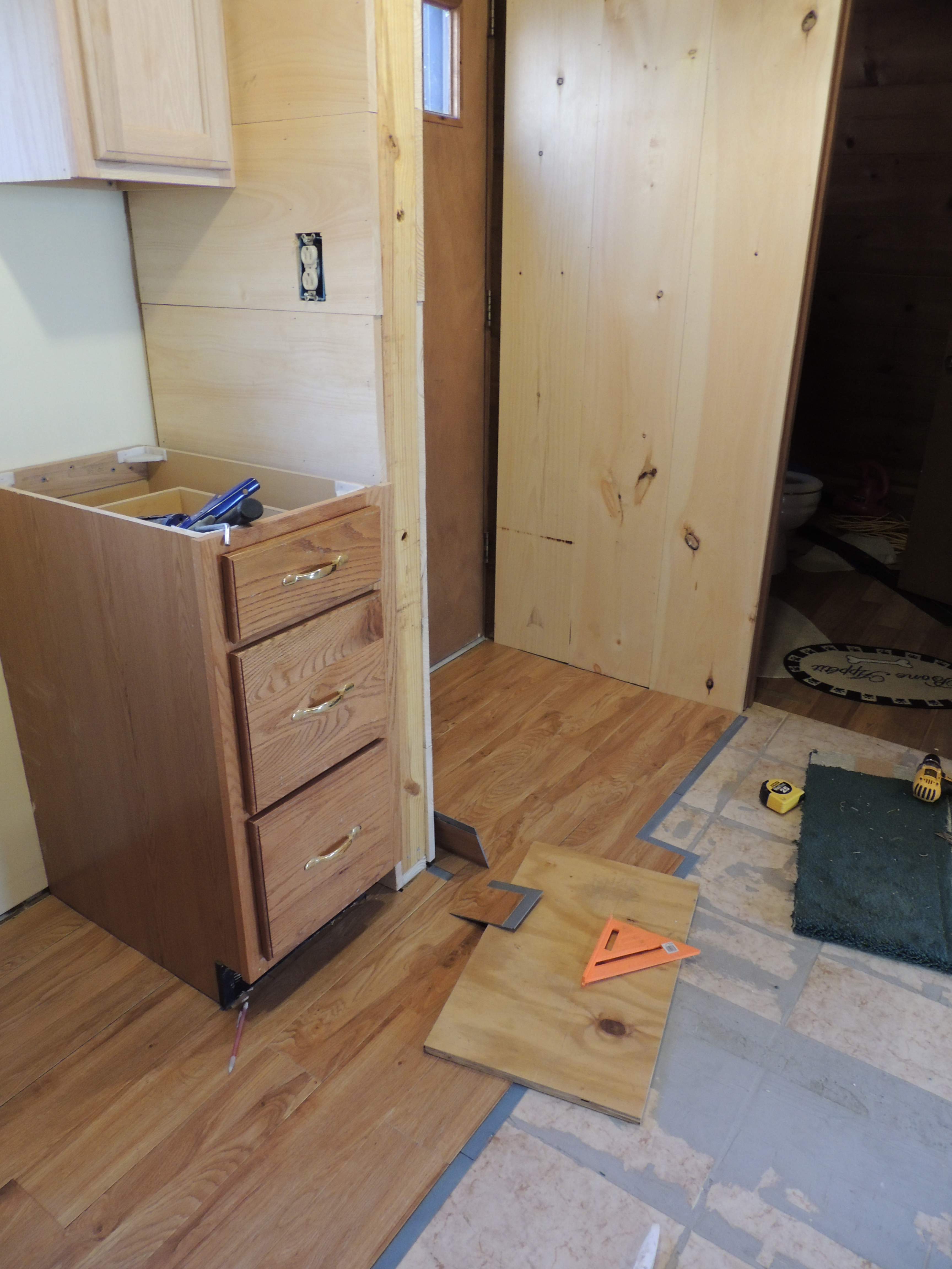

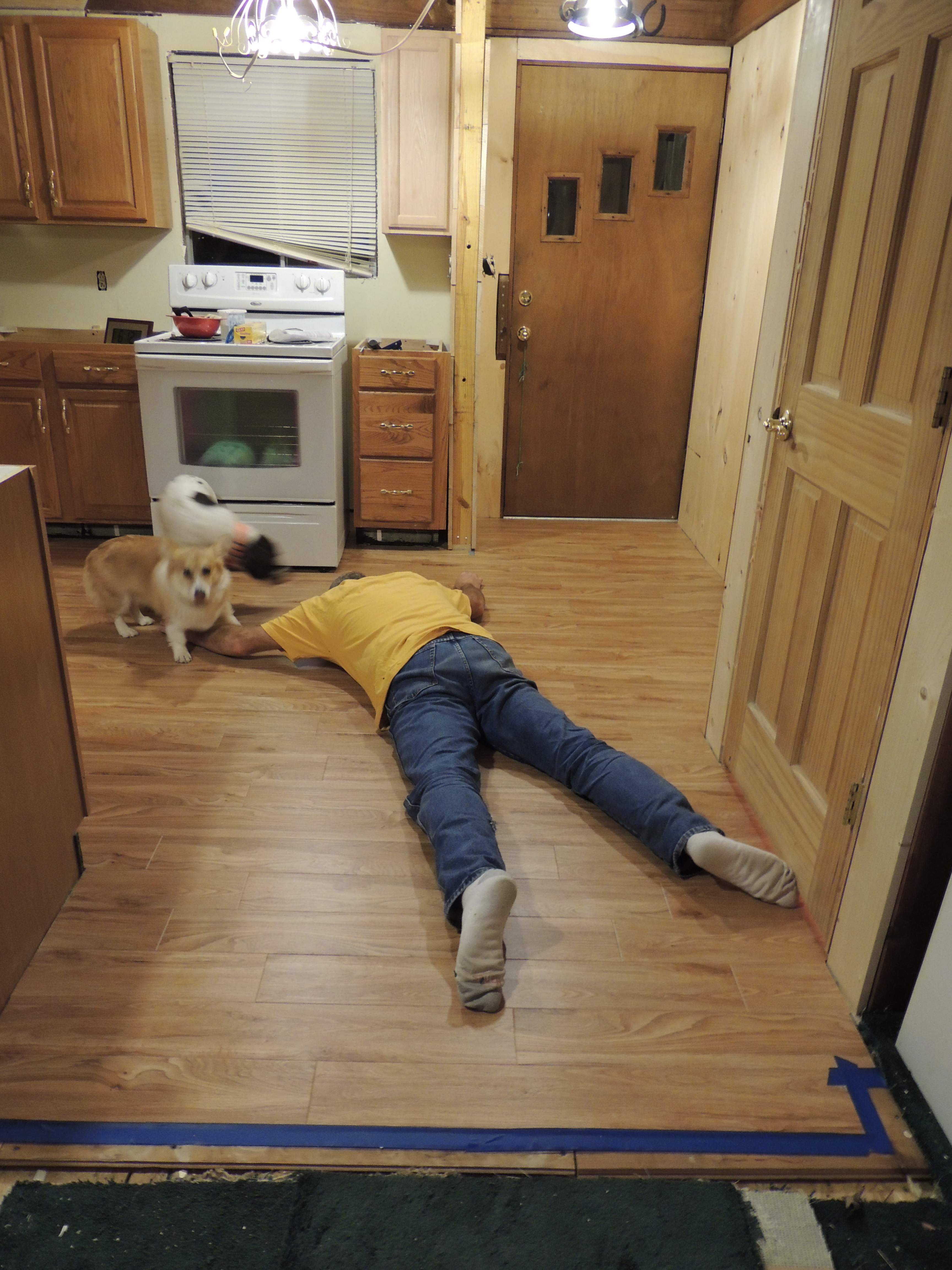

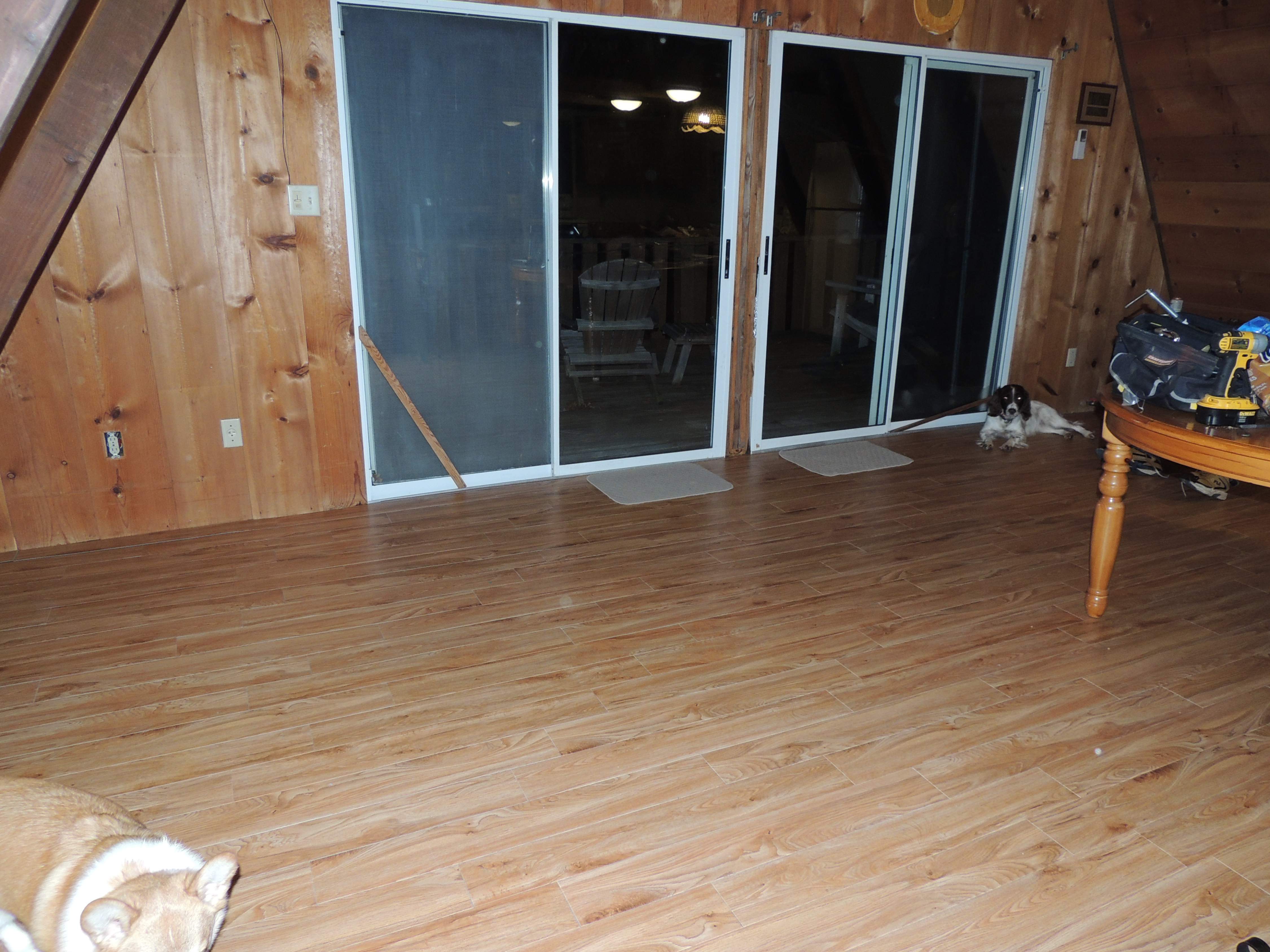

Another vote for the Allure... installed in our TN cabin last winter and it has held up great. We have two dogs one a very energetic corgi who tears through the place sliding around the corners.
I did this directly over a tile floor...filled the grout lines with leveler even though it said it didnt need it
Install tip have heat gun avail to heat any loose sticky glue strips then put weight on them as Eddie Walker suggested.

Was that you drunk or exhausted? :D
   / Basement upgrades...Allure vinyl flooring is my new best friend: #27
old and tired
