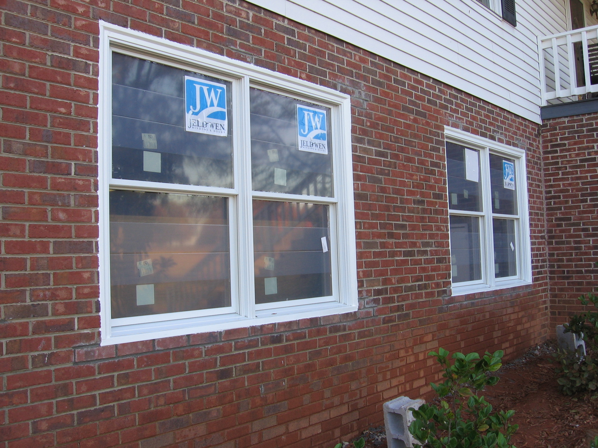

Just a note that up north here, bedrooms don't meet code unless they have two means of egress - two doors or a door and a window you can get out of.

All the outlet circuits are 20 amp sorry if I wasn't clear about that.
Do these windows work? ;) Each room has one.

Just curious - Is your basement mostly out of the ground or do you have huge retaining walls? Those don't look like the usual "basement windows".
/ Basement Wiring?
We are on a hill one side of the basement is fully in the ground with no windows (bath room is on that side) and the other side you walk out with no stairs.

Check codes on egress windows, if you are concerned. There are a couple simple requirements on sill height and clear window opening sizes. Many sources on the web show the specs. Search "egress window" and you will find it, easy peasy.
