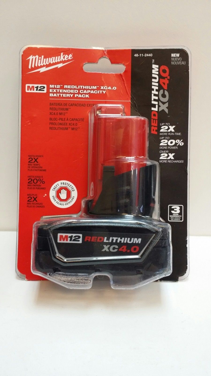

Here is my question to a Ebay seller for the M12 2440 battery.
I asked, can you certify that your 4.0 amp battery can operate for 4 hrs with a 1 amp discharge rate.
His answer.
1A would discharge about 3.5 Hour
Because the Milwaukee original charger will not fully charge the battery in order to extend battery life. The milwaukee charger will charge to 4.1V then stop, so battery will not fully discharge for 4 hours.
Some answer. Any one understand what he said.
One of the re-builders posted this.
The 2440 are rebuilt at 4.0 Ah and the 2402 at 3.0 Ah.
Thanks,
