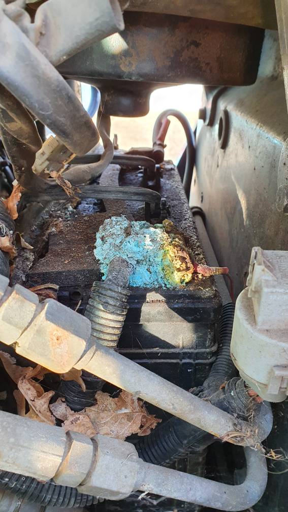

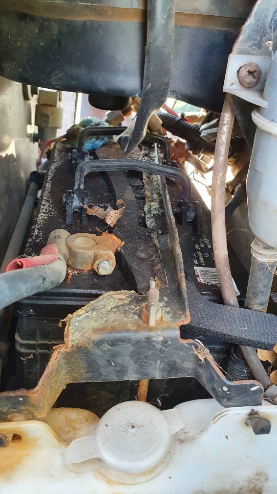

Ide say this needs looking at .
Always more stuff todo.
Someone else will sort it.
I'm embarrassed to share this photo and hope it will give me the kick up the *** to sort it.

A good cleaning and add something like the NOCO NCP2 MC303 Oil-Based Battery Terminal Protectors and you should be good to go. Don't have to use this brand but I do like the protection the NOCO offers. I bought the 50 count container of these and added to all my vehicles - been a few years and no issues. Have plenty left - if you won't across the pond - I'd give you two for your tractor. Will be installing on my MFGC soon when I get the tender lead and do it all at the same time.
   / Battery terminal corrosion #4
That is caused by a leaking battery. Just replace the battery and cables and move on.
   / Battery terminal corrosion #5
Usually leaking fumes, corroding any bare metal in the area. Fixing the cause is as important as fixing the symptoms. A poorly, partially charged battery has been the cause when mine looked like this. Clean all cables to insure a proper battery charge, and use a maintainer to keep it topped off and healthy. A new battery might be needed too.

Clean battery cables and terminals with baking soda to neutralize acids and polish contact surfaces with scotch bright pads and/or small stainless wire brush and coat all exposed metal surfaces of cable and terminal with corrosive preventive grease....Ever take clamp bolts out and clean threads and coat thoroughly...
I use this on all my connections after extensive cleaning and do not have corrosion issues...Have been know to do brand new vehicles when brought home from dealer and 8 years later when replacing battery, NO COROSION....

Thanks all for ya comments and help. So far battery had a wash off and washed the rest of tractor more thoroughly to check for any other **** that needs fixing
