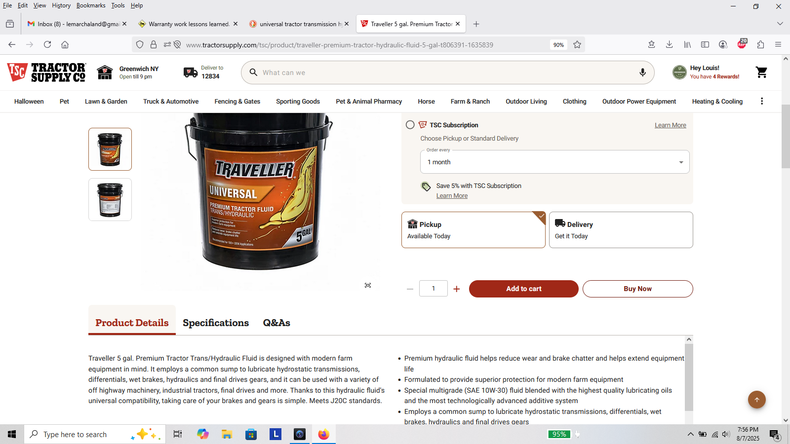

I was also confused by that bogus spec, so talked to the shop manager at RK. The guy they had then was ignorant as a bucket of rocks. Caught the lead mechanic and asked him. He said the manual was wrong and do NOT put AW32 hyd fluid or gear oil in it! And that they used the RK Providence store brand of "Premium Trans-Hydraulic Oil, Multi-Trac Formula for Use In Most Applications" that meets the John Deere J20C spec.
