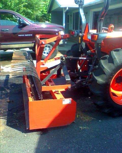

   / BB How much weight to add #3
This is what I use.:D
