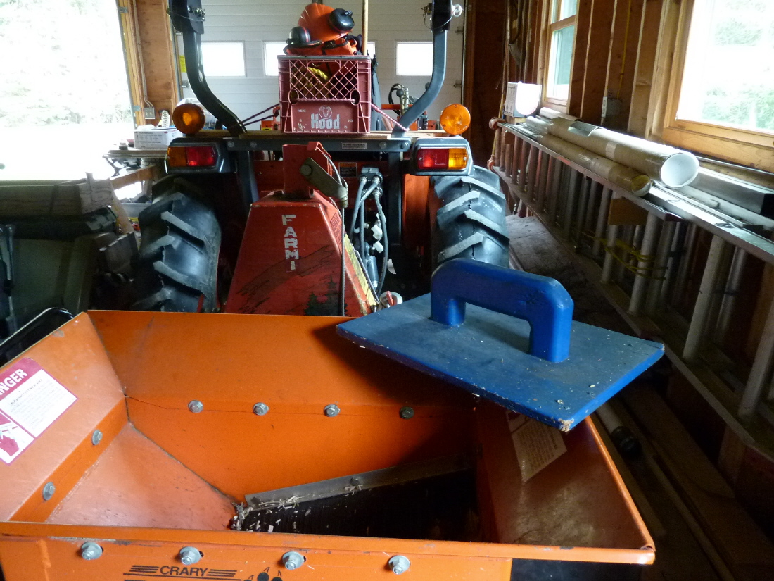

The man I bought my chipper from had made a paddle with a handle on it for use with the shredder. It works real good for pushing in loose stuff like leaves and garden debris. I also tried a broom but it disappeared in a hurry the first time I got it in to far :D

I'd want a longer handle on that paddle!!
Woods sells a similar item...I'd guess Bearcat does too. I've never seen them, but I'd guess they have more of a broom type handle then what's shown in the picture.
If anyone decides to make a pusher, use dowels and glue to assemble. No nails, screws or or metallic fasteners...

The pusher for leaves etc looks like a good idea, built w/o metal works too!
