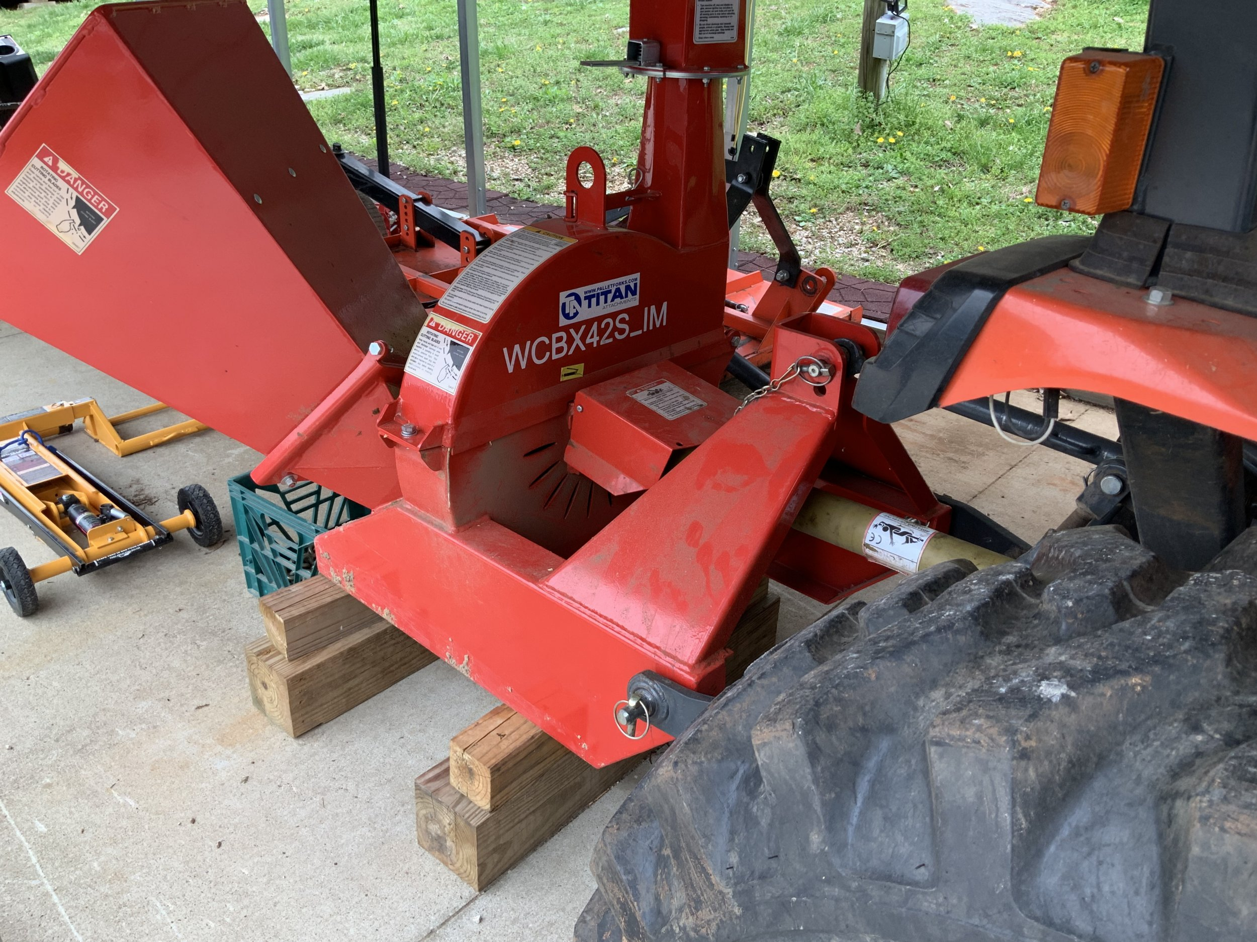

This is what you need and that your tractor can handle. My tractor has 25hp at the PTO and after using this a lot for the last 12 months I wouldn’t put anything larger on my tractor. It will eat 4 inch pine and cedar all day long and 2 to 3 inch hardwoods. It doesn’t have a power feed and I’ve never needed one, (and I don’t have hydro at the PTO anyway) It does self feed but the blades pull the material in. I paid $1800 for it one year ago but like everything I’m sure they’ve gone up.
