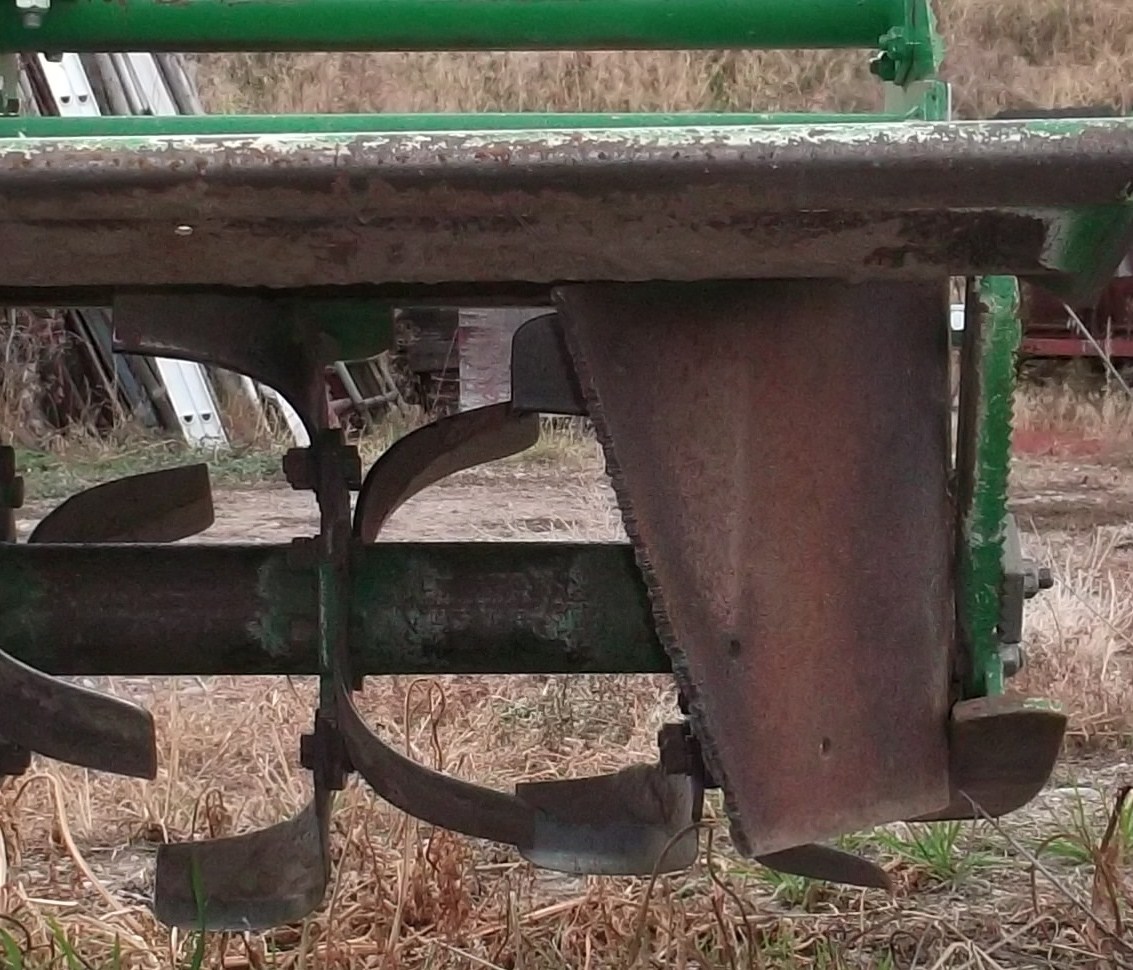

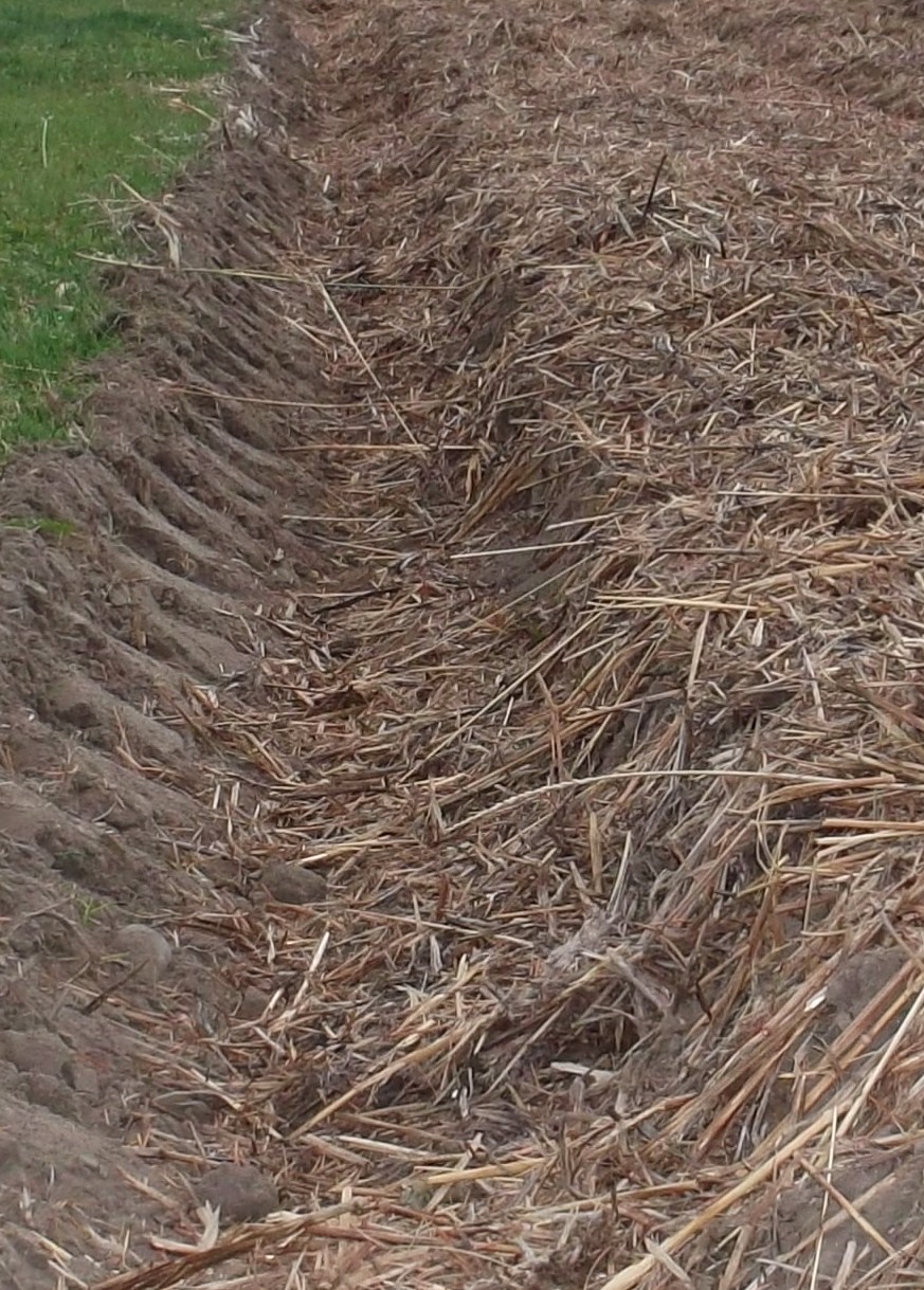

Here is an addition, to my first post, on my hiller fabrication attachment to my tiller...
The wing shows how I narrowed the width of the raised bed to accomodate the tractor to drive down the bed again.
The raised bed... It has garlic planted in it and I chopped some straw to cover for the winter..
one of these days I will post how I built my "straw chopper" when I get the bugs worked out....
