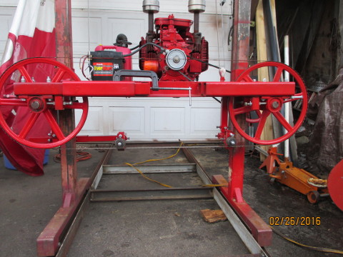

Wanting to use the mill this spring. Have a look. I think I've got the picture up.
18 hp Kohler engine, manual drive at this time.

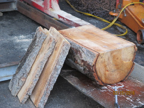

It seems to track and cut well, haven't tried it on a log yet, they're under the snow still. Need to install a belt tensioner, haven't got that together yet.

Just looking at the pic it looks like you have the blade speed too fast.

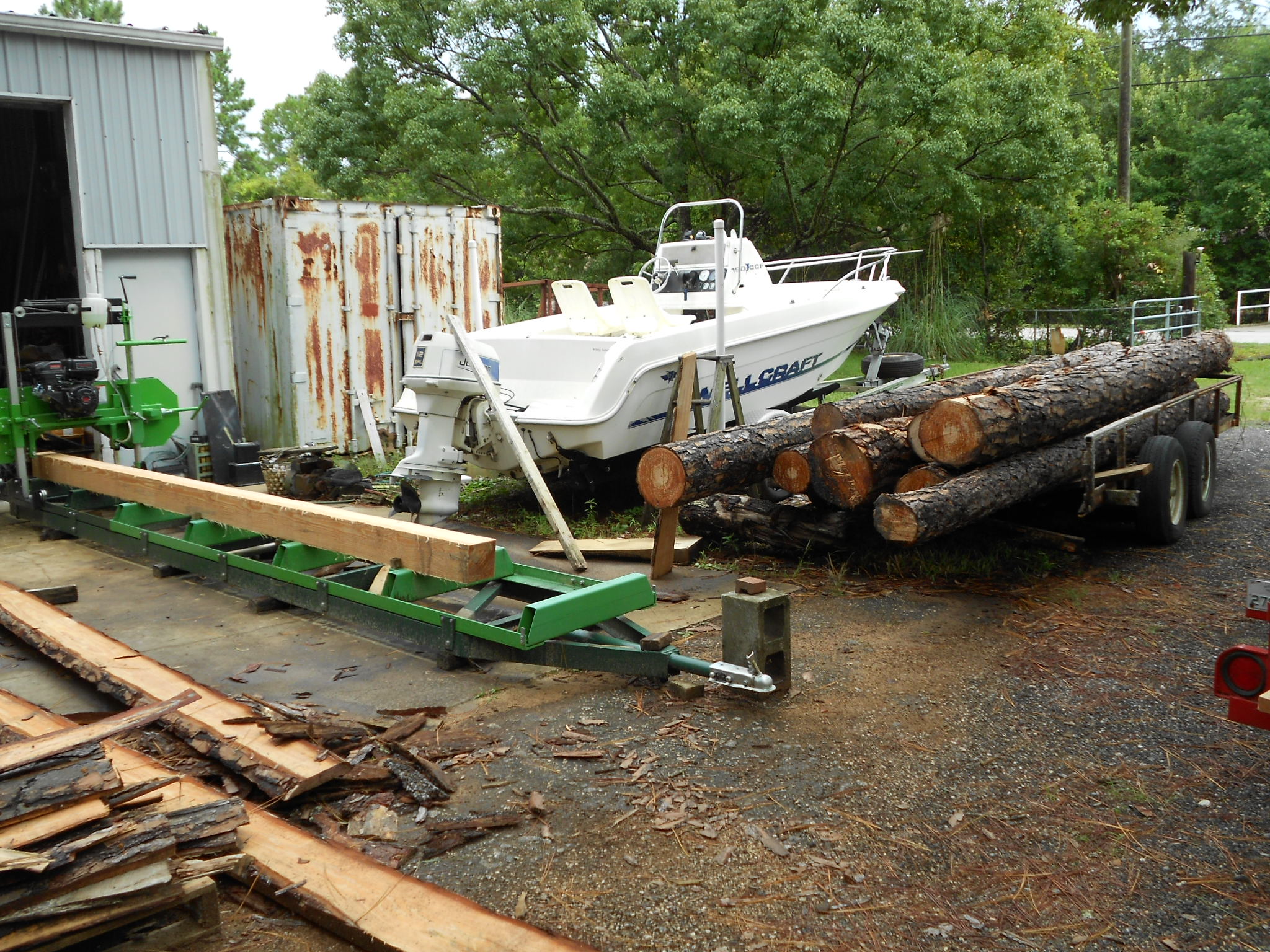

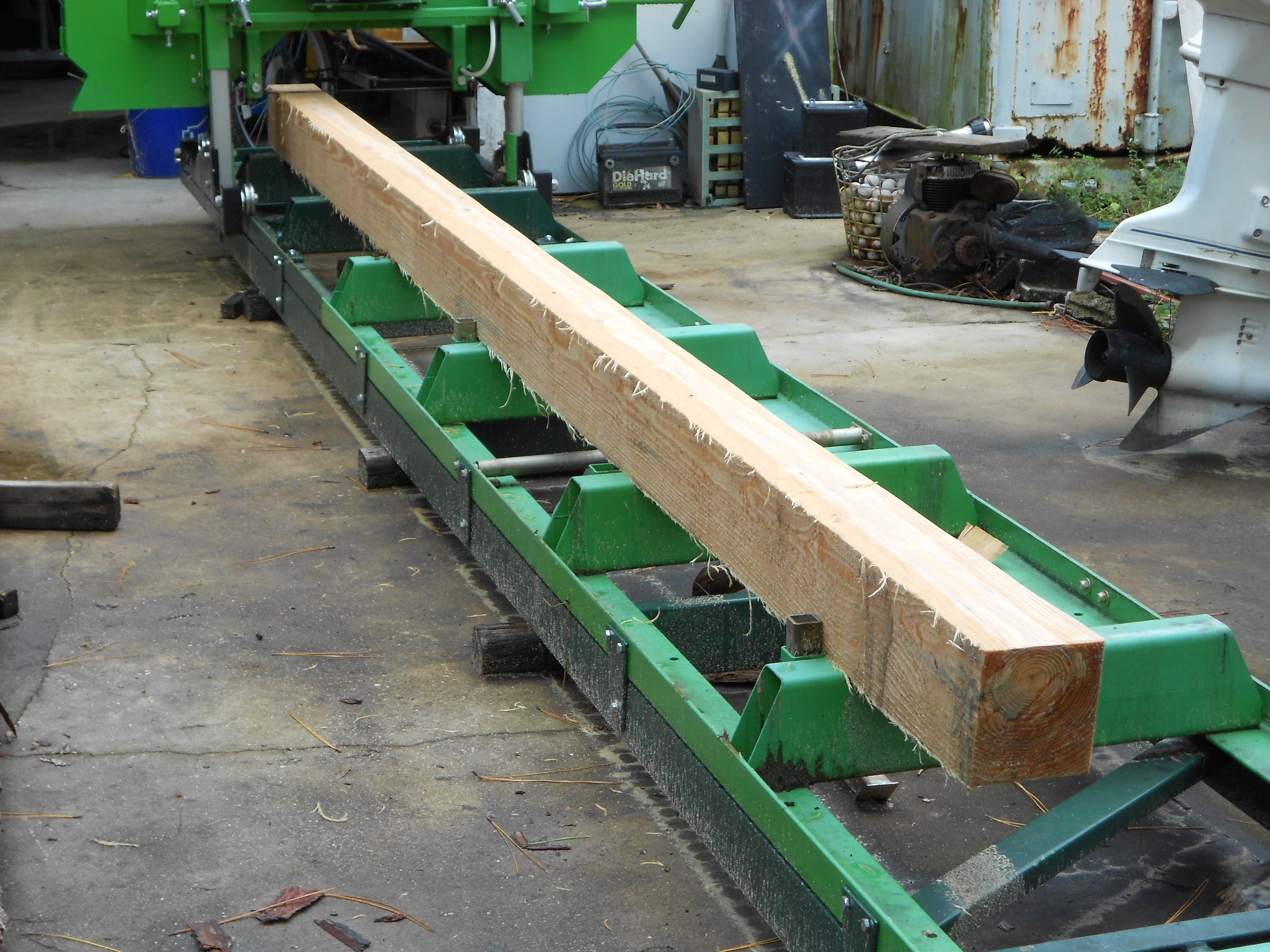

I bought a HF Mill 2 years ago and it runs the belt from the clutch to the drive pulley and the blade rides on the belt on the pulley.
Also not having guards on the blade is asking for serious trouble!
Even with guards a broken blade goes NUTS!!
Pic is my HF Mill with fabricated extra bed length so I can cut 16' boards.

building the guards now, but couldn't wait. I figured the speed out before ordering the pulleys. Not finished with the track.

Stimw,What is the distance between the center of the carriage wheels where they ride on the track. Or the distance between the two upright angle iron uprights of the track?
Thanks
Richard

Stimw how do you like your HF mill ?
I love it! I own a fabrication shop and could not build one for the money I paid including labor.
When I bought mine they were on sale and they still took the 25% off coupon (they don't take coupon for it now). It was about $1700. including delivery!
It does a great job and the few problems that I have had seem to be standard Band Mill problems, like dull blade cutting crooked.
Where do you get logs in Florida, don't remember seeing many trees there, maybe I just forgot.
Rustyiron, Nice machine!
We have plenty of trees!!
The pine logs in the pic on the trailer were given to me by a friend who was clearing a lot in my neighborhood.

Rob, Is that a manual mill? Just looked one on line. I need to put handles on mine for a place to push from.
I'm putting together the blade guards now, in between storms. So you haven't broken a blade yet, that's encouraging, I'm hoping not to, because they're costly and it could be dangerous.
