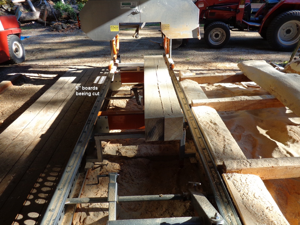

Greetings, I used square tubing I had, just bought some that it would slide into. I tacked them a bit too close to the guide, not sure if I should grind them off and move them over or use a 1 by to space the log or CANT.
I like the way your stops and dogs are made, just swing up and down.

I think you may be happy if you move the log posts in just far enough to clear the band wheel for sawing higher cants. The stationary posts are will be more stable and accurate than ones that swing.

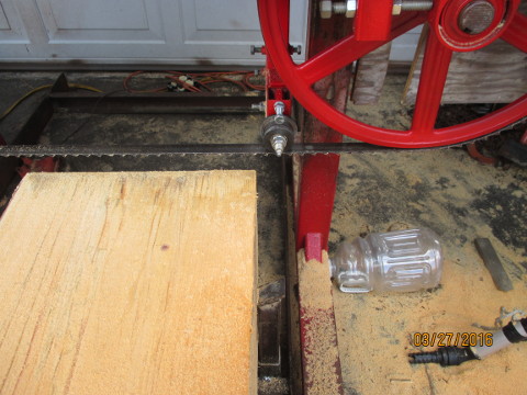

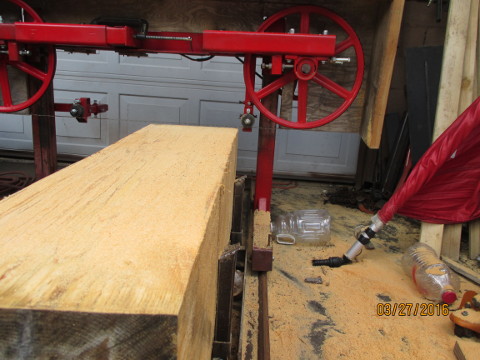

Valley this would be a useful mode to your mill could save you from sawing off a log post. Look in the pic. the 90 degree bent rod that sits in front of the blade guide roller. Sits just ahead of the blade and will stop the saw before you run into a post if you forget to lower it.

Billrog, I like that, in the picture above, I'll try to do something like that. Just looked at the dogs in your photo, that's what I'm thinking, may use round stock so the gard will be pushed down or stop the carriage.
Is the cross rod on your mill, the ones the dogs slide on solid or like 3/4" plumbing pipe?
