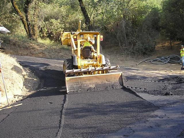

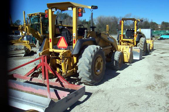

Hey Steve. The asphalt float has sides that resemble an LP but have one adjustable shaving and cutting blade and a "thick steel "smoocher" at the back to smooth out material. The angle of the smoocher acts like a heavy blade when you drive in reverse. An LP with the blades mounted level or above the skids may work ok, but you sure wouldn't want material floating over the blades. A BB works well for asphalt, WITHOUT a floating tailgate. Coating the attachment and bucket with a liberal amount of diesel goes a long way towards keeping the asphalt from sticking. You have to make sure that you get the AC laid right on the first pass. Backing over it to make repairs makes a mess.
Here's a couple photos I've saved (from who knows where) of the asphalt float and a photo of a Gannon spreading AC. The middle photo is an earlier design. Someone here on TBN had some good photos of the float being used by their driveway contractor in Northern Ca, but I can't find them.
