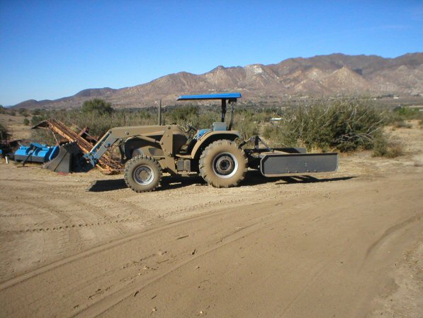

Lots of variables. My 75hp 12,000lb 4x4 tractor can be easily stopped with my 7 foot wide 1400lb land plane grader blade. If the ground is right and I just drop it to the ground with the position control all the way forward as so many say that they do, my tractor isn't going to go very far. Just like any implement, once you learn the adjustments that need to be done, it has amazing capabilities.
Someone asked if they can be used for other stuff than roads. and as Steve said, yes. And with mine if the ground is damp, I can move over 2 cubic yards of dirt at a time and when you are leveling out a large area, that sure does work well and a lot faster than any of my other implements. A lot has to do with the conditions that you have at that current time.
