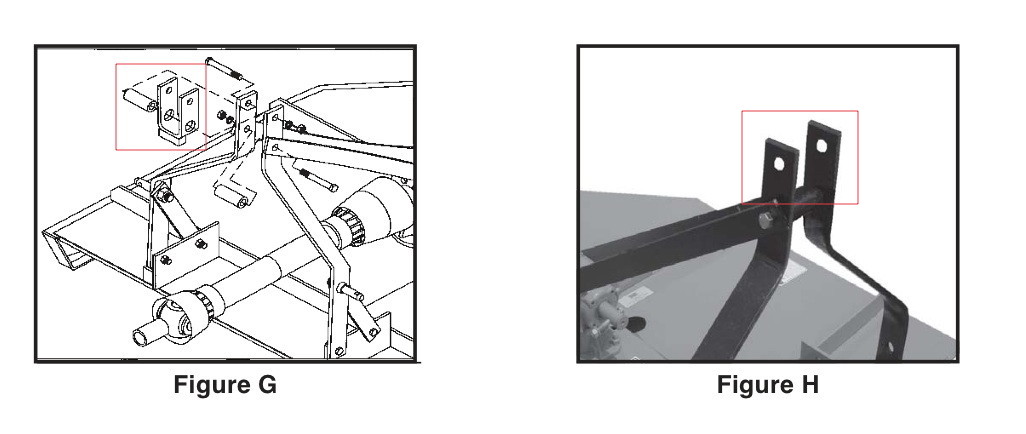

Ok my guess, the top link is too short. (along with what is said about the swing chains above) The top link of the 3 pt should be loose and not holding the mower when in use. The top link should tighten only when raising the mower off the ground otherwise any dips will bend the support brackets on the mower. That is what happened to me.
   / Bending lift arms on brush hog #16
Are you hitched to the swinging link (in the red square, figure G), or are you hitched to the top of the frame (red square, figure H)?
There needs to be some kind of link system that allows the rear of the mower to go up and down without moving the hitch.
Bruce
Photo from the manual at:
http://www.northerntool.com/images/downloads/manuals/256045.pdf
