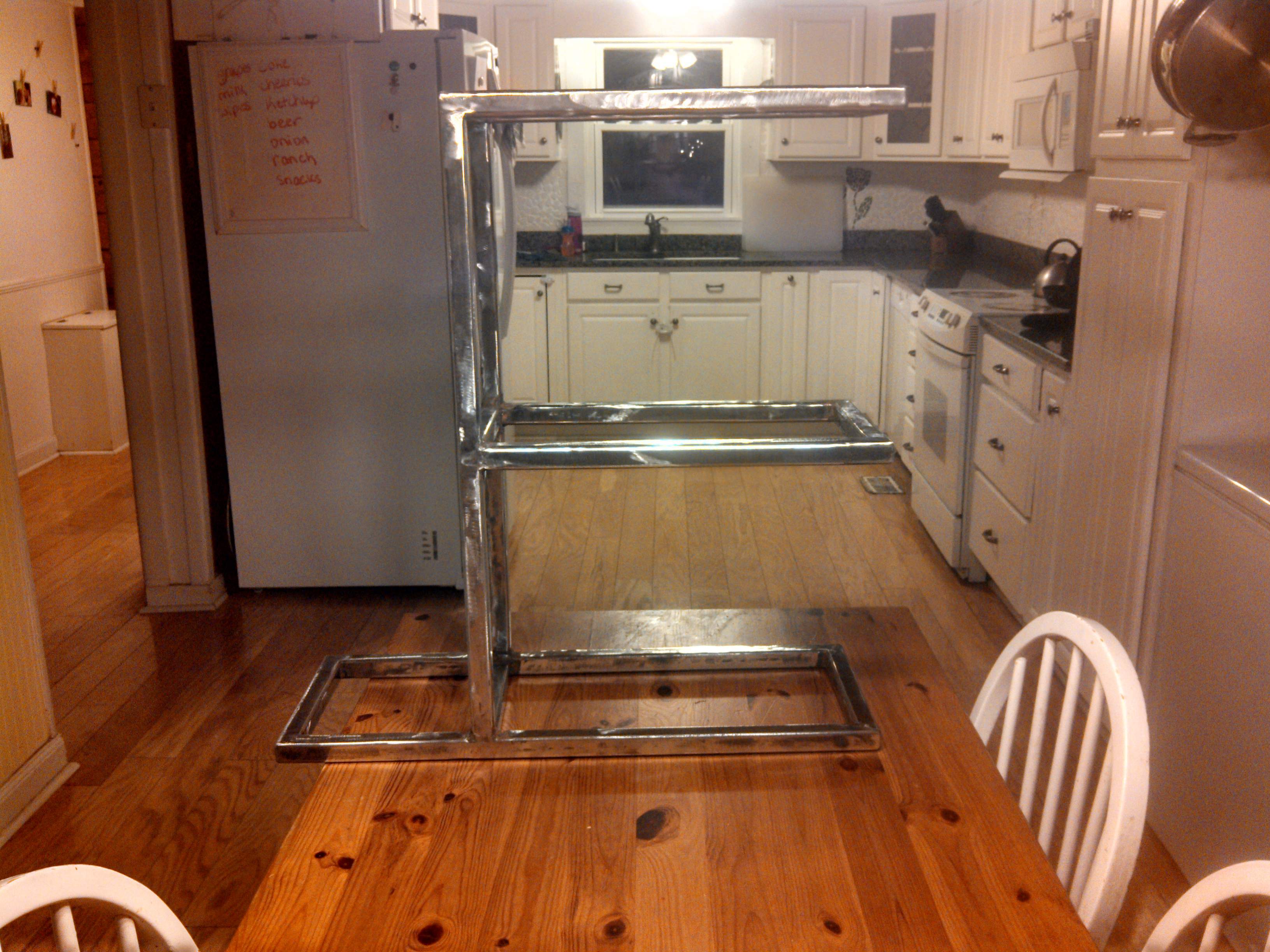

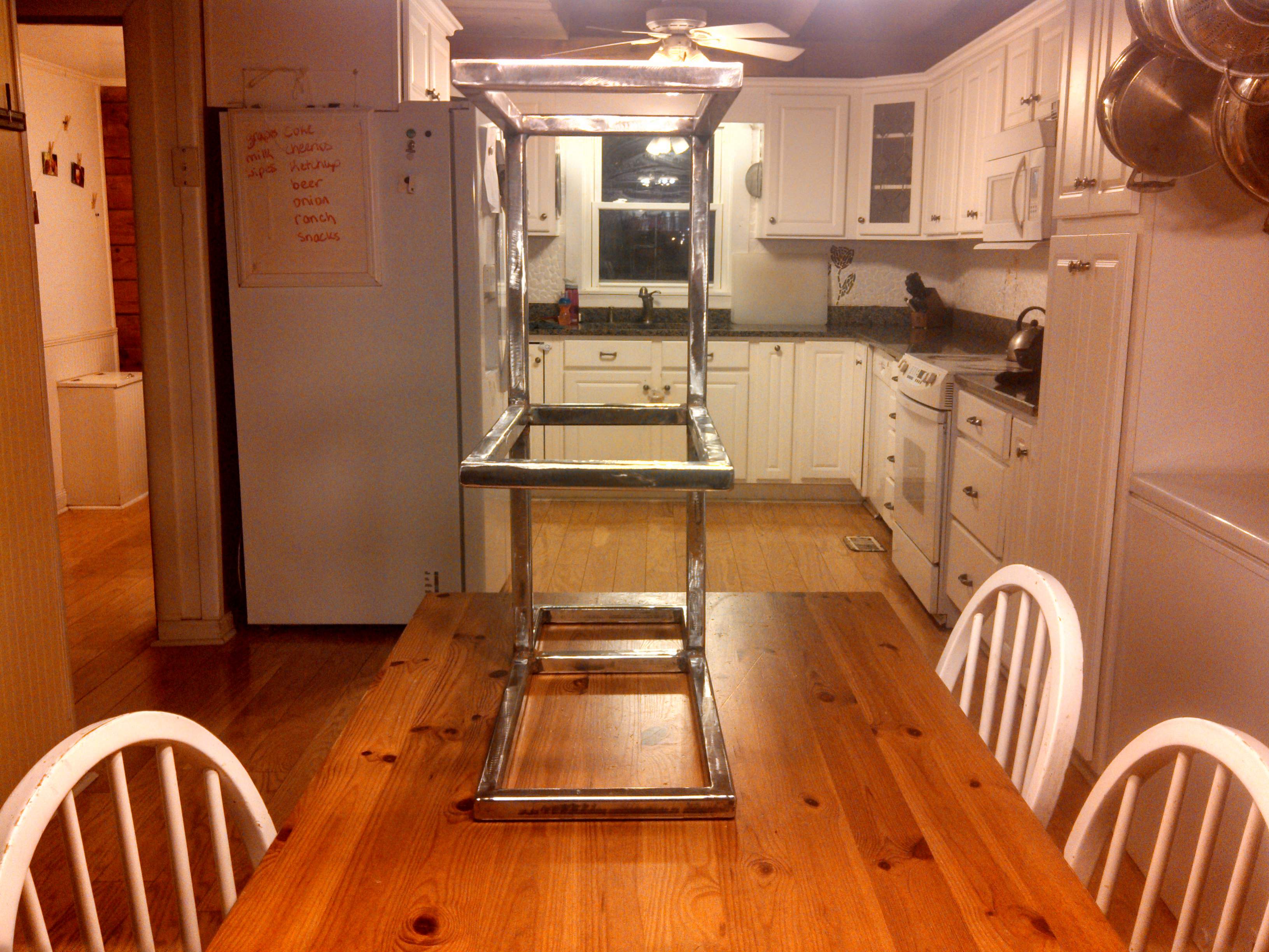

I've got a small update for y'all. I was on a family vacation all last week, so I didn't get any work done. Now that I'm back, I finally got to work on the cart some more. One lesson I'll take from this project: when trying to heat-bend using welds, don't spray the thing down with water to speed up the process, or the entire thing will turn to rust. Sheesh. What a mess. After, literally, over an hour with the grinder and a flap disk, it's clean again.
I don't know why it looks like the lower shelf is so much shorter than the upper shelves. They're not 100% perfect, but it's not that far out if I measure with a straight-edge.
The middle shelf was the biggest challenge. The right-hand side was lower than the left-hand side (looking at it from the front) even though the two sides were exactly the same height at the back. By putting beads on the top of the right-side and front sections of tubing, I was able to pull the corner within about 1/8" of true.
By any real standards, this is pretty amateurish work, but if you knew how many hours I've put into this just to get it to this point... well, you'd think I'm an amateur. Which I am! :confused3:
PS: My house is clean because we have company coming over tomorrow. That's the only reason y'all get the kitchen instead of the basement. Enjoy!
