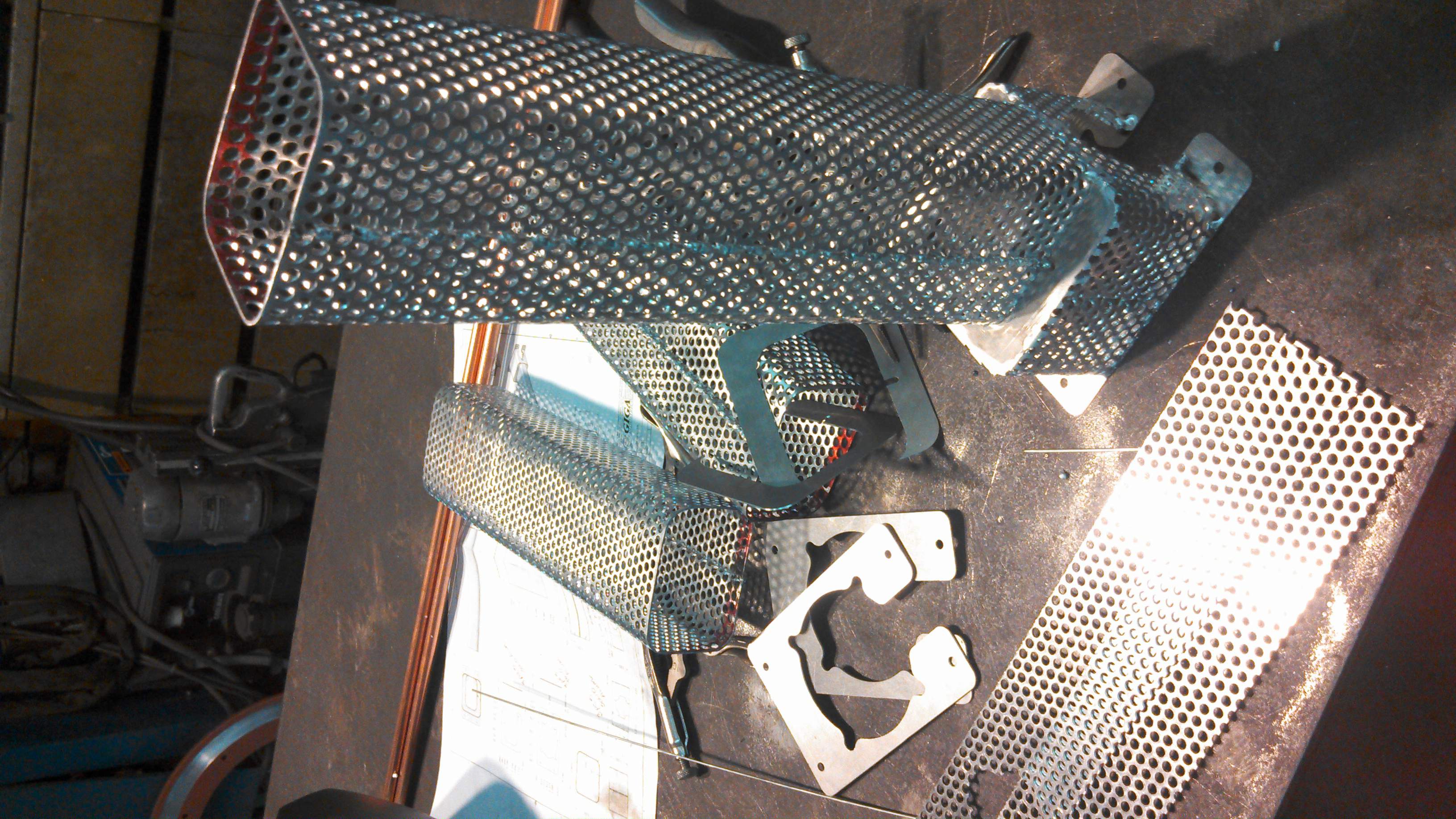

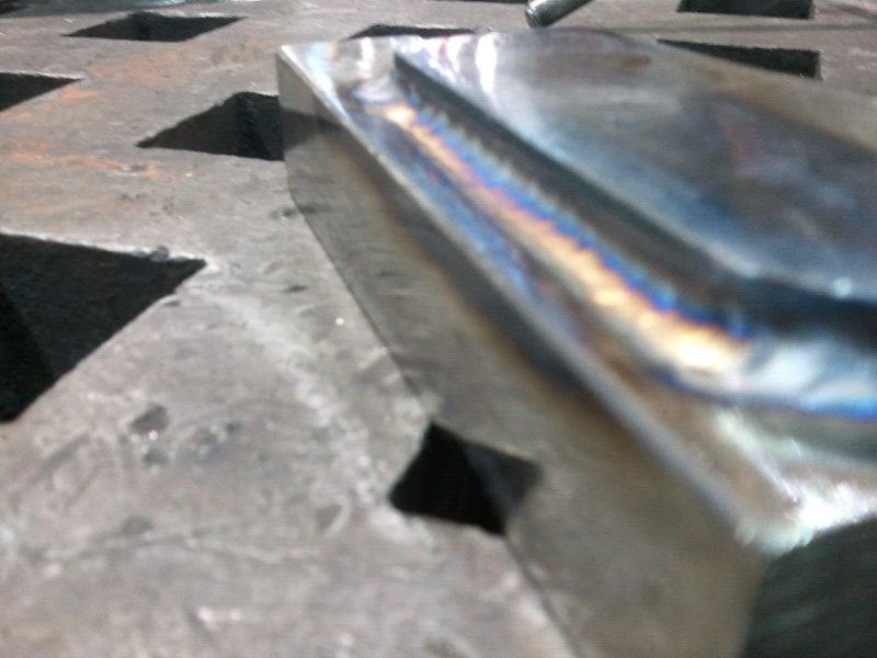

Like these .040" thick aluminum parts welded with a TIG and not warped. Couldn't be done with a MIG as you just don't have the heat control.
A TIG allows more precise heat control but if you don't use it correctly it will eventually do the same thing to a part that you could do with a rosebud on your torch.

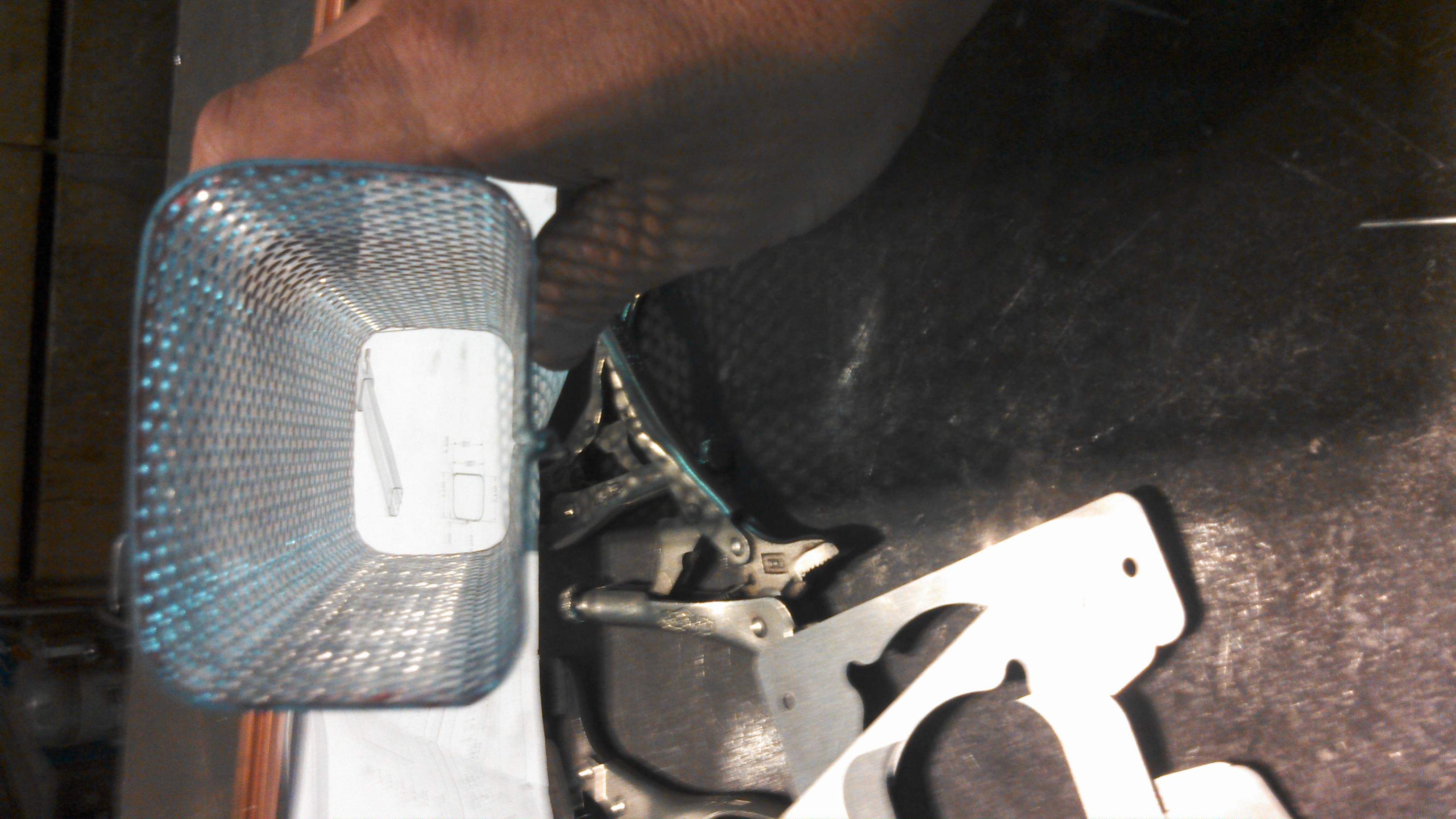

Josh, just try to bump up your travel speed. It will come with practice. Sometimes to keep warpage down I will travel as fast as I can without pausing at all in between dips. This was a jig I built and it had to be 100% true, so no warpage. These passes were about 8" long and I welded them out in about six seconds each.
