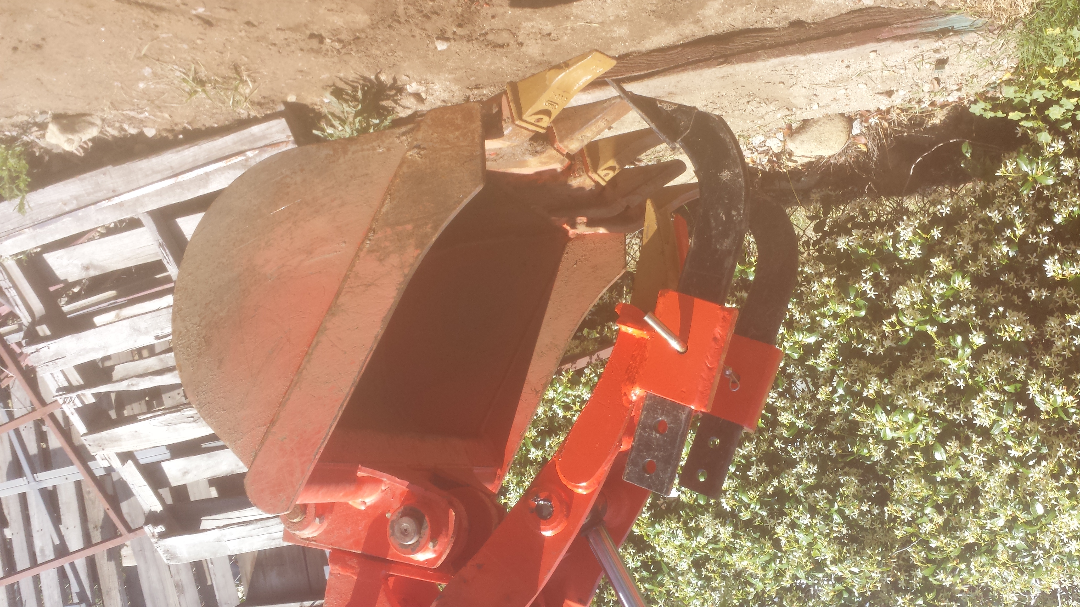

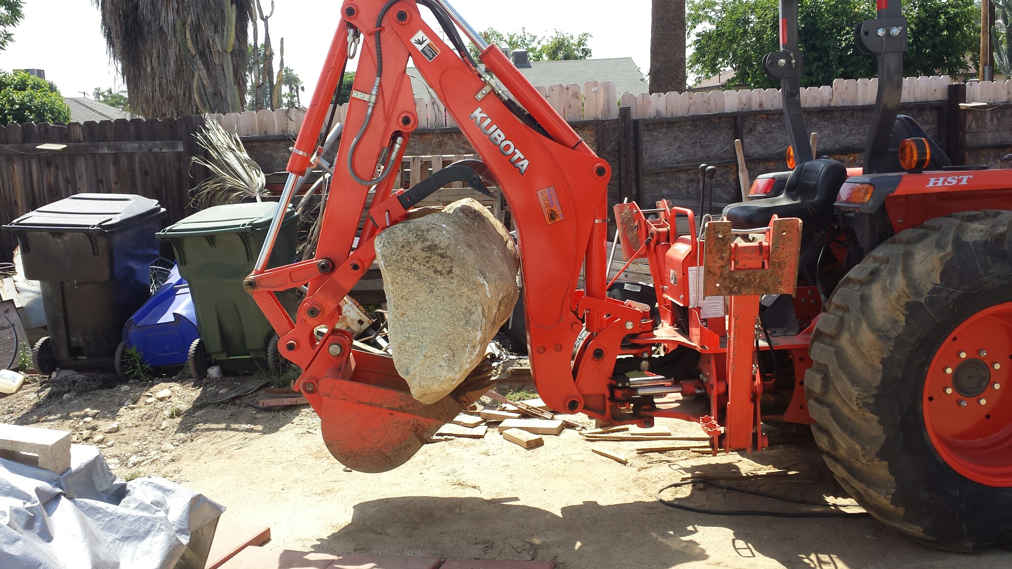

Backhoe with an Hydraulic Thumb worked GREAT for me20190616_145053.jpeg20190525_112816.jpg
I dug out some big rocks digging a new Leach field for my home.
