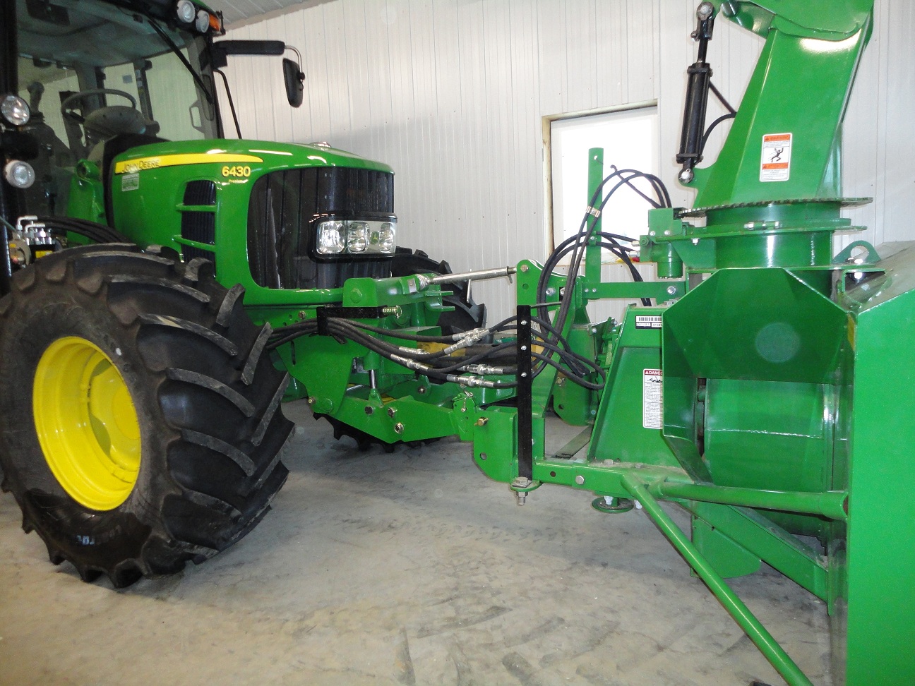

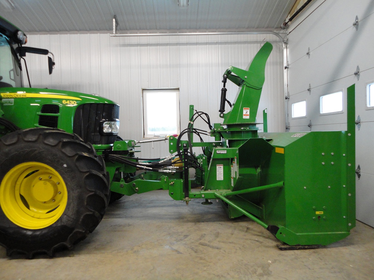

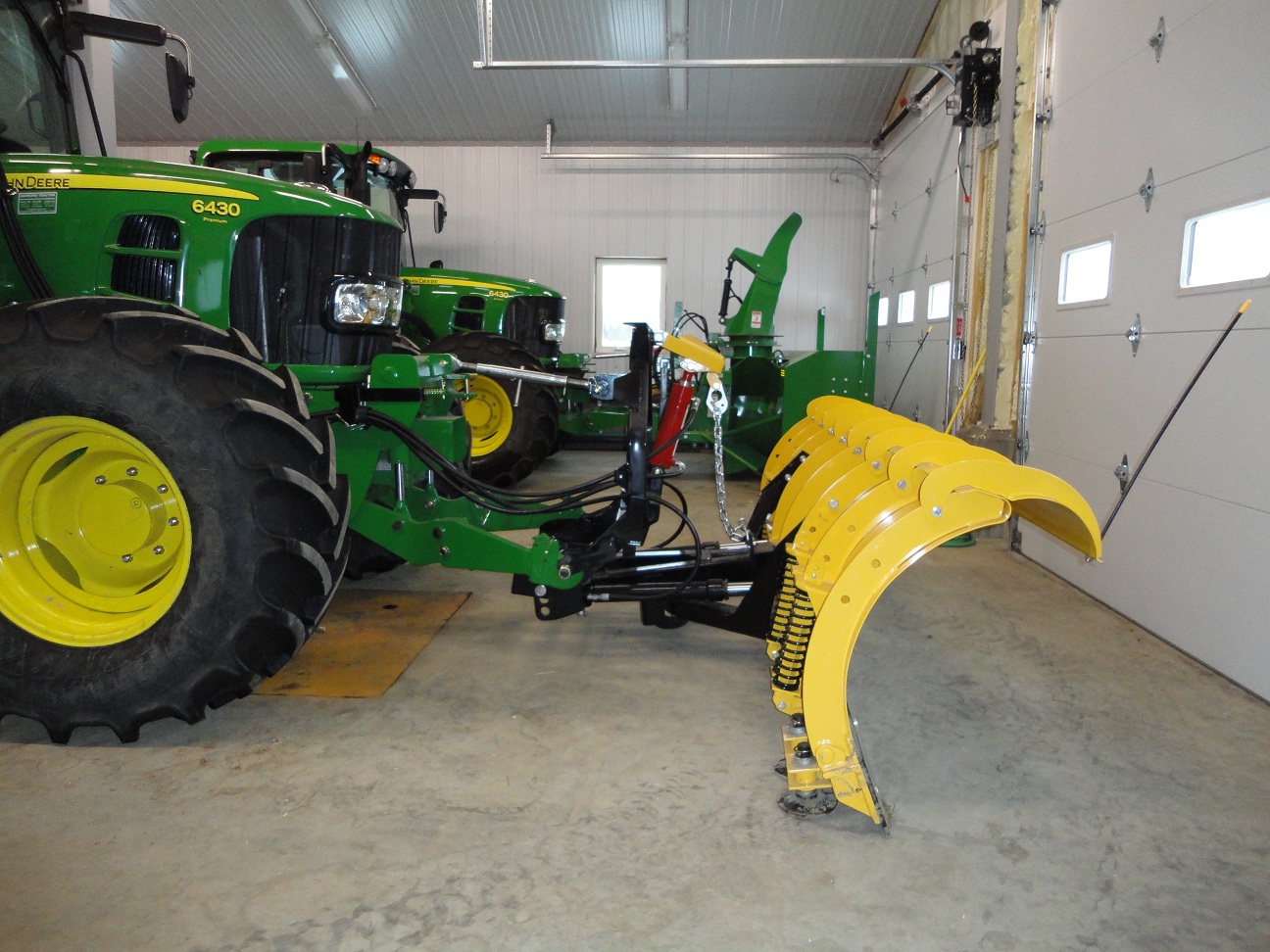

My two setups, old but one of the few pictures I have.
:drool:
need.....more....pics :D
Tell more about the blower? Is it hydraulic? How big is it? Do you snowblow parking lots or roads?
I'm incredibly envious of that setup :thumbsup:

It is a rear mount Frontier SB1308 pto drive with hydro chute controls and hydro drum rotation. mounted on a Laforge GreenLink St4.2 front hitch with 1000 rpm pto. 44in high, 98in wide, dual auger, 31.5 in 5 blade impeller, 2157 lbs. It looks like it sticks out in front a lot but it is closer than it looks in the pictures.

What do you do that you need such monstrous machines?:drool: Give me one!:laughing: Either one.:confused3:
Seriously, why TWO 6430's?!:confused2::shocked: They're too clean- how is that possible?
