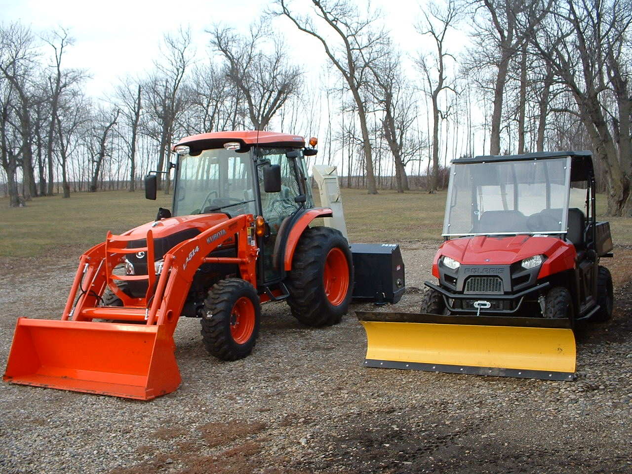

Ranger for the light stuff and rear blower for the heavy stuff.

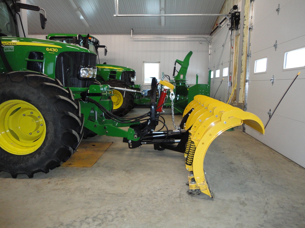

Did you read the description and hover over the lines to see a detail pic for each feature? I ask because it shows how the plow works vs. a conventional truck plow. For instance, one large angled piston instead of two horizontal pistons. And a central pivot point to allow for lateral vs. horizontal float. A crossover valve to reduce shock to the FEL frame. Dual trip springs on each side, etc.
The guys built plows for small to giant sized tractors and loaders- check out their vids and bat wing plows for an idea of how into plowmaking they are invested in design and function.
Hope this answers your question.
A good truck plow will have all of that except it will have 2 single acting cylinders. The HLA 3000 has 2 double acting cylinders. I know a guy that has a HLA 2000. It is a nice blade. I considered a HLA blade when I was looking for one. I don't like how those type of plow work/ perform especially on gravel. I thought maybe you had used a truck plow on your tractor and were dissatisfied.

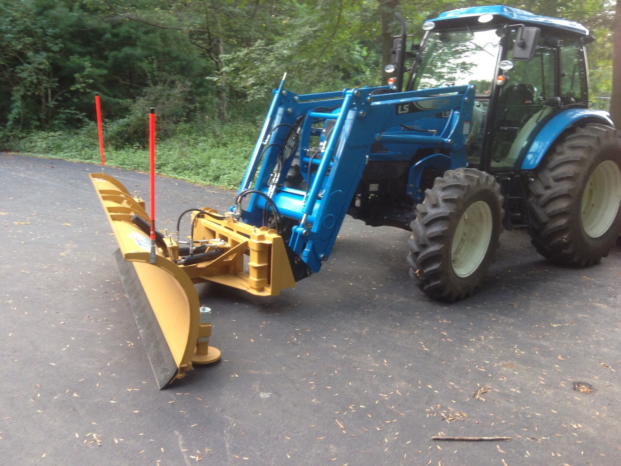

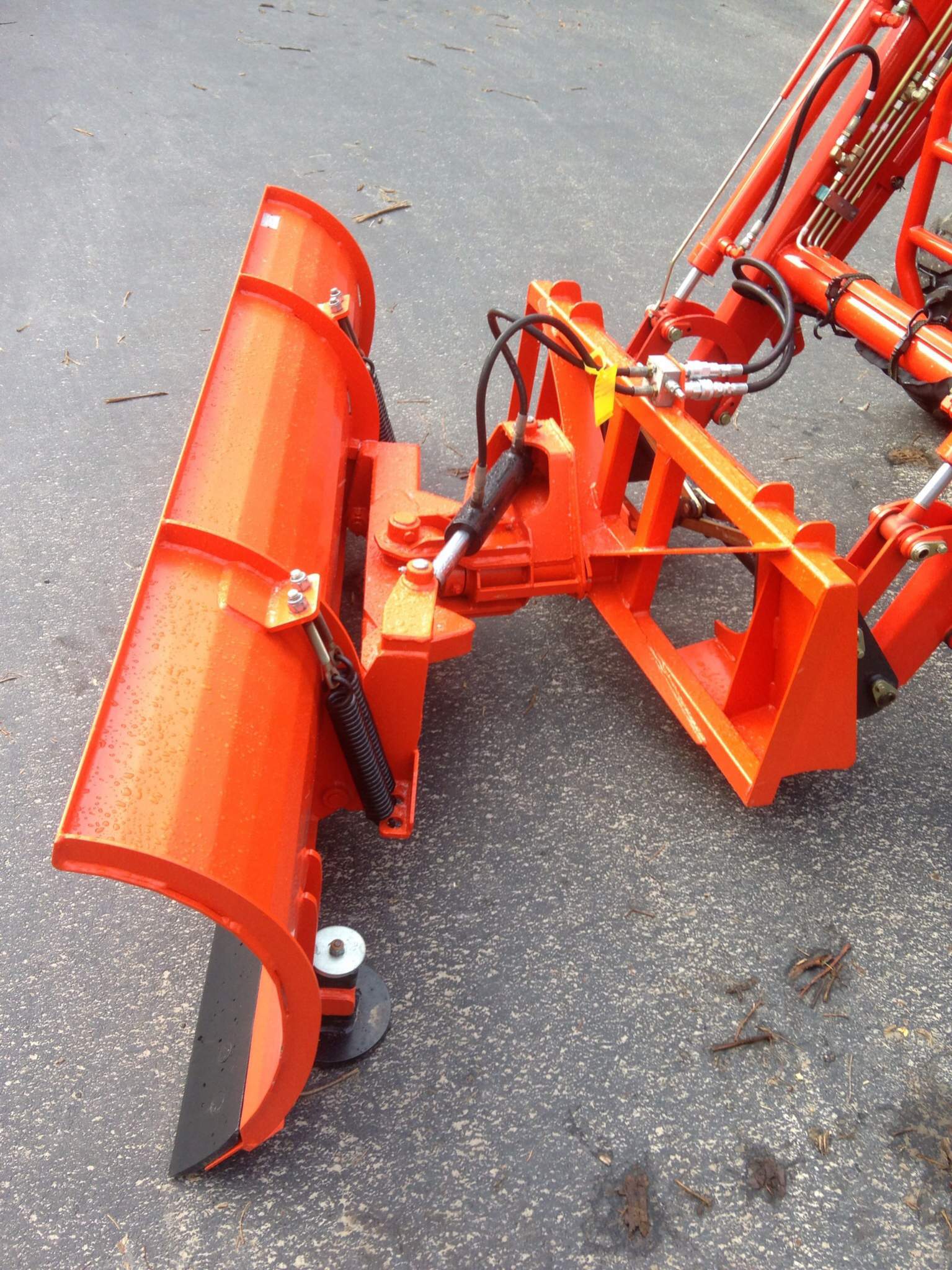

I had the HLA 2000 on a Kioti DK35 that I used all last season and loved it. I have a 1/4 mile gravel drive with about 300' of pavement at the house. When I purchased a bigger tractor the blade was too small and the guy who bought my Kioti wanted every attachment I had. (Plus I had the blade painted to match)
Here is a picture of the plow:
I purchased the HLA 3000 to fit my new tractor, and Roger is right, it has two cylinders as opposed to one but the lateral float is still there. It's just accomplished in a slightly different way. You can also limit the amount of lateral float on the 3000 by a couple of adjustment screws located on the top of the frame.
Here's the 3000 and you can see about half of the float available by looking at the space below the cross-over relief valve. Can't wait for snow!
Man, that's a nice 3000!:thumbsup: And the blue tractor is a beast!:eek: You should be able to plow all the way to my house no problem!:laughing:
What a nice paint job on the 2000. What did that run you if I might ask?
