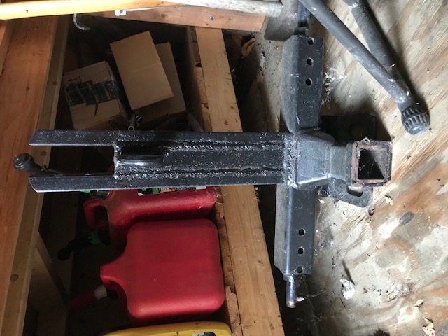

I pulled out a lot of firewood with this, if you don't need to pull a lot of wood I built this for half nothing.. Anything with a grab hook for a chain and steel going down the middle to stop the log from hitting you're tractor.

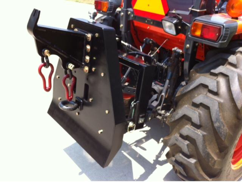

I like this..
