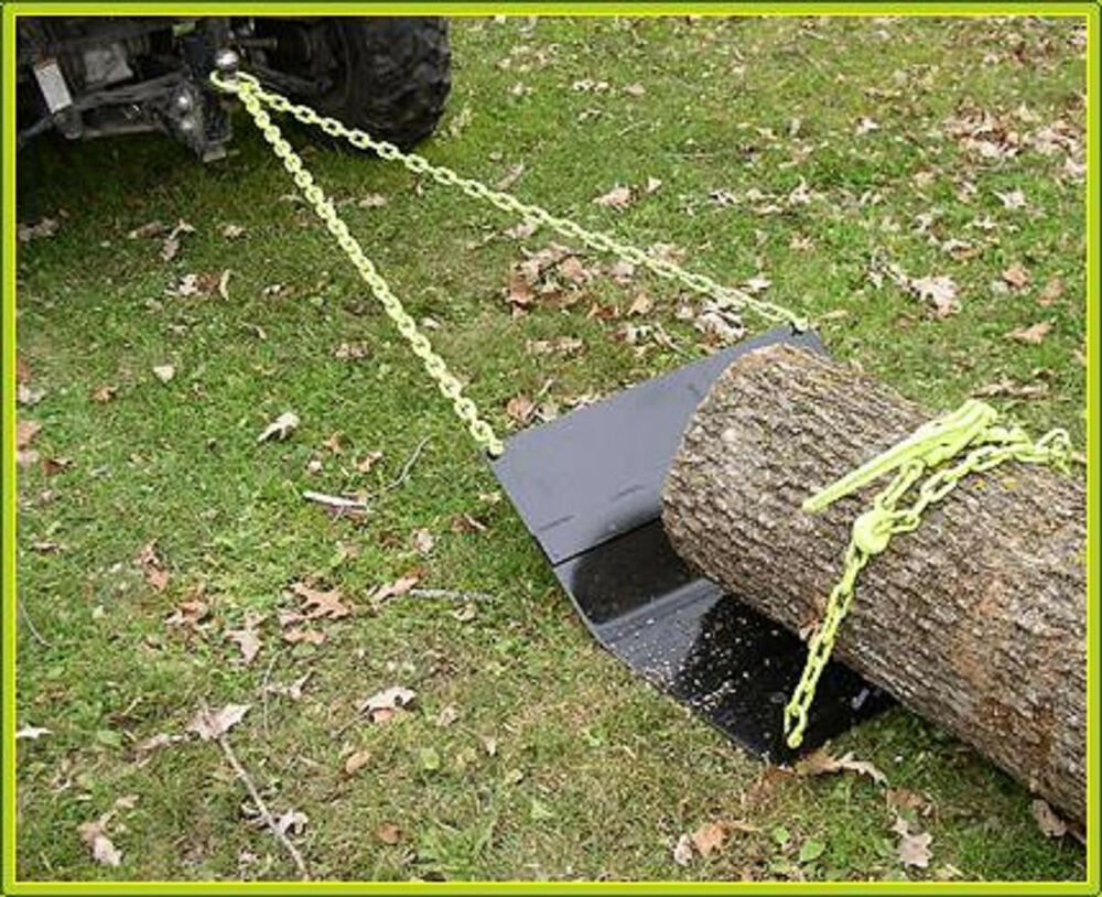

For a 45hp tractor, do I want a cat 1 or cat 2 3pt drawbar?
/ Best Log Skidding solution #39
What I’m working on is getting out some butternut logs that we want to have sawn, as my dad and I are woodworkers. He makes canoe paddles and I made cabinets and furniture, butternut is great for both and rare these days. Had a few fall down and we want to use them. I can get my tractor, wheeler, or UTV right to them. Also, we have a ton of ash trees that are dying due to the emerald ash borer, so we want to get some of those logs out to sell while they are viable.
If you can get right up to them, then a logging winch doesn't really do you any good. Those winches are great for getting logs to your tractor, but if there is no need for that, save your money. You may want one someday, but it sounds as though your current needs are simpler.
Since it's a sawlog, i'd recommend not simply chaining them to your drawbar and dragging them on the ground. At the least, get the front end of the log up using a skidding plate or a logging arch (you can also rig your own device for lifting the front end of the log with your 3 pt hitch, but be aware that there can be safety issues with this if it is not done correctly).
Another possibility is loading the logs into a trailer: you can rig something on your loader (choker chain or tongs, or buy a grapple) or use a couple of inexpensive ways (if you already own a trailer or can find a cheap one) to rig a trailer for loading: do a search here on this site or google/YouTube search "parbuckling" (using an electric winch & ramps to roll logs onto the trailer from the side). An alternative is to add a loading arch to the back of your trailer. This also relies on an electric winch to provide the power. I've seen folks make then for next-to-nothing. Here are a couple decent links showing some:

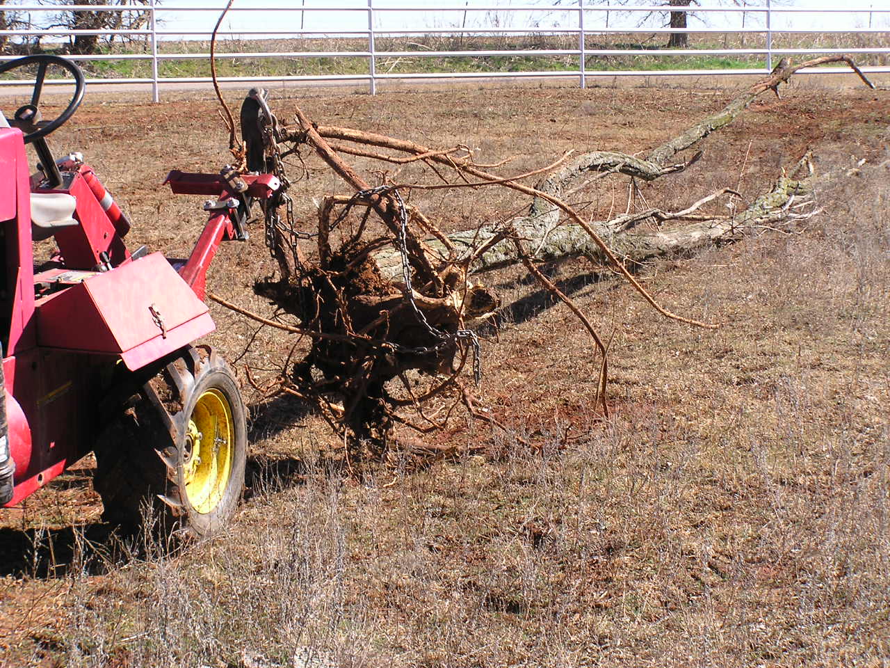

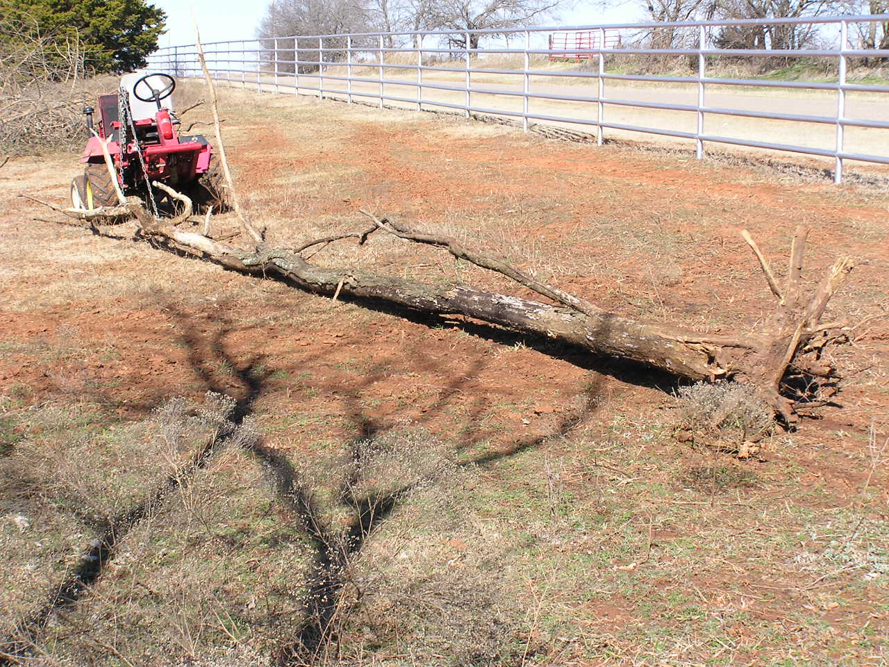

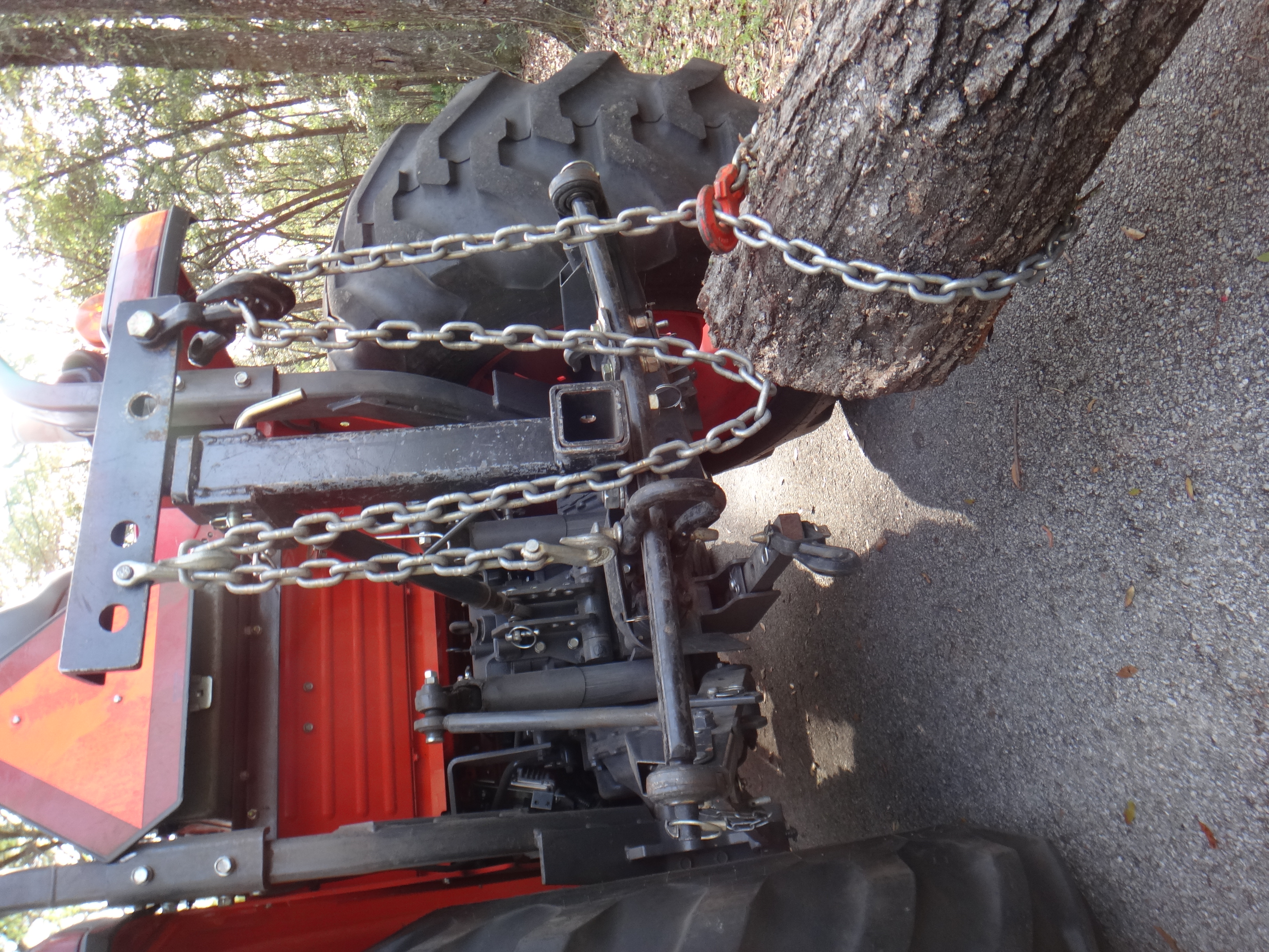

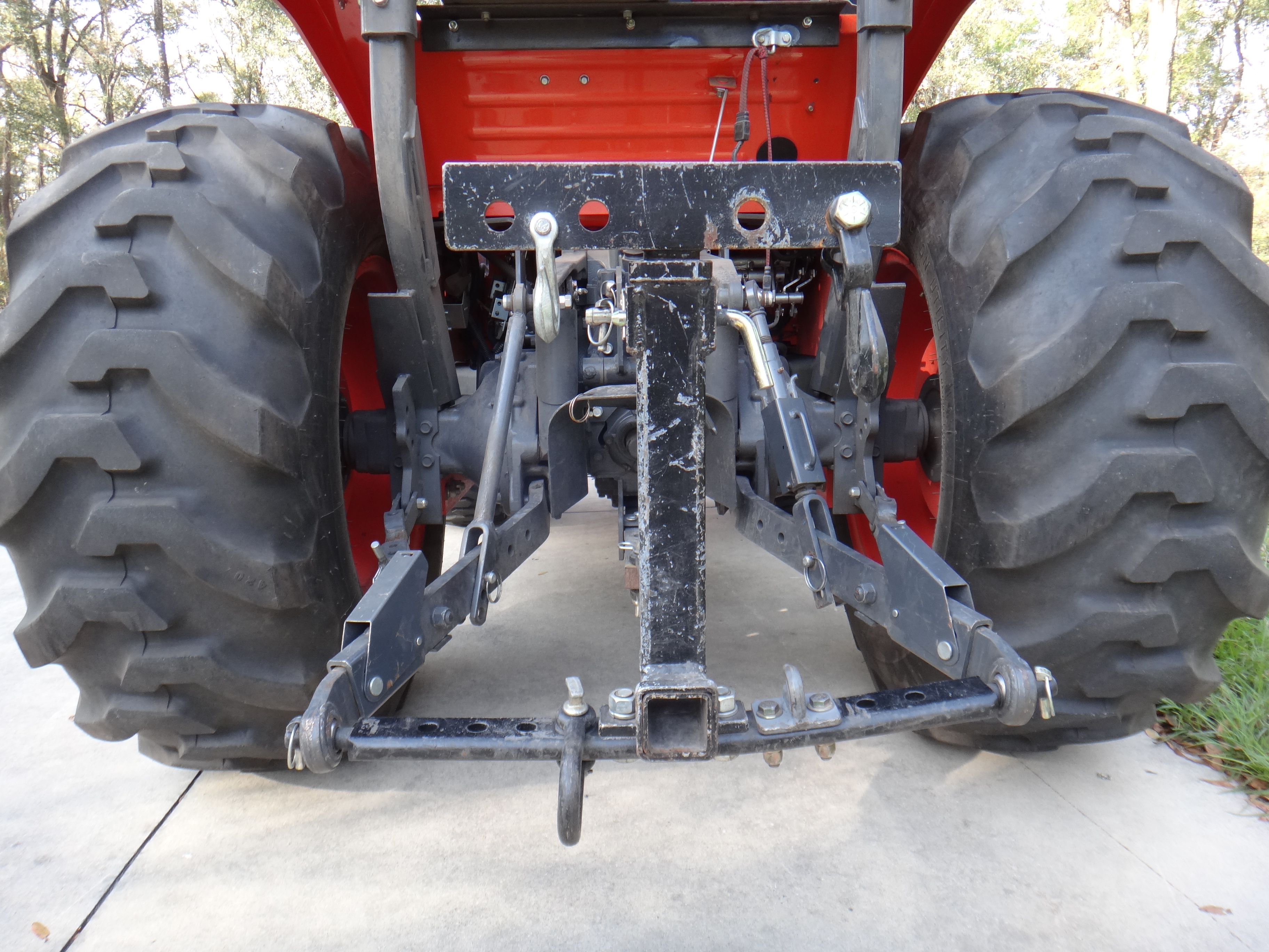

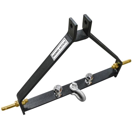

Light duty cross-drawbar variations, which allow you to raise logs slightly, reducing ground friction and keeping 50% of log length clean.
MORE: https://www.tractorbynet.com/forums...actor-three-point-hitch-cross.html?highlight=
https://www.tractorbynet.com/forums...ar-center-tractor-drawbar-use.html?highlight=
we had the Titan 3 point hitch one in the pics on the right and bent it into a pretzel right away moving trailers, it was flimsy junk . Bought the heavier square tubing one with a receiver hitch in it, much more durable
