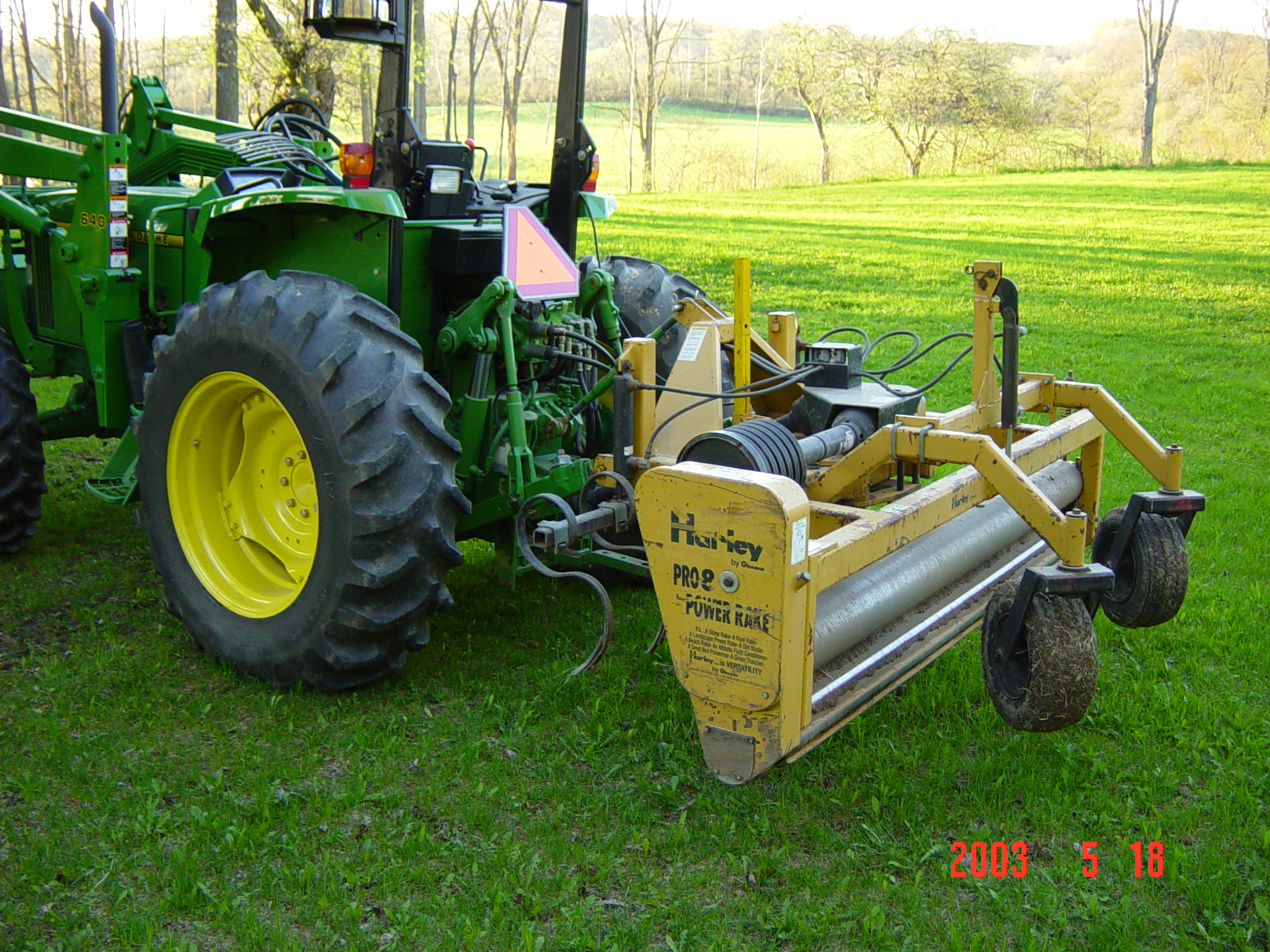

I Too VOTE Harley Rake. Although smaller. This is the old model that had TWO ROLLERS AND S TINES. Too expensive to make that way anymore. If you have ever used an Electric Planer over a hand one, well that's like the Harley, over a fixed rake.
BUT, For the Money, One of those spring tooth Rakes is GREAT. Bit with gauge wheels.

A power (Harley) rake is the answer. Rent one or pay someone with one on a skid steer. I have a 6' PTO driven power rake I run off the back of my 55hp tractor. There is nothing equal to smooth grassed areas. No need to re-seed. The power rake will distribute the grass roots and it will re-grow pretty fast.
