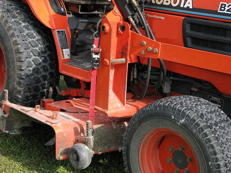

Not a modification but a quick way of pinning up the mower deck for using the three point with a box blade. Anyone who has used the factory holes for pinning the deck knows what a pain it is.....this works in seconds.
Check out the ratchet strap from the loader brackets to the deck, one on each side and no more climbing under and hoping things line up. Straps are available in orange at Home Depot etc, I used some old ones that had road rash to see if it worked....works perfect.

Where is the foot guard on the mower?
Safety Police:)
Safety Police;)
Where are they when you need one?:D
   / best modification? #40
Is that what that was...now I know.
Guess I had mistaken it for a tree and fence killer and put it out in the barn with the rest of my JUNK. Some day (like the day after I take out a car window as I've done twice in my life) I'll make a rubber one that doesn't kill trees and tear up fences, or maybe one like they put on Dixie Choppers that can be moved up and down, but amazingly it doesn't shoot rocks out as badly as my old Craftsman (Window Killer) did.
Would be cool to see in this thread ideas for such designs.
