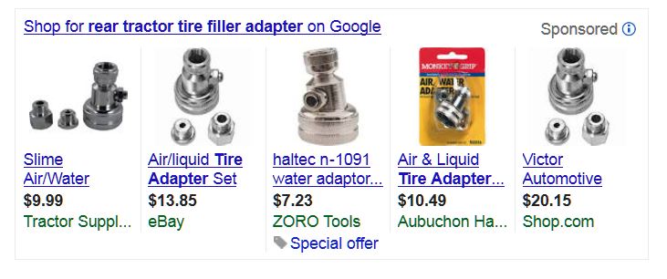

   / Best rear tire filler for cold weather #24
ps. napa and tractor supply and probably most farm stores have the burp valve that goes from hose thread to valve stem thread ( with a couple different size adapters to cover most common stem types. )

   / Best rear tire filler for cold weather #28
