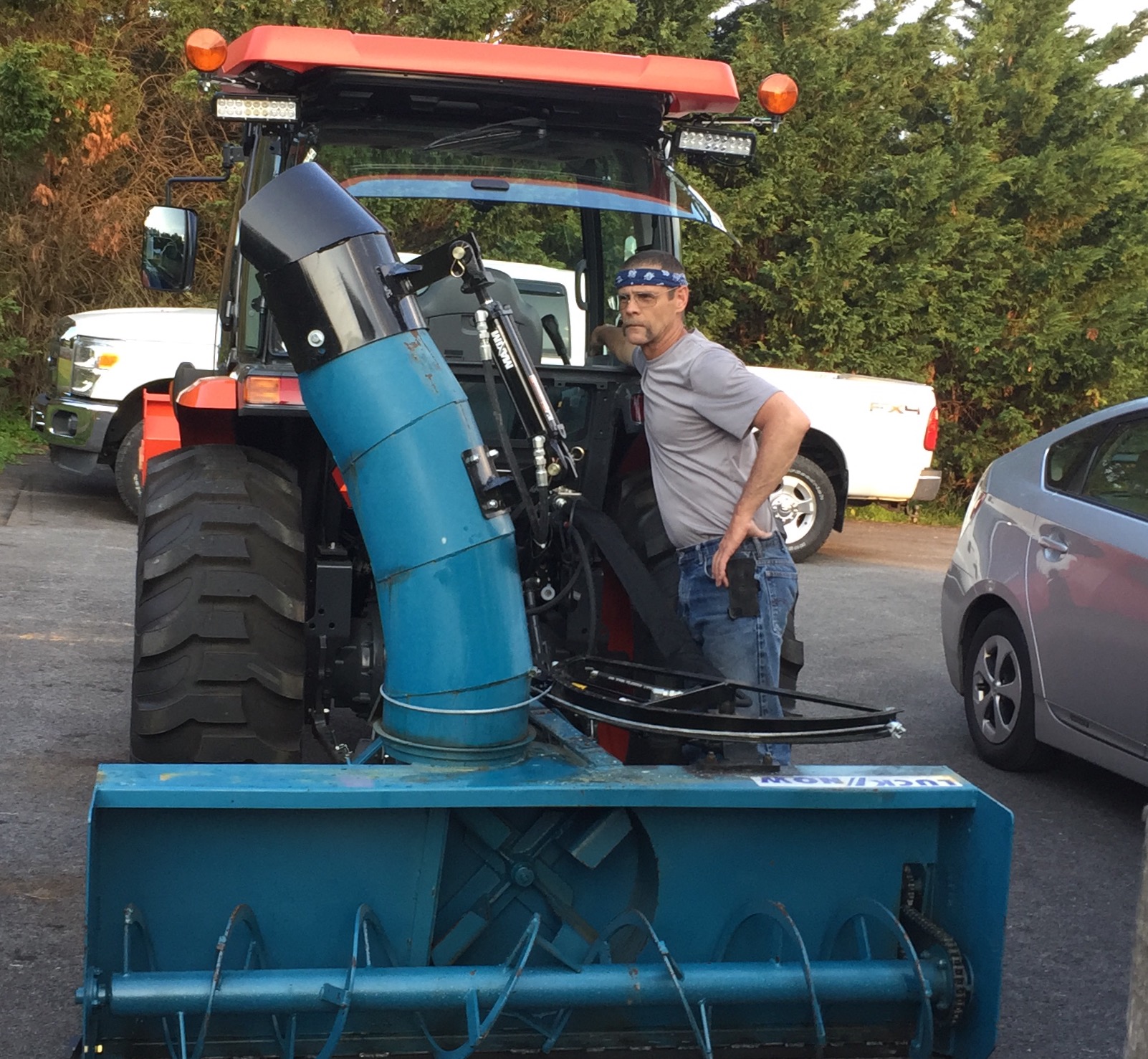

Several years ago I added the deflector and hydraulics to mine.

I made a quick snowblower video with my MK Martin Inverted SB68 P/T. Snow conditions was far from optimal.......but it seems to be the indicator of the kind of winter Montana will have. Wet snow and slushy.

Nice. I'll bet you will be happy when that base freezes down. How does using the inverted snowblower compare to how you used to remove snow?
I am envious of your hydraulic chute rotator.

HI! Airbiscuit, I can truly say that depending on the snow amount vs pushing snow I am down to a 1/3 of the time if it is about less than 6'', if it is over I am still half the time spent. Yes, it is that much faster.
