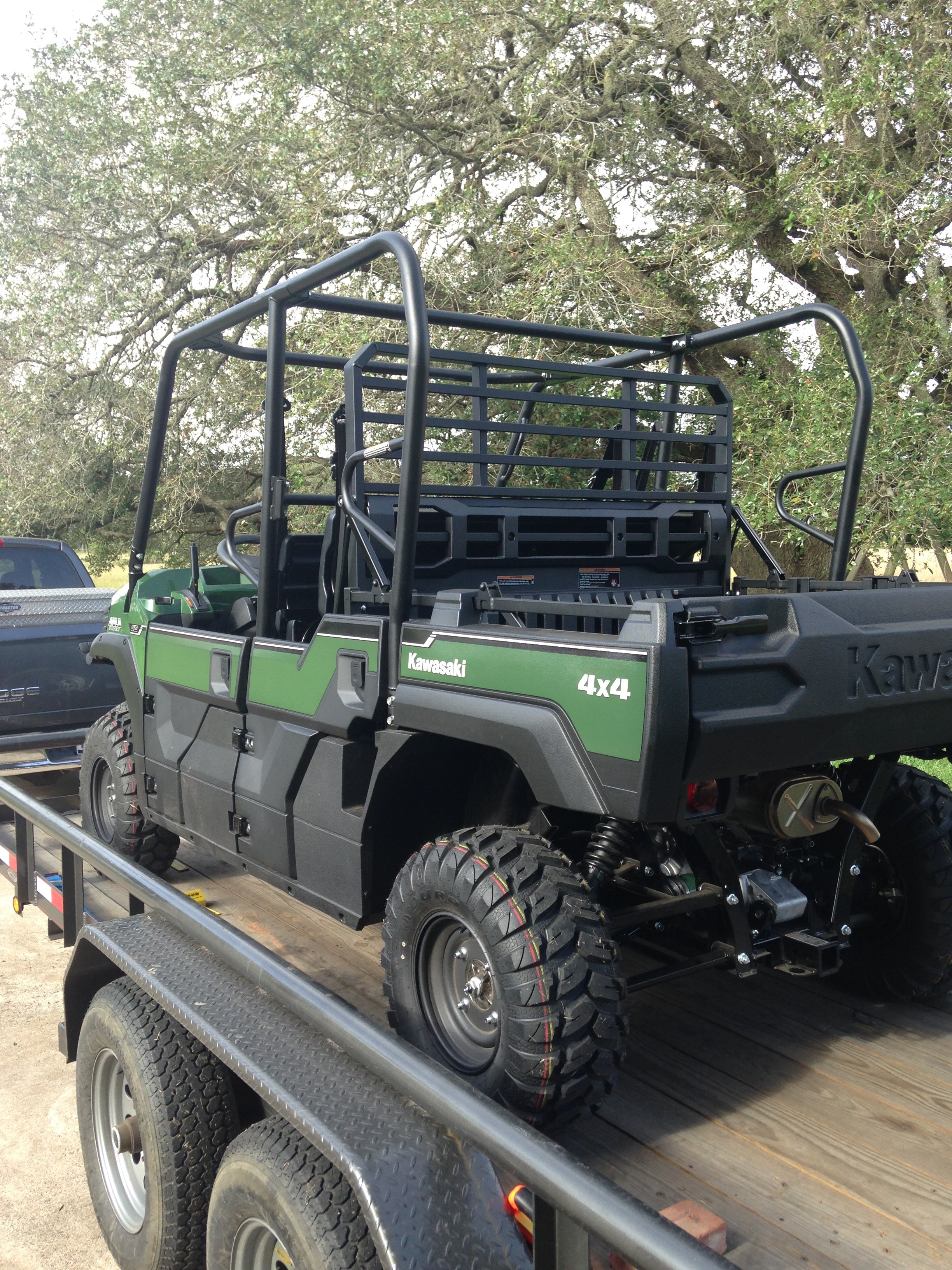

I bought a 2018 Kawasaki Mule last year. Sits six people easily. In fact, I have hauled 7 adults (six in the seats and one in the bed), a toddler and 2 dogs in it with no problem. The bench seats look plain, but they are comfortable and very versatile. Everyone that gets in it remarks how smooth it is. I looked a little at the Kubota but my Kawasaki dealer is right down the street and the price was right at just over $14k. I like the half doors, they keep rocks, mud and brush out. I really have no complaints so far. Everything on the engine looks like it will be easy to access with the bed tilted up. Like lots of things, it could use more storage. There can be bins under the front seat, but that isn't very practical as the seat just pops off, it is not on hinges. Those who say it isn't fast enough at 45 mph top end are crazy. No way I would drive one of these utility vehicles at that speed. Fastest I have had it is a little over 30 mph.
I looked at the specs for the diesel mule. I think it had less torque than the gasser and couldn't pull any heavier of a load. I got over wanting a diesel. Kawasaki has gas mules down oat and have for decades.
The diesel Kubotas are rated for 1300 lbs towing while the gas mule is rated for 2000.
