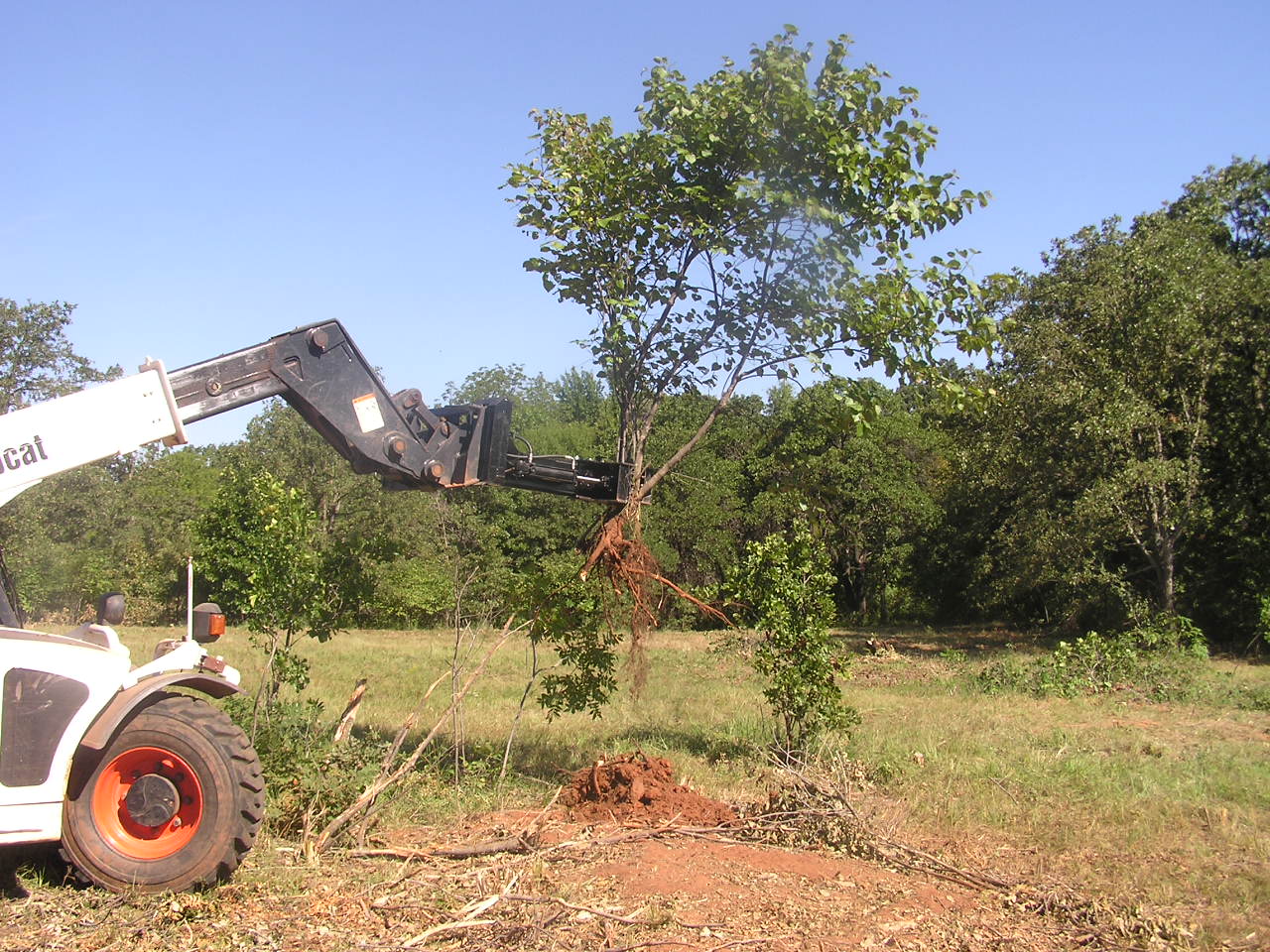

I have about an acre that has a lot of 2" oak and Sweetgum trees as well as a LOT of 1-2 inch wild pear trees. What is the best way to clean this up. I tried chemicals on the wild pear saplings but they always seem to come back. I would like to take care of this problem so that I don't have regrowth. I have a 3930 new holland and a Gannon blade. I seem to recall there is some type of grabber that you can get to pull up the saplings but this seem like it would take a long time. Thanks

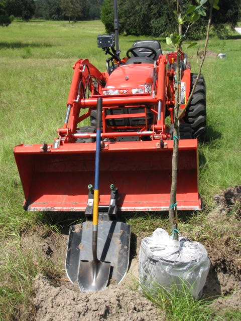

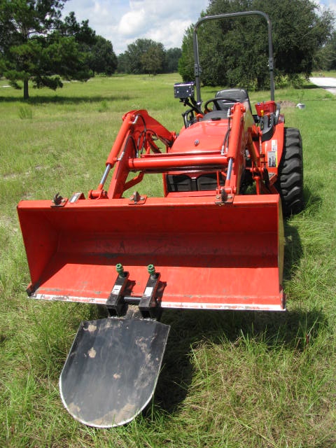

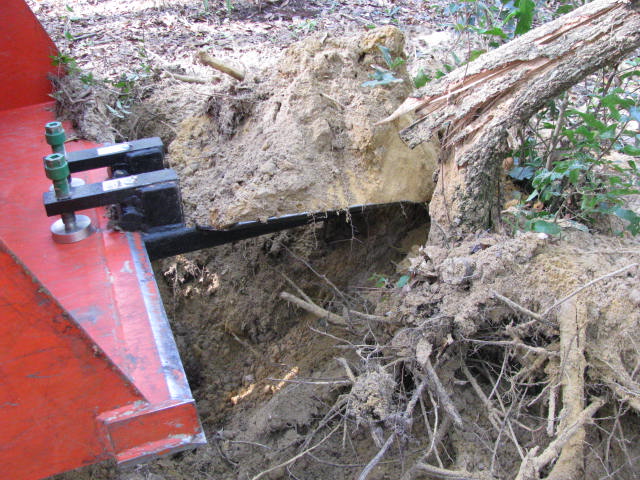

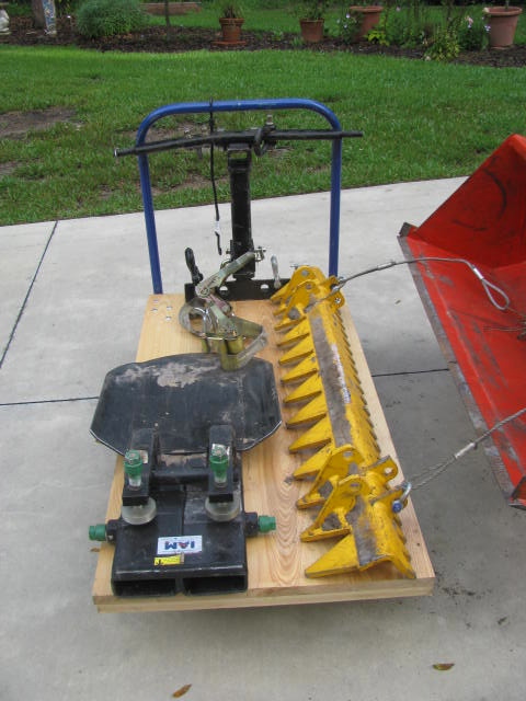

I have one of these grabbers and it works very well...but to use it efficiently you really need a "ground man" to keep from having to stop and get on and off the machine to grab the next sapling...

Brush grubber works great, but as noted you need a helper for the best productivity. I used one extensively to clear saplings. Either pull via wheel traction, or in some cases can lift up using the 3-pt hitch to pop saplings loose.

Check this tree puller thread: http://www.tractorbynet.com/forums/attachments/277824-tree-puller.html
The advantage of pulling is, no stump, very small hole after you shake the dirt off of the roots.

Used my Grubber on a 3/8 chain hung from bucket hooks tonight to see how hard it would be to use. It pops them out of the ground fairly easy, but need two people to be effective. Realizing I need a box blade or weight box on the back. Got a rear wheel in the air a couple of times. At that point I just put the bucket really low and drove forward and they popped out. I would recommend going forward versus back cuase when the tap root lets go it does so with a POP. Going backwards may put the thing through your grill.
