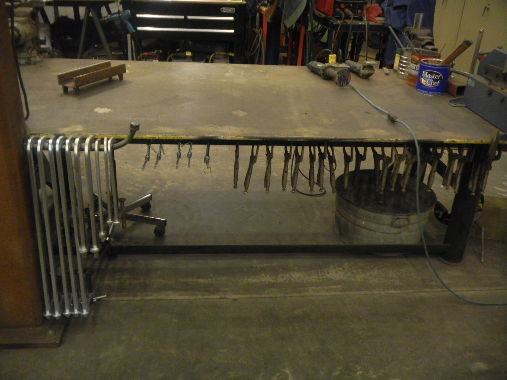

On the whole I don't bevel 1/4" thick material, but it depends on what it's used for.
Personally I would clamp each piece to my welding table with a pair of #11s, and walk right down the line with a 9" grinder to bevel the plates.;)
I guess you pulled your hand back down.
I knew you would come up with a good idea. My welding table is 40" long and I have at least 12 clamps of various types, A piece of flat bar on top and one clamp would hold 2 pieces. When I get back from vacation I now have a bunch of options I did not think of. In retrospect I should have cut each piece 1/16 th short and just gapped 1/8. actually this frame will take a lot of stress so wanted to assure good welding.
Thanks a lot guys, Ron
