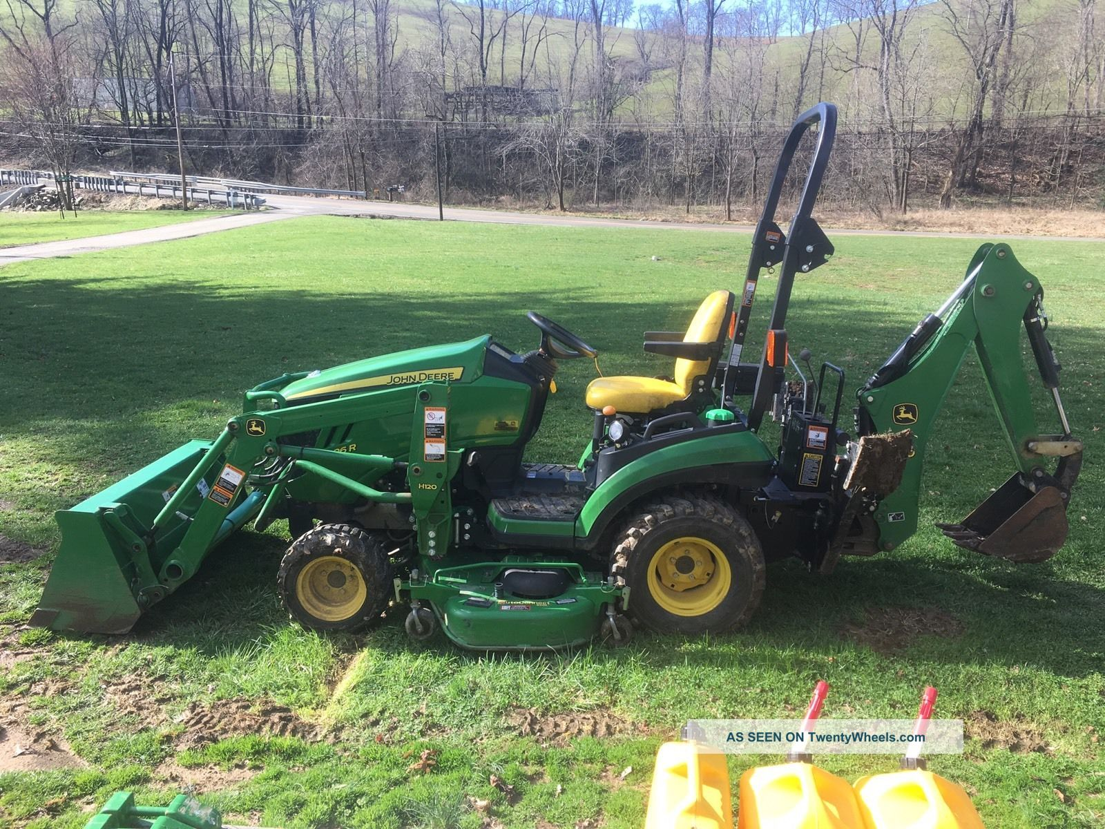

That mounting of a backhoe indeed looks cumbersome. All TLBs are NOT created equal, however, as stated by someone earlier... I did have some trouble getting my TLB up on a trailer for transport, but I was loading onto a dump trailer w/a 30" high deck and 7' ramps... could not drive forward w/o scraping my backhoe frame SOME, but BACKED up w/o any trouble. This pic demonstrates an OEM design which intended to include a backhoe in the design from the beginning...
