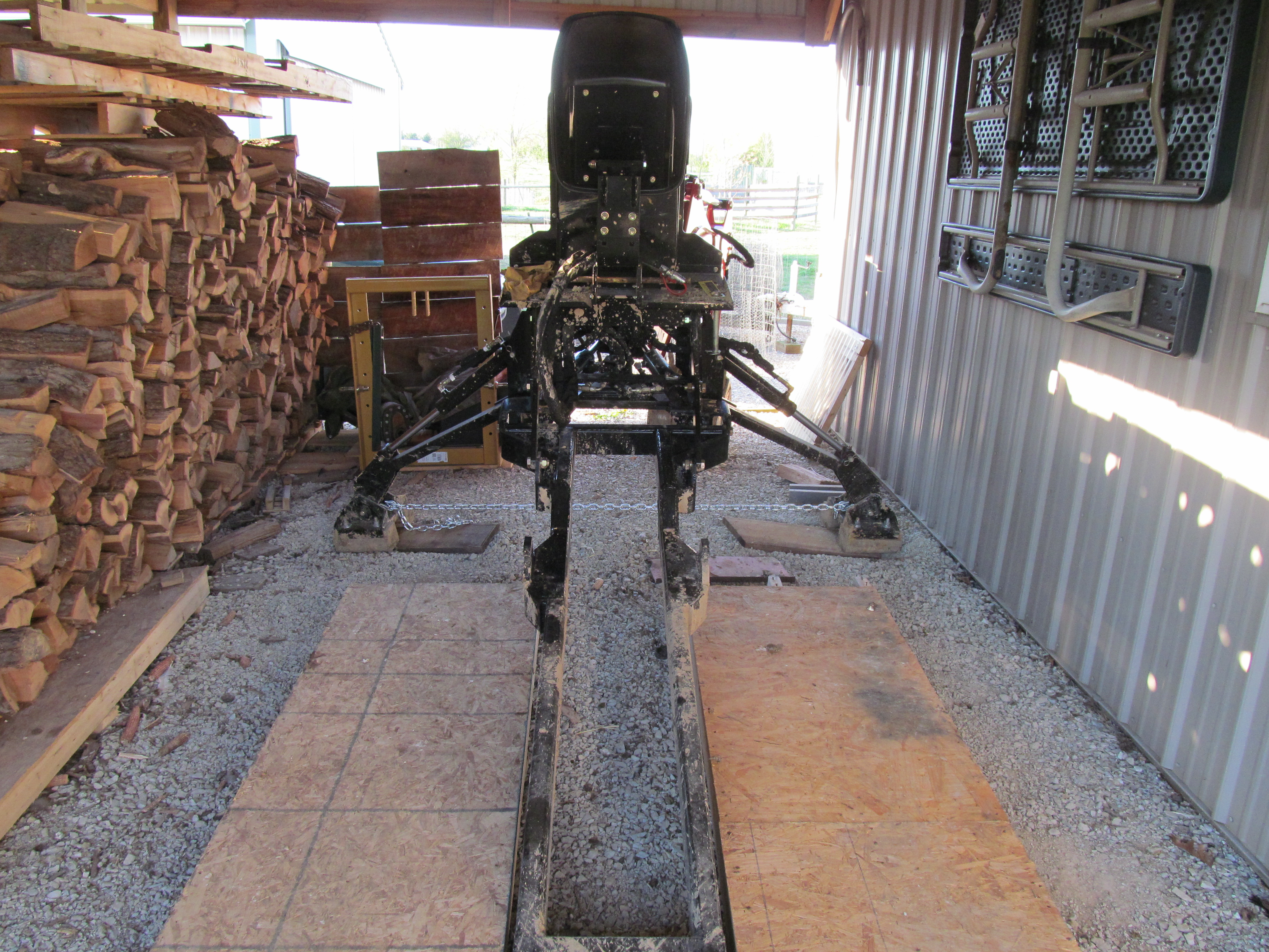

You're not oversimplifying it. It's just about that easy. When I remove mine again, I will put some blocking under the main portion (directly below the part where the chair is) for safety and in case the stabilizers lose pressure over time, which would cause tipping. Follow Zork's steps above and it should be easy.

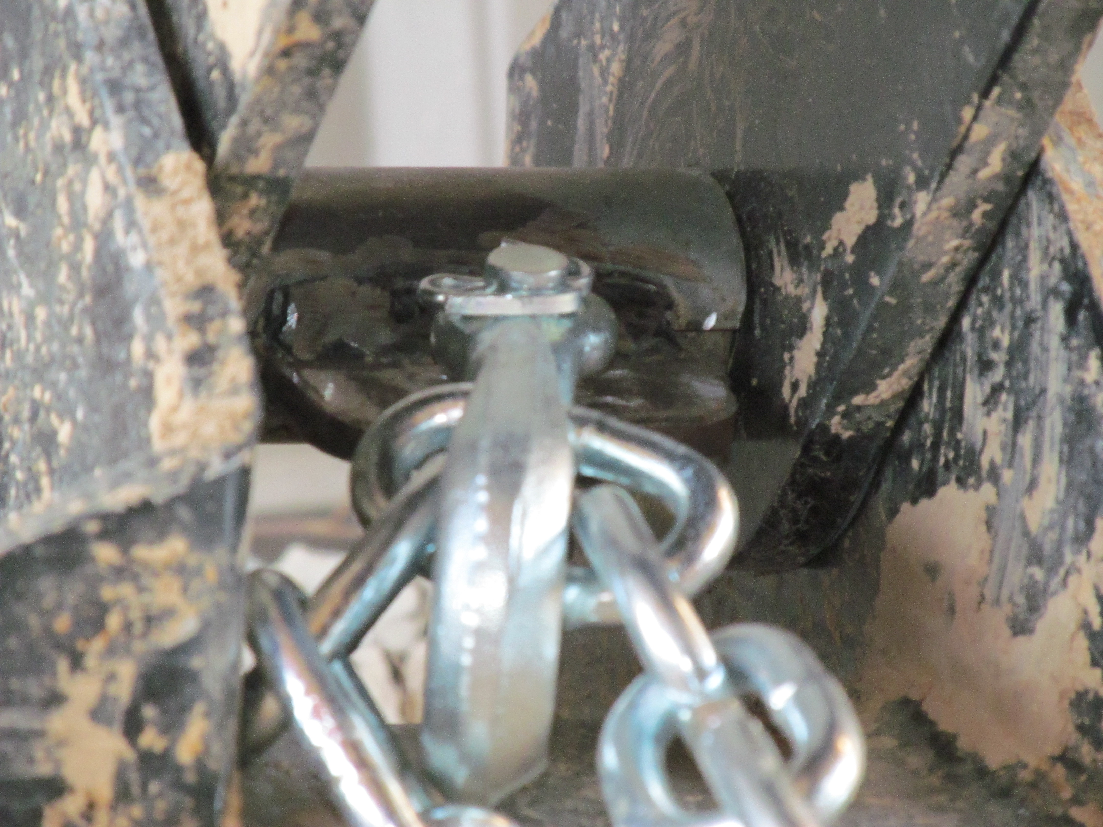

Here is how I came up with a way to keep the legs from pressurizing the lines during storage. I made hook setup that ties a chain between the feet of the outriggers. Each foot has a hook that stays with the foot. After I remove the hoe from the tractor I tighten up the chain before I unhook the lines from the tractor. The chain keeps the hoe from lowering and increasing the line pressure. The wooden ramps are so I can park our Mule over top of the sub frame.

The line pressure can increase because of the hoe lowering, so you have solved that issue. But it can also increase substantially due to temperature differential. You have solved one problem, but you still may have the occasional over pressurized QC.

When I put the hoe away it is after being used and the temperature of the oil/cylinders/valvepack and lines are well above ambient air temperature. Sitting in the shade of the barn, air temperature is not going to raise the oil temp above what it was when initially stored after being used. If it was stored away in the winter it maybe a different. This has been working for me.

You are surely good to go if you put it away hot.
