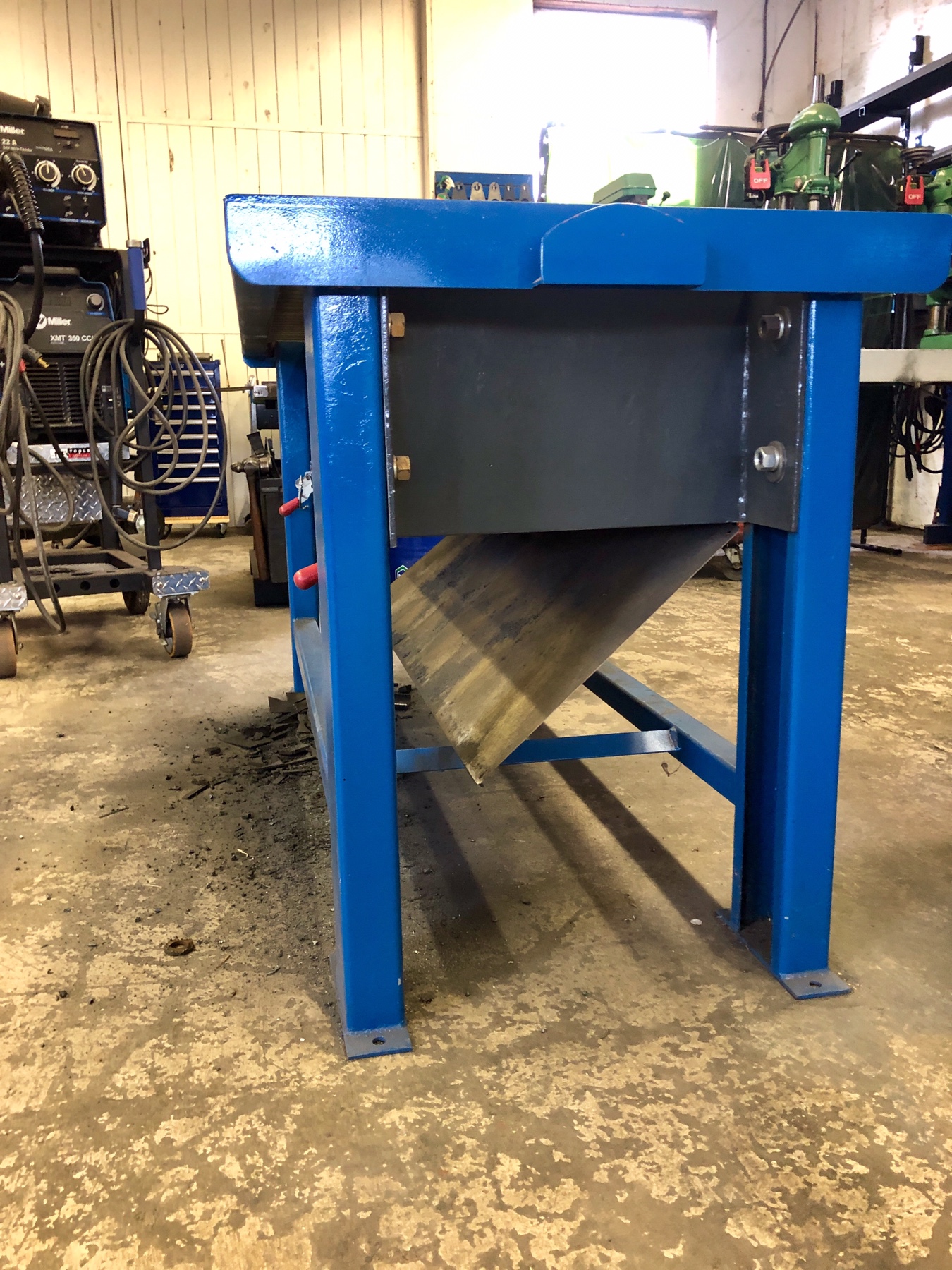

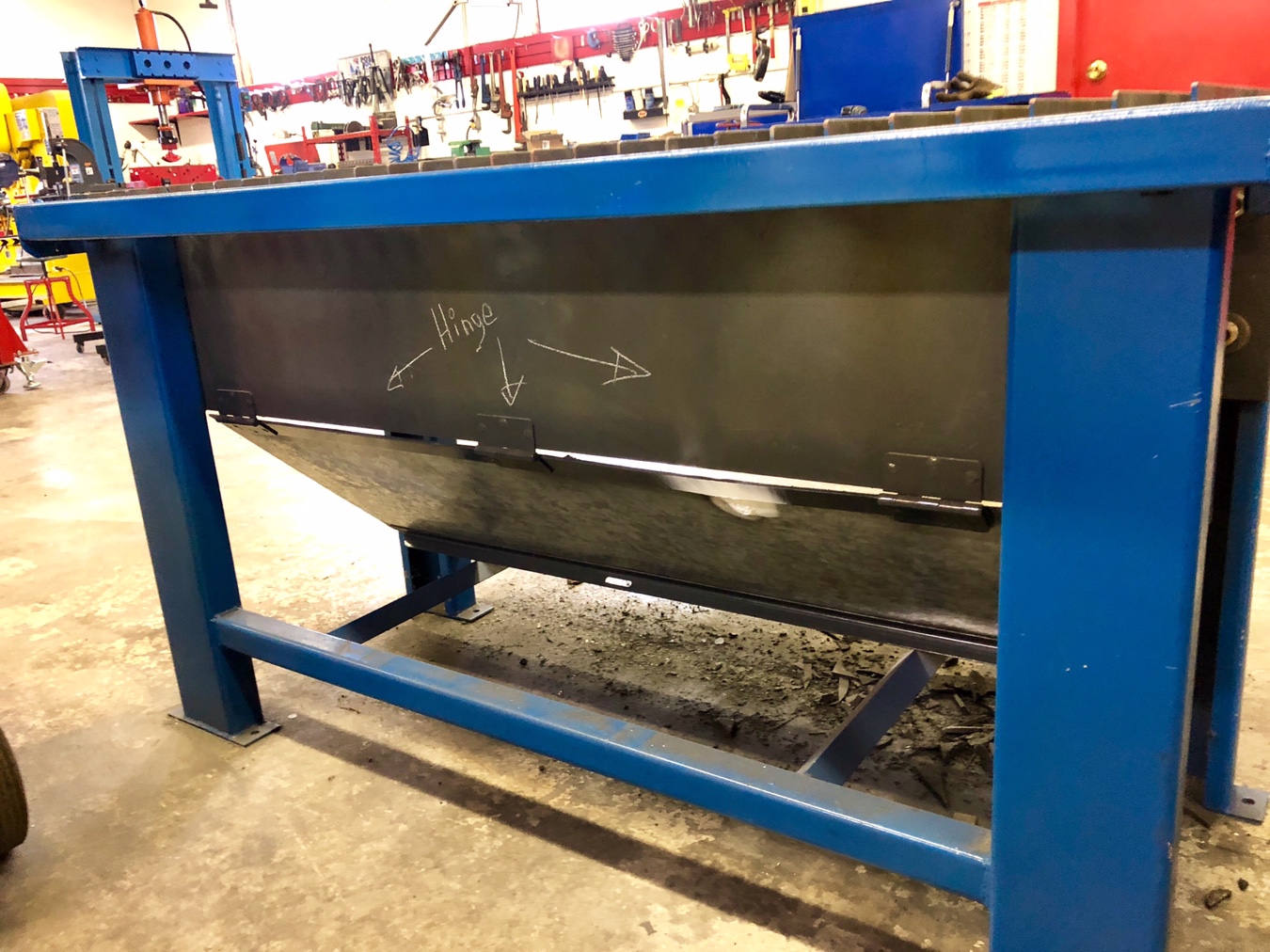

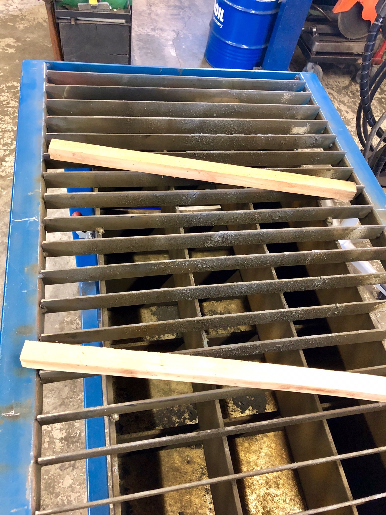

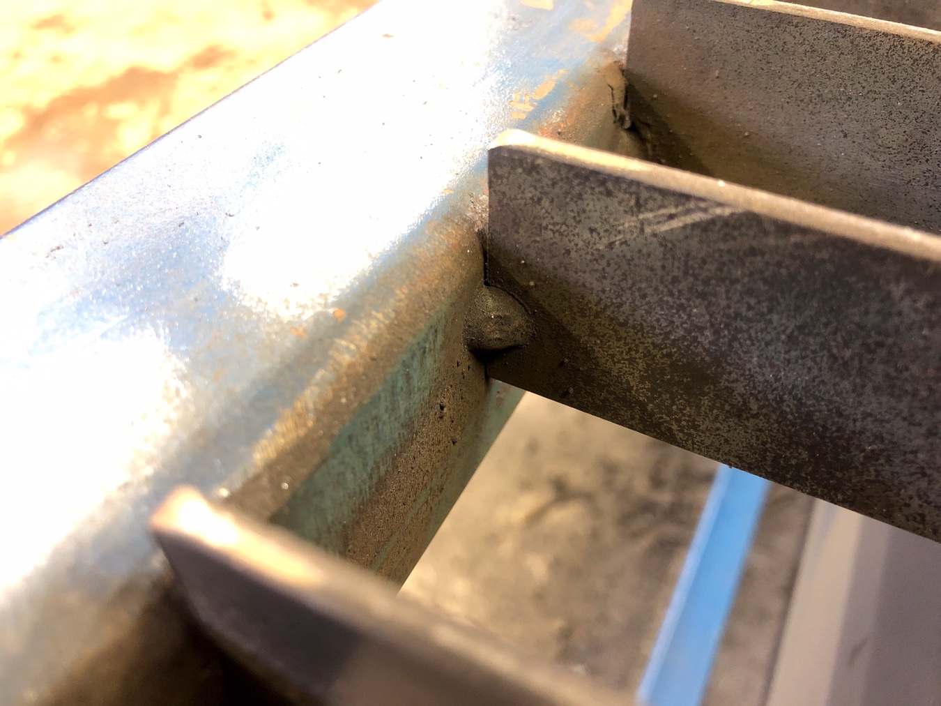

So you just tacked the slats? How do you remove them, plasma gouge?

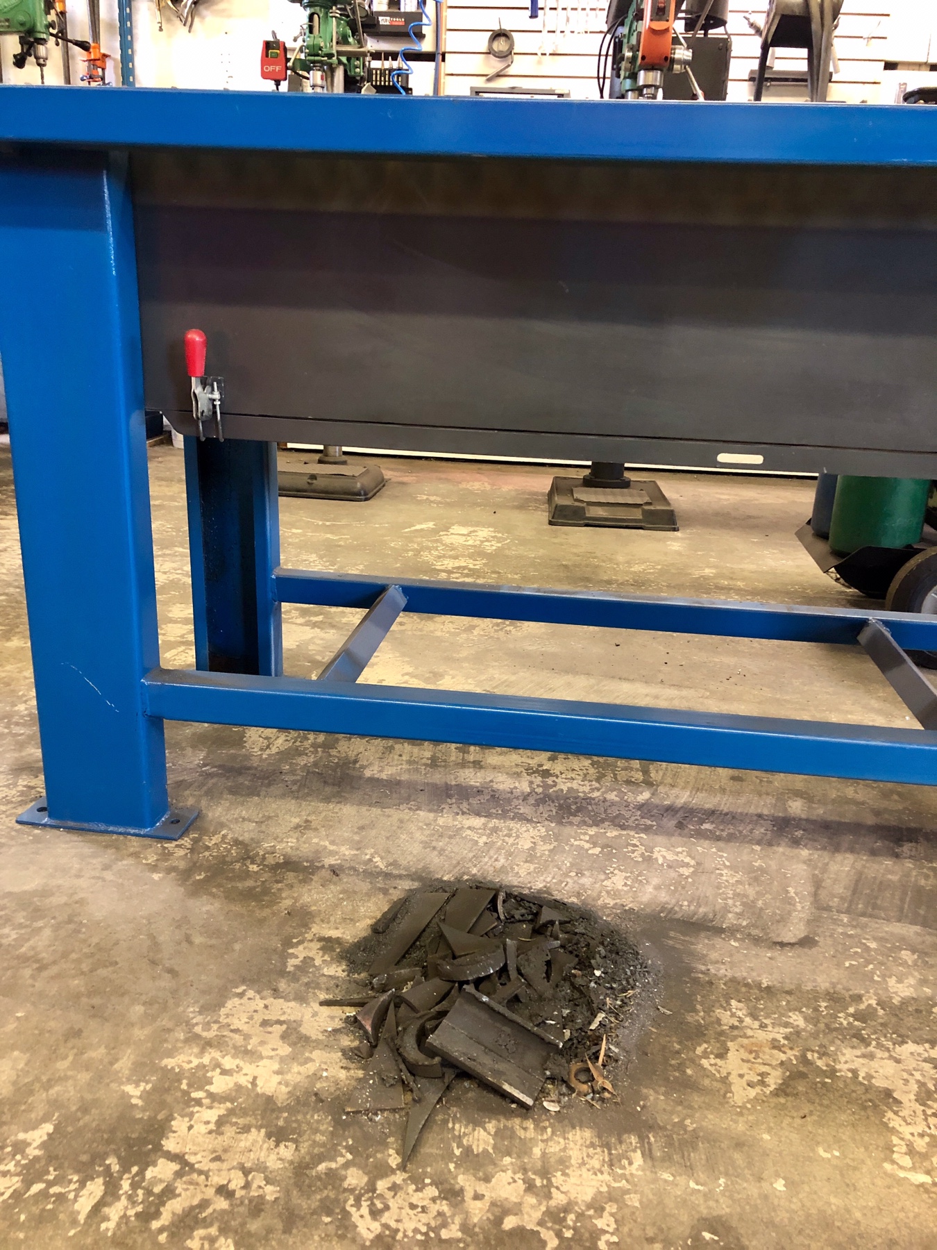

Also can you show a little more detail on the debris collection/clean out system? I’m working from my iPhone so screen size is working against me.
Yes the slats are just tacked. They can be easily removed with an angle grinder mounted cut off wheel.
This table was built four or five years ago and still has the original slats because I always do this:
Here’s a few shots of the table bottom in “ejection” mode.
Ready for the night janitor:

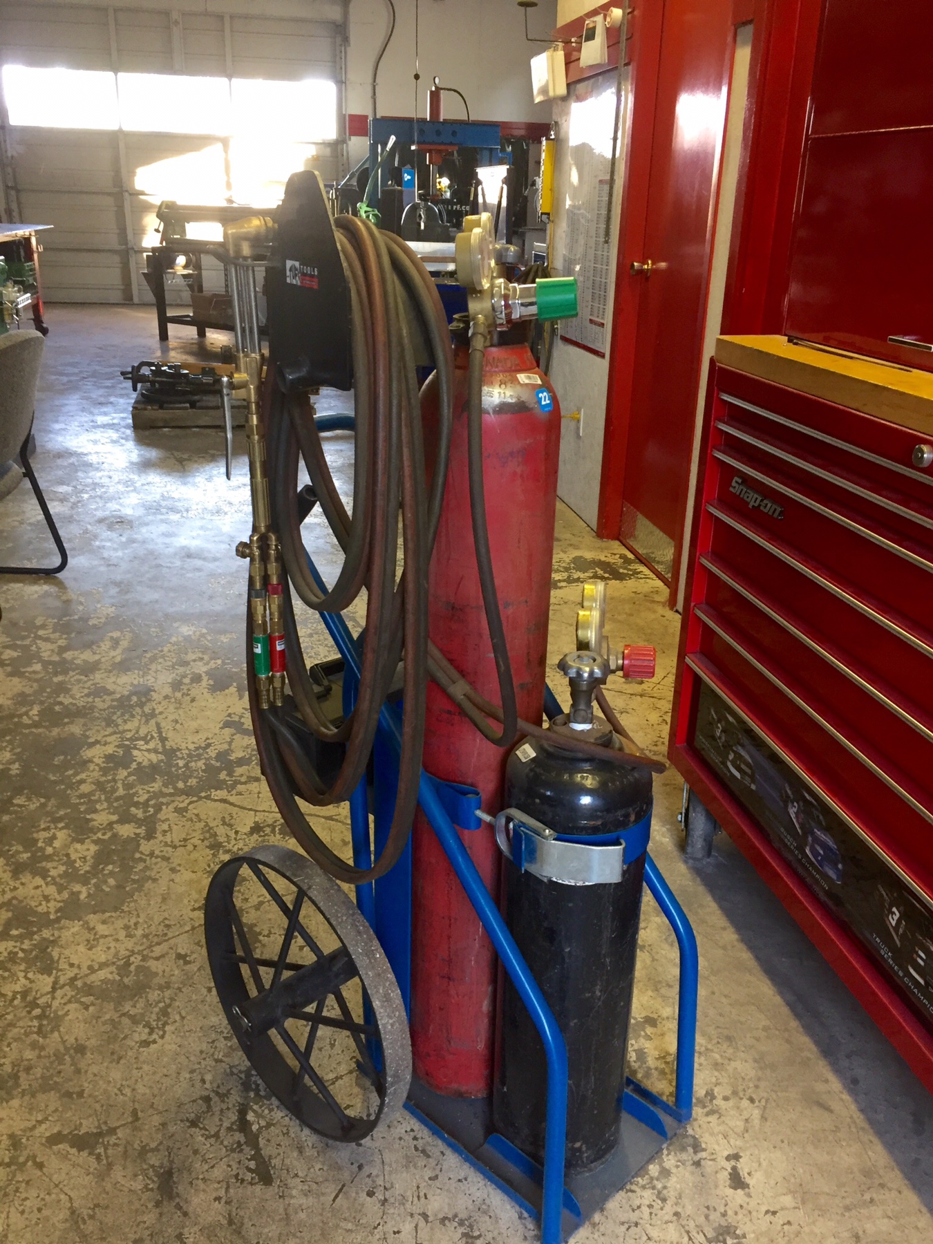

Oxy-Fuel Torches
I’ve always had an oxy-acetylene set on the farm. Even before my first buzz box welder.
Nowadays plasma cutters excel at cutting ferrous and non ferrous metals but there will always be a place for oxy-fuel.

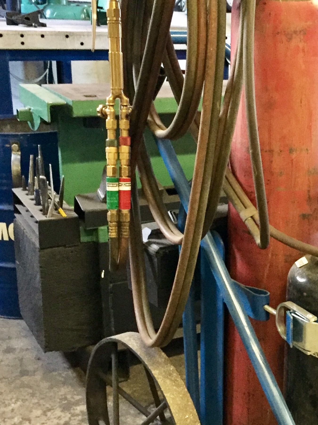

Here’s my rig with homemade cart and bottle clamps.
Flashback arrestors

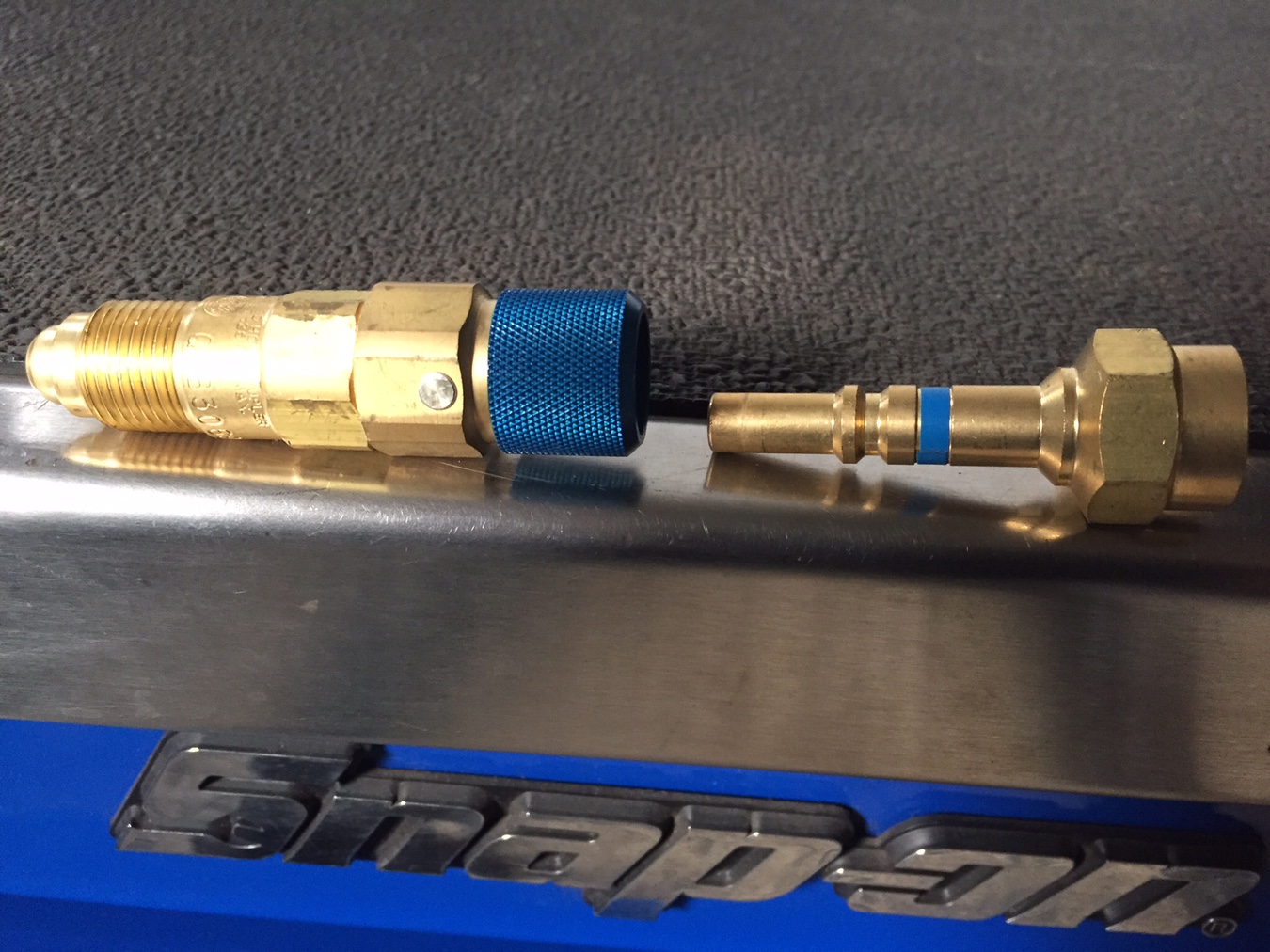

Quick attach couplers for fuel and (inert gas in photo)

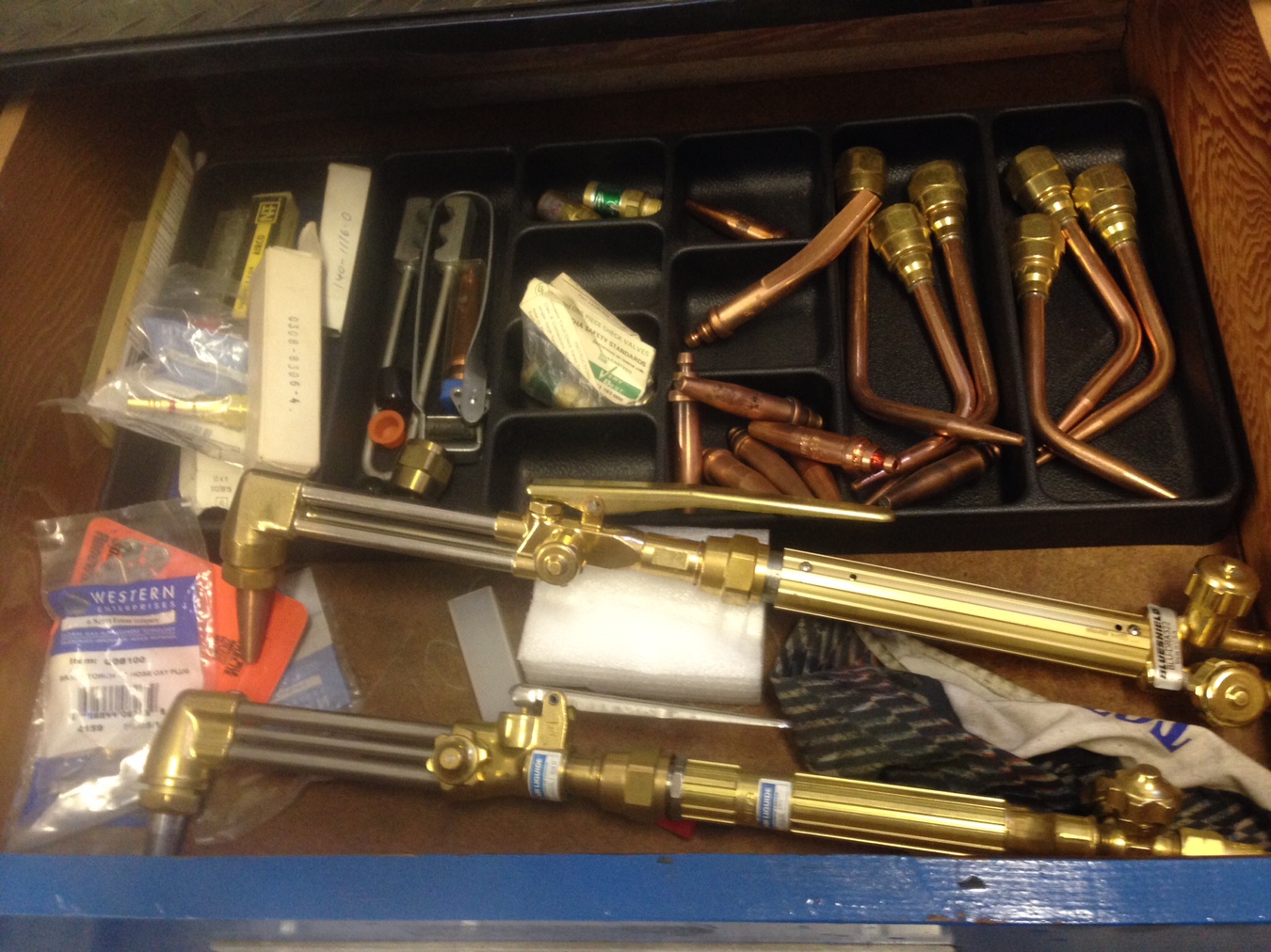

Cutting attachments and torch tips

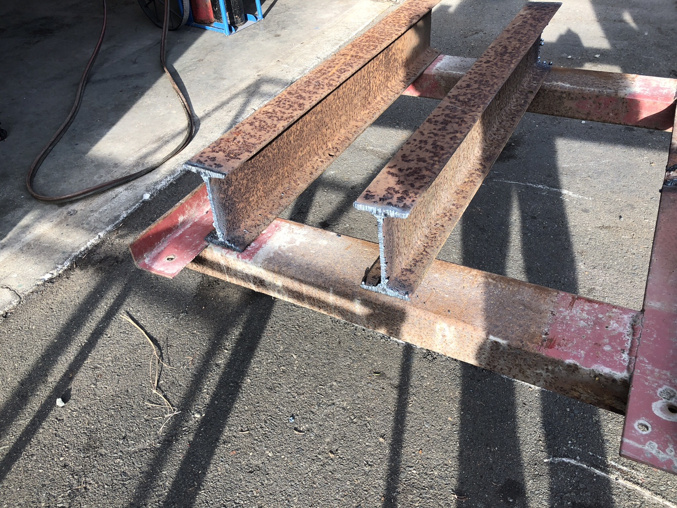

Cutting I beam (could have used plasma but felt like using O/A)

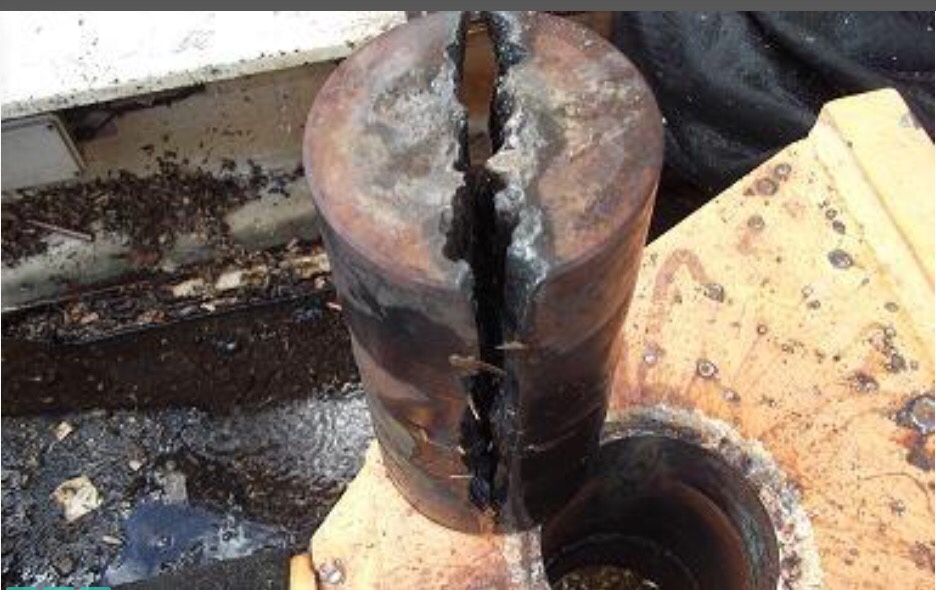

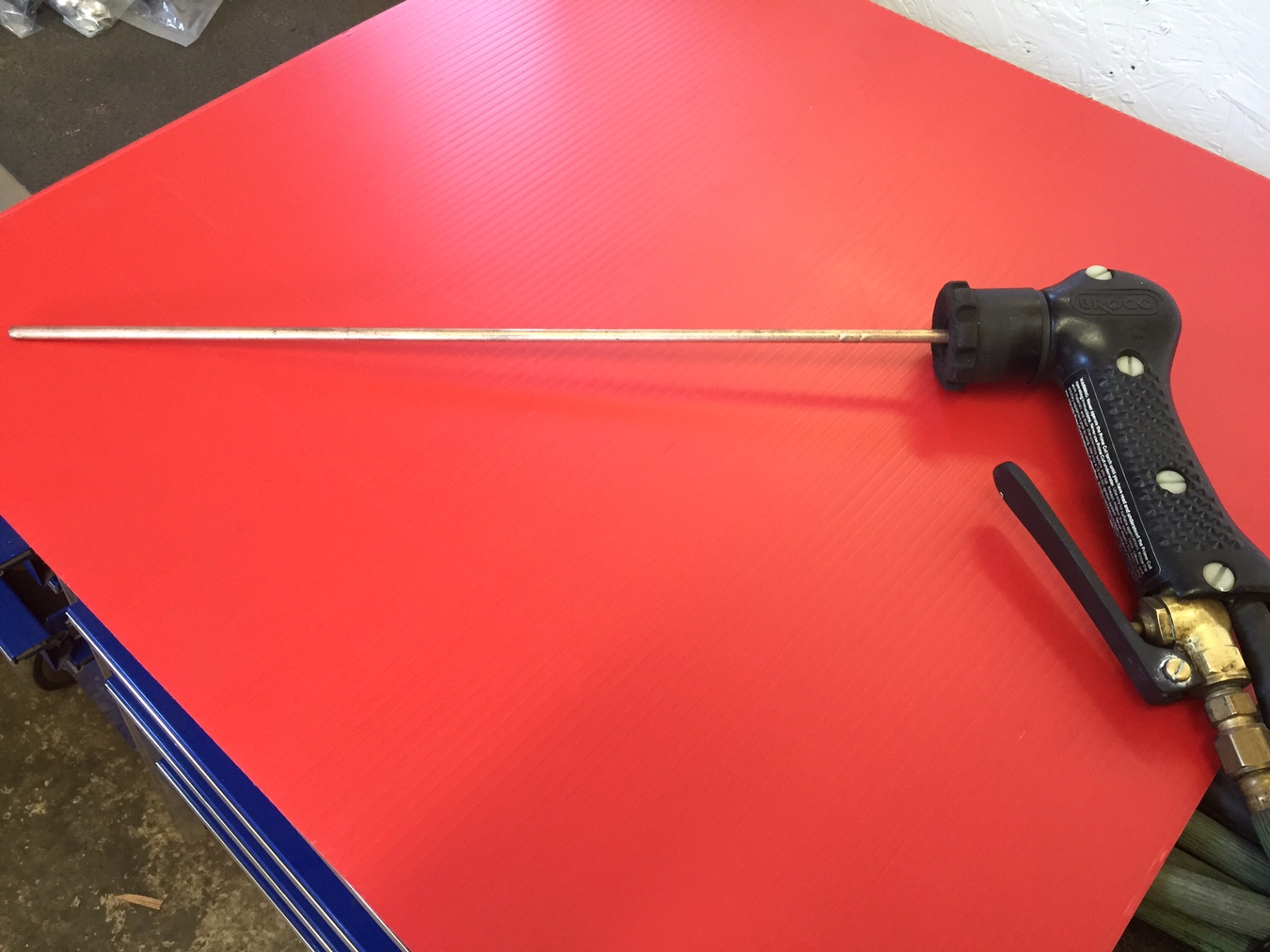

Another cool item I have is an exothermic lance which operates by feeding high pressure oxygen through a carbon steel cutting rod.
It has been featured in several movies involving cutting through bank vault doors. While it can be done, my opinion is that it would be highly impractical as the shower of sparks it creates would most likely incinerate the paper currency beyond recognition.
It’s also used for demo work as it will slice through steel beams and concrete. Not positive but I think it can also be used for underwater demo and salvage.
Torch
Closeup of rods.
Precision cutting of seized excavator pins (this one NOT my photo. Google image)

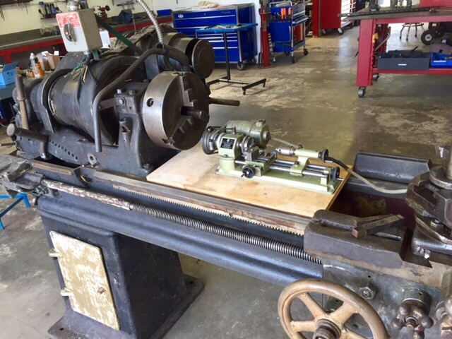

I’ve had lathes come and go over the years.

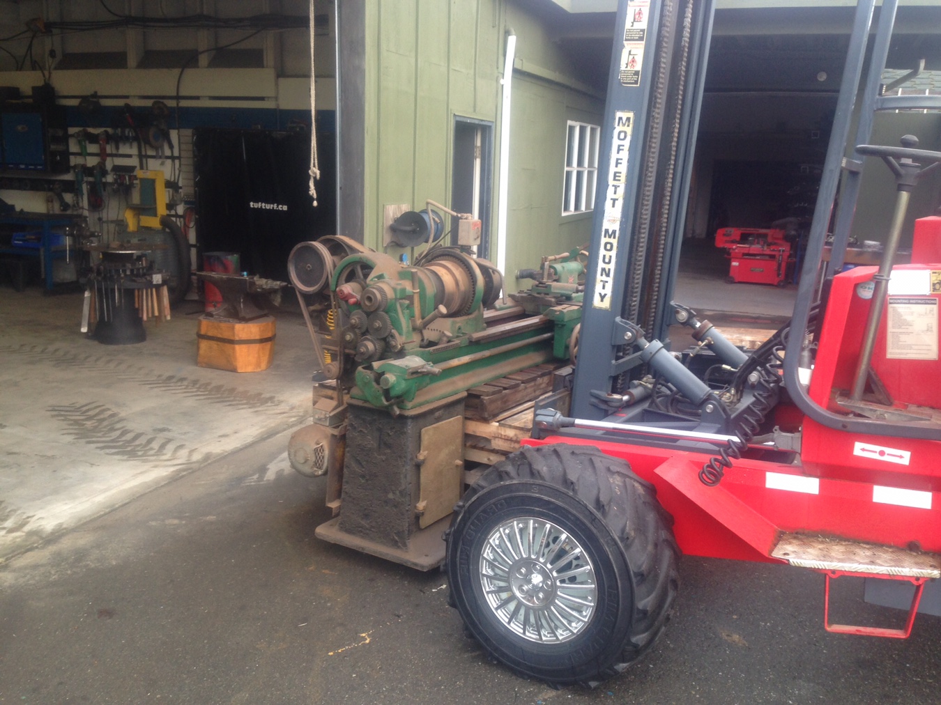

This Canadian Made one a friend dropped off as a gift. It was just too big and sat around for awhile until I cleaned it up, got it running and gave it back to him

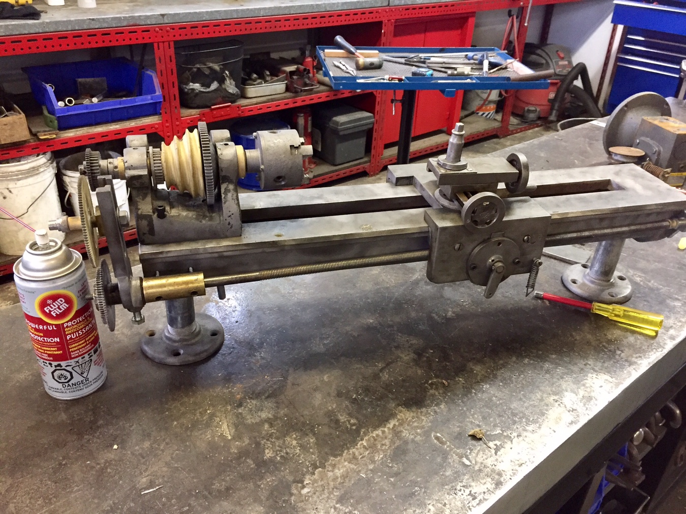

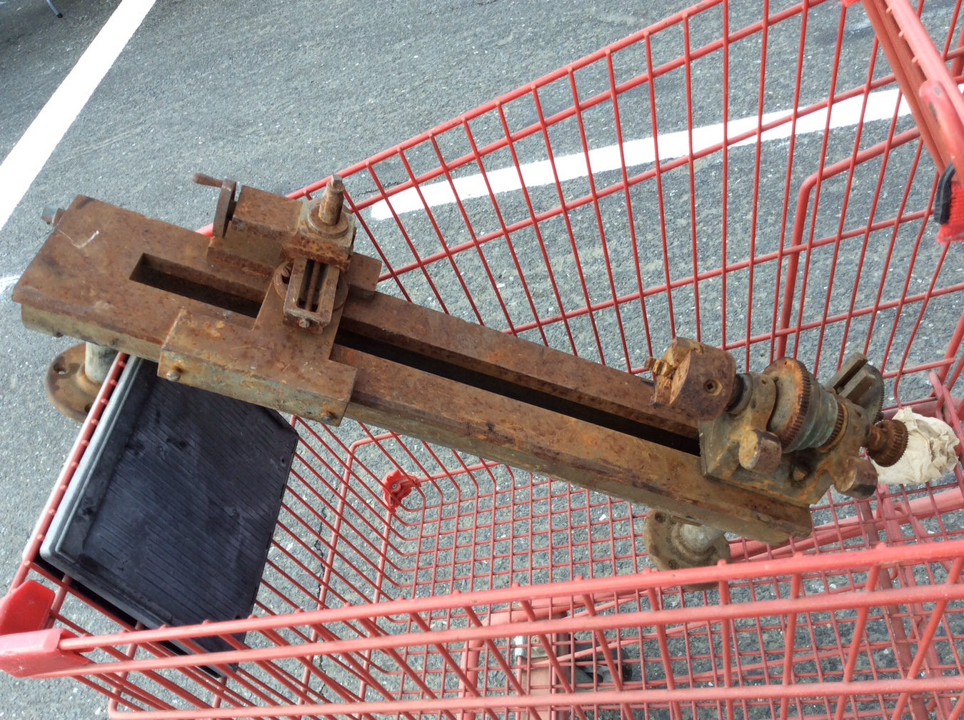

This one another friend grabbed at a garage sale for $7.
It looked a little better cleaned up

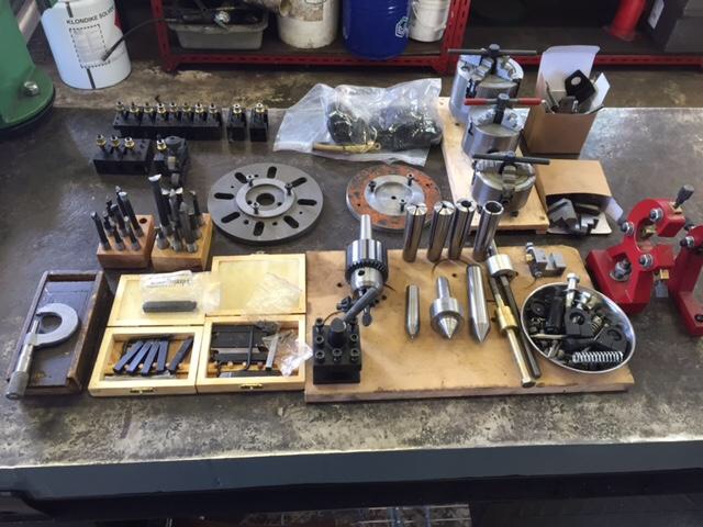

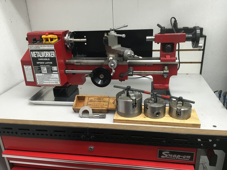

This import mini was on Craigslist cheap and I couldn’t resist. I cleaned it up and resold.
Lots of tooling too.

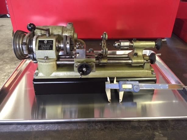

These little Unimats come up for sale quite often. I’ll buy them if cheap enough. They’re easy to clean up for resale. I think I’ve bought and sold four now.

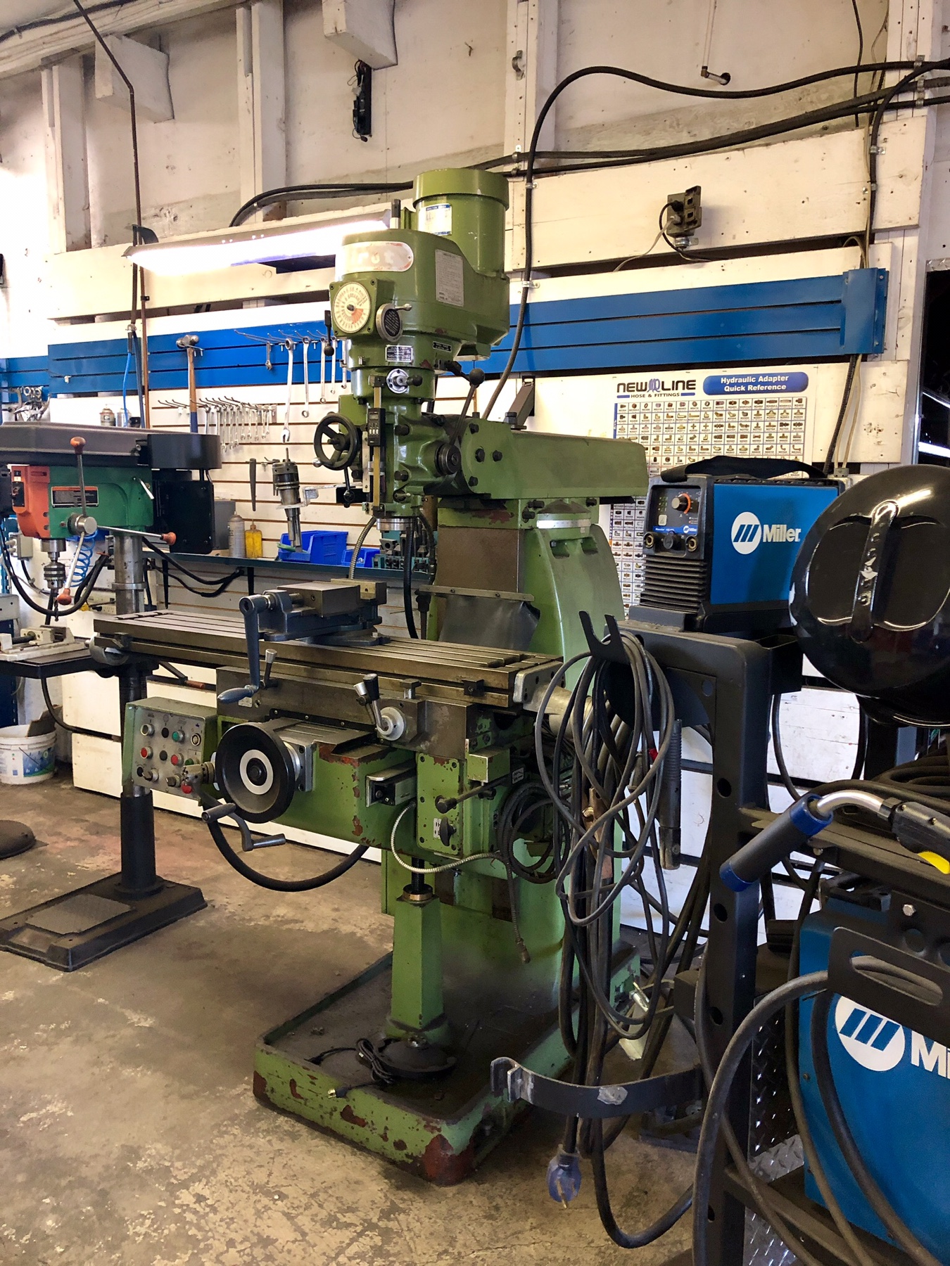

This Bridgeport clone I picked up from a local machine shop. (Cheap. Notice a pattern here? ). :)

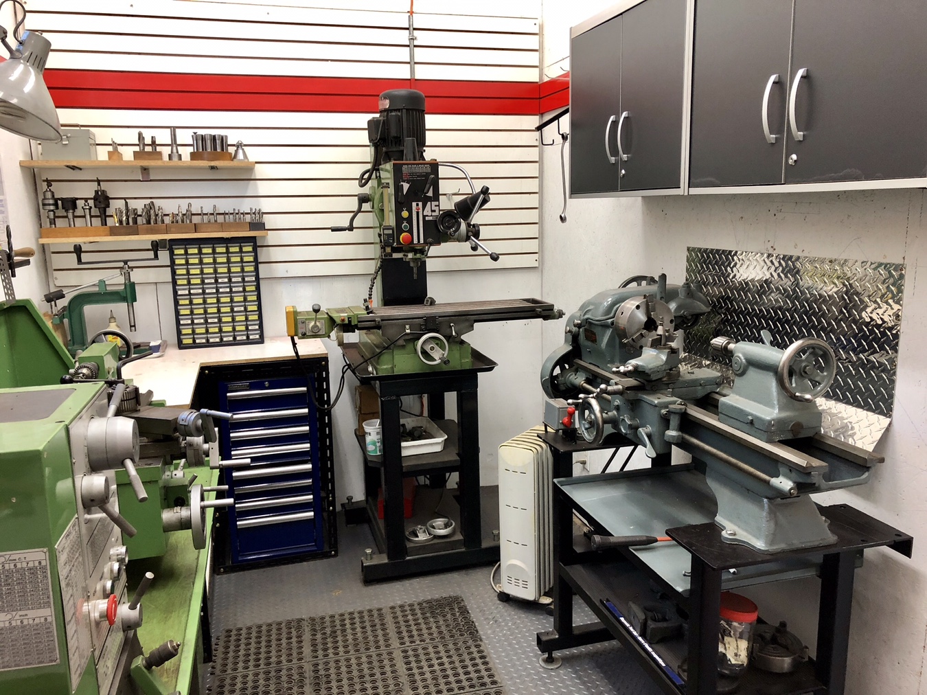

My mini machine shop. It took me several years before I was finally able to house these machines in an enclosed heated area.
