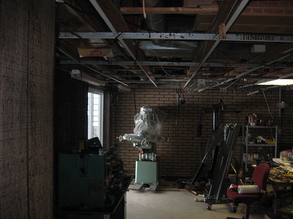

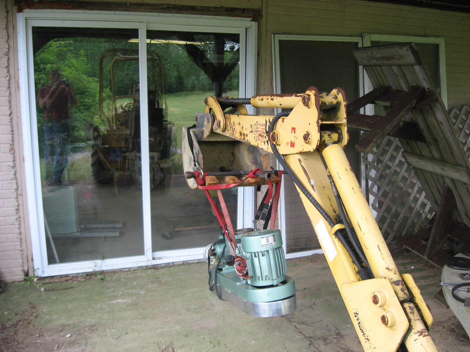

I have a walkout downstairs and use the Terramite's stinger to fit machines through the sliding door. I suggest you tote the mill by removing the head at the column riser, splitting the weight nearly in half and where there's no tech to r & r the bits. (4 bolts) I doubt if either piece weighs nearly what it looks like, or half a thou'. You don't want it to travel upright and in one piece, anyway. I don't ever have the luxury of a helper when moving machines or safes, but always manage.
Use a few extra ratchet straps, an appliance dolly, and two college hunks if you have to go up stairs with the halves. I do use a 1-T HFT shop crane indoors vs tractors out, and I might have set the head back on by hoisting from the ceiling and rolling the base under it. (Big 'dowels' are still under it and it pulls out nicely to sweep/vac chips.) This pic is from when setting the 12" x 36" lathe (2010?). Lionel (TM) has since cost me ~1/3 of the room, so the small mill is tuck in by the near end of the lathe. Table at right is behind the G-9972Z, which never sat to a wall and does most turning work despite being 'plastic-rated' (my words).

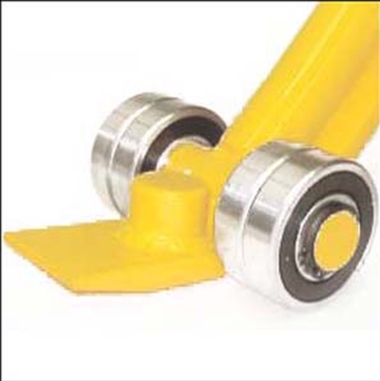

I’ve always meant to make one of these. A roller bearing pinch bar.
They would be great for repositioning and moving machines short distances. Or even prying up an end to get small diameter pipe rollers under the machine.

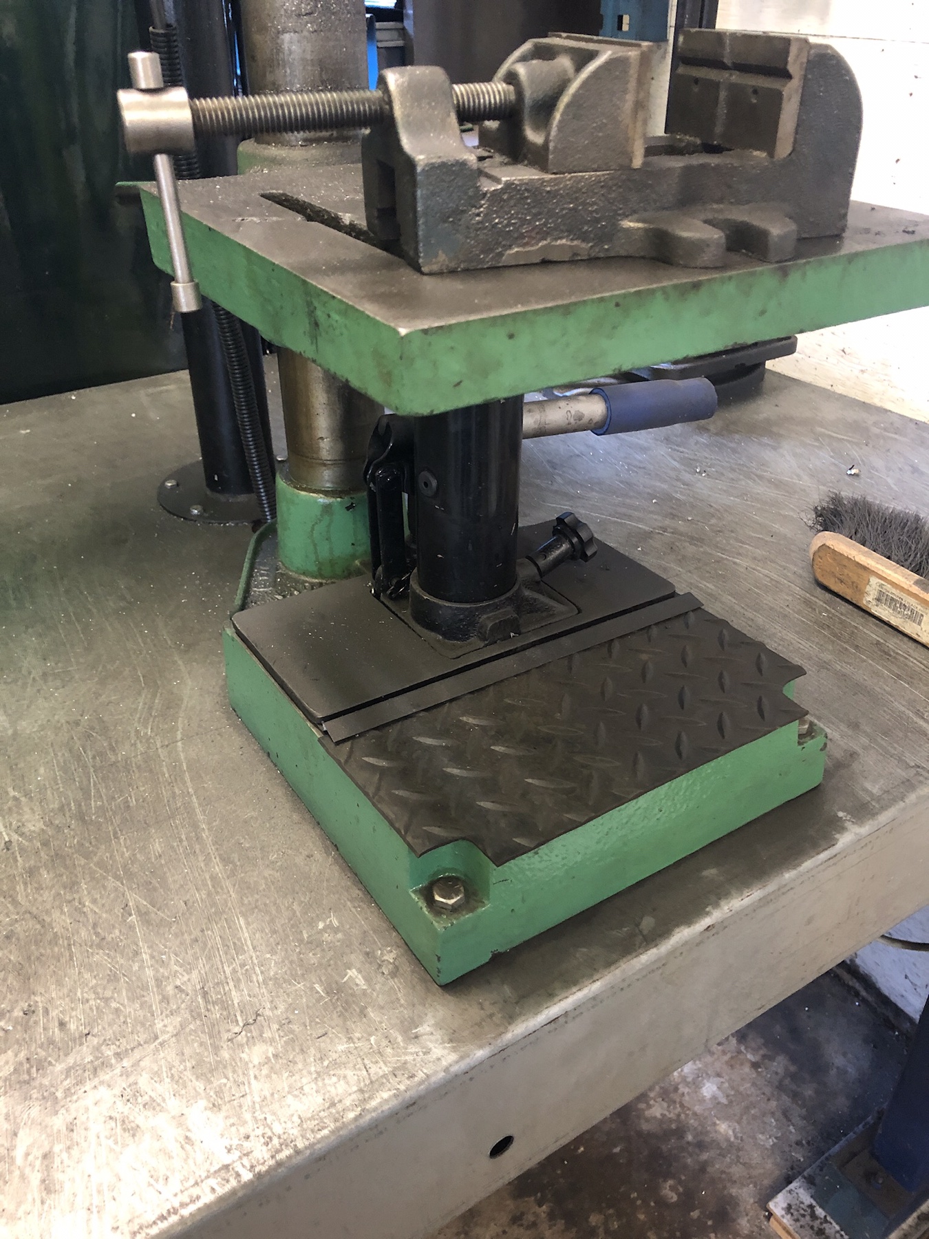

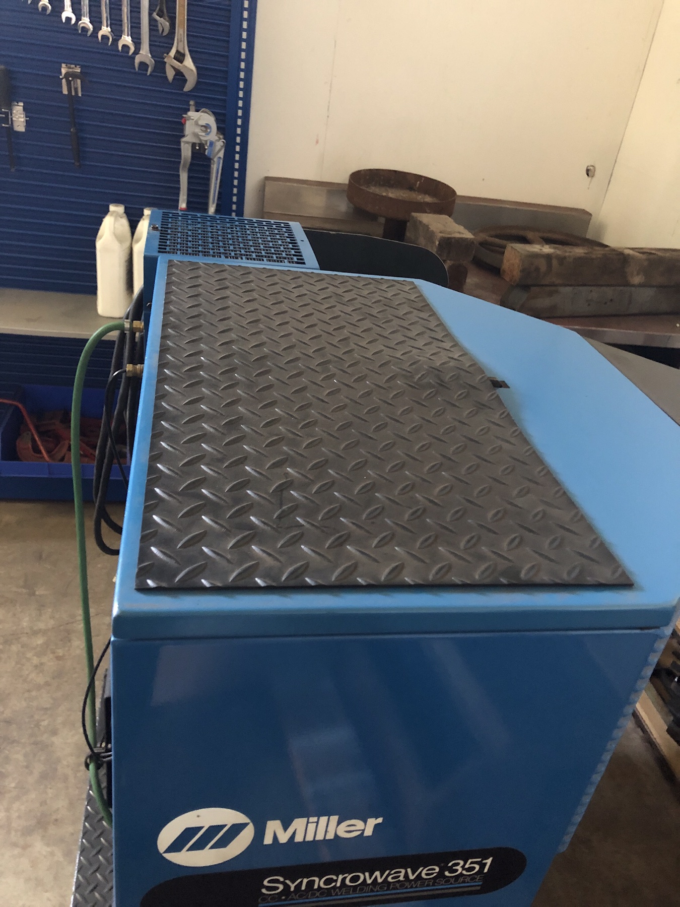

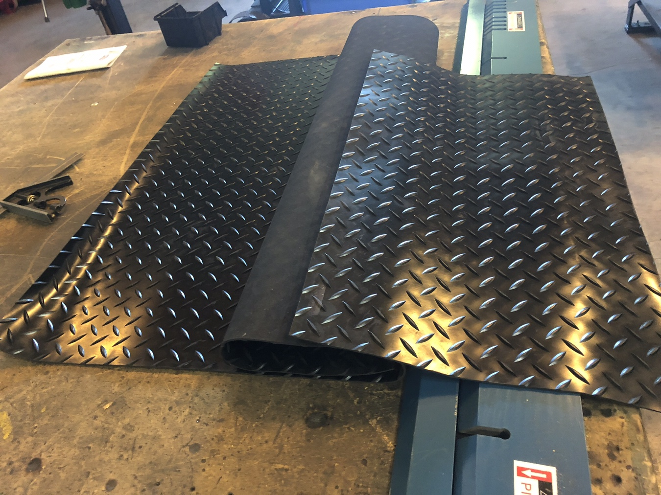

It’s the Little Things
Part 2 The Big Coverup.
I buy this rubber checker plate matting at Princess Auto when on sale. It is sold by the foot. 1/8” thick x 40 inch wide. I’m sure it is available at Harbor Freight stores or similar.
I’ve used it on the top surfaces of welders I’ve resold to hide the dents and scratches from former owners.
I now glue them on my own welders as it provides an attractive non slip work surface.
Also they cover the holes on the bases of my drill presses to prevent chips from accumulating in them.
   / Big Barn’s Retirement Farm Shop #159
Okay, you got me!!!! Buying some of that and applying to the base of my drill press!!!! :cool:
