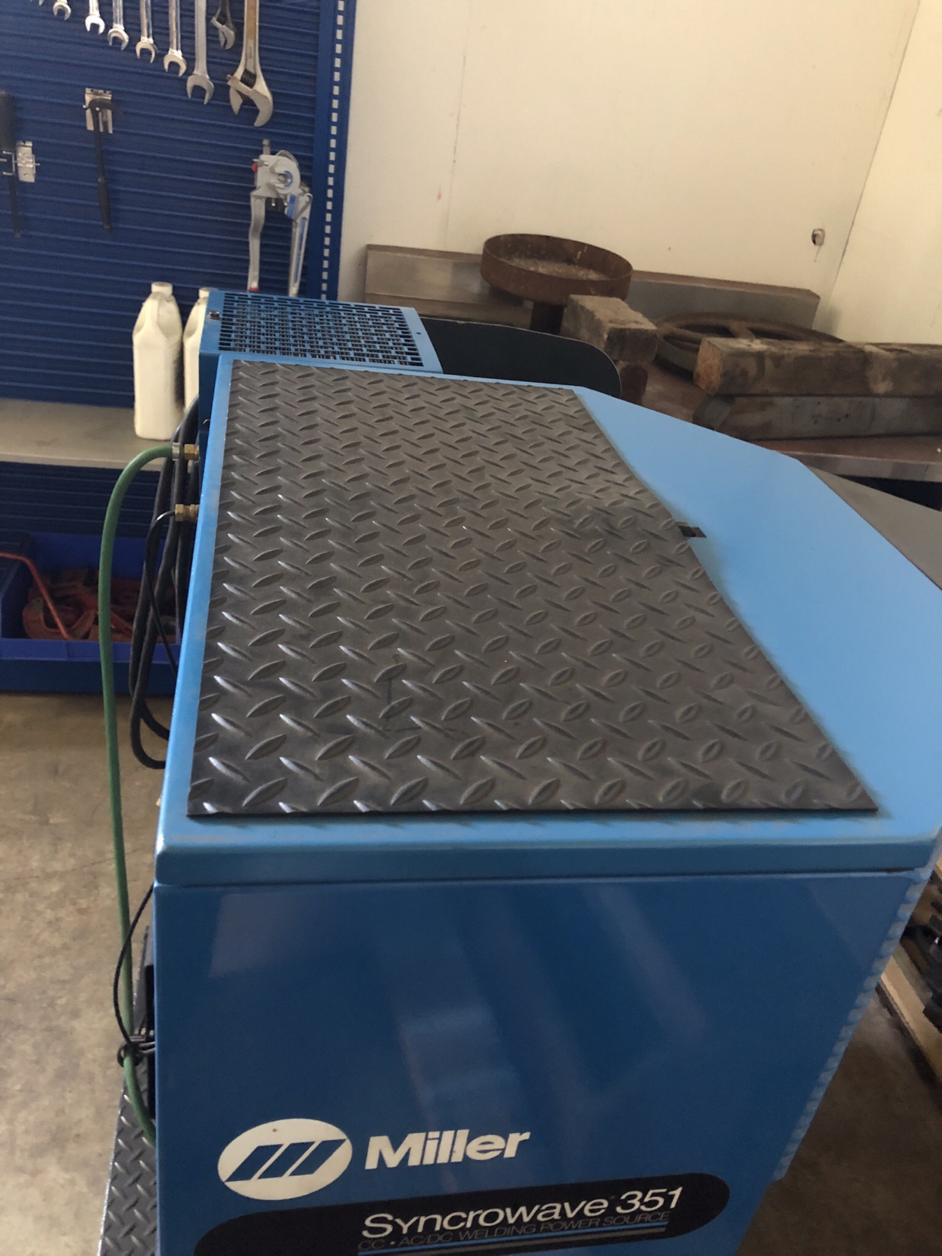

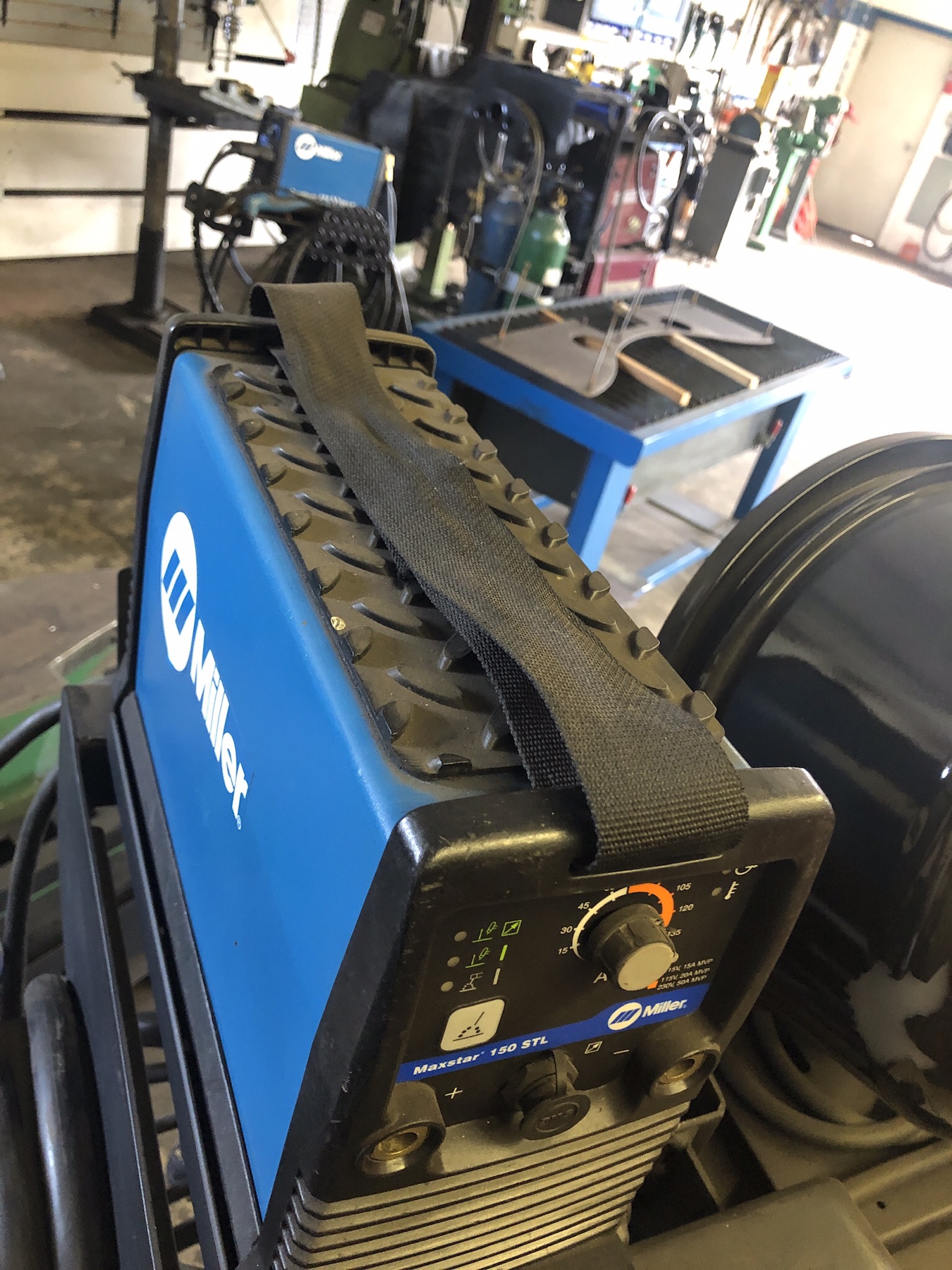

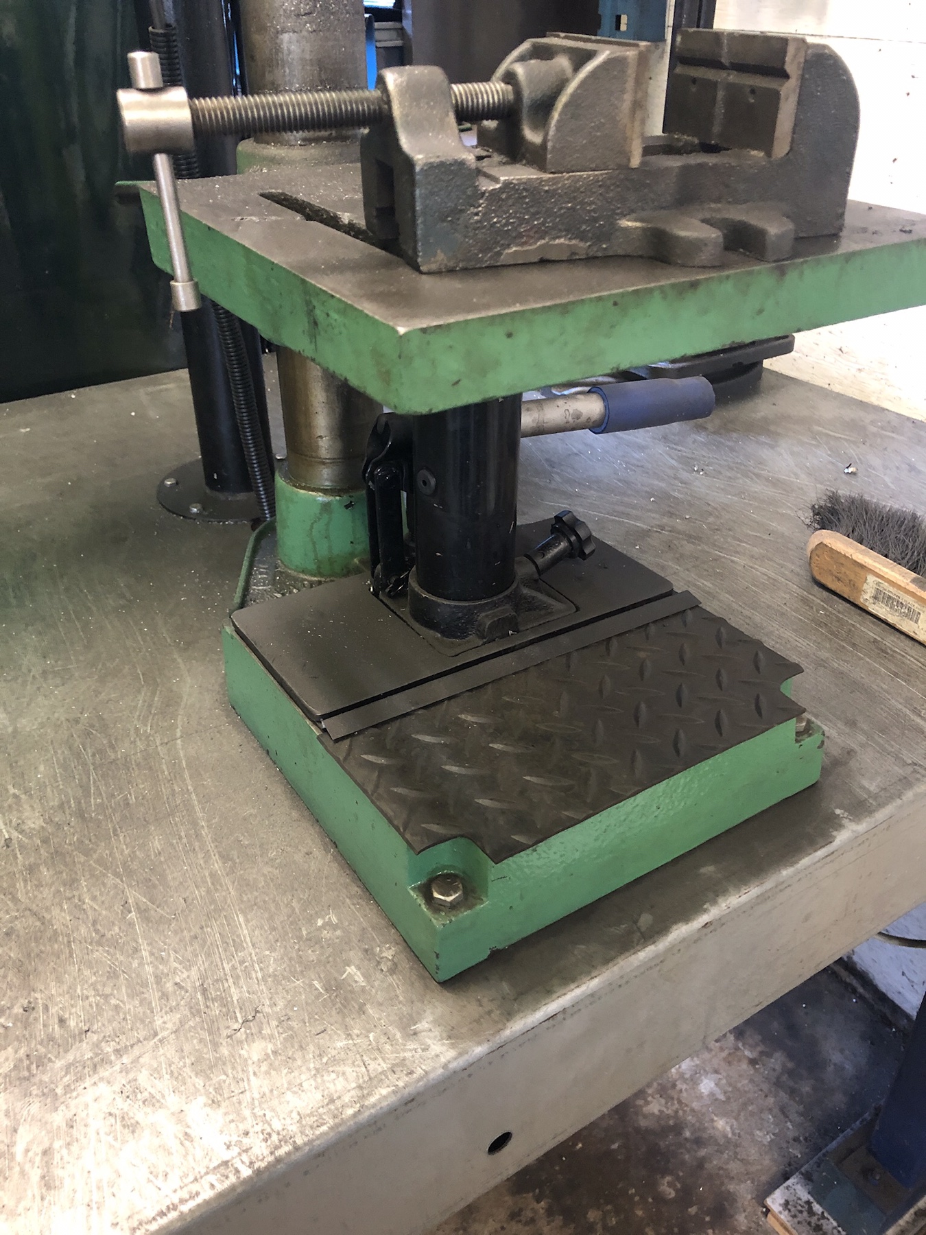

I buy this rubber checker plate matting at Princess Auto when on sale. It is sold by the foot. 1/8 thick x 40 inch wide. I�・ sure it is available at Harbor Freight stores or similar.
I閾エe used it on the top surfaces of welders I閾エe resold to hide the dents and scratches from former owners.
I now glue them on my own welders as it provides an attractive non slip work surface.

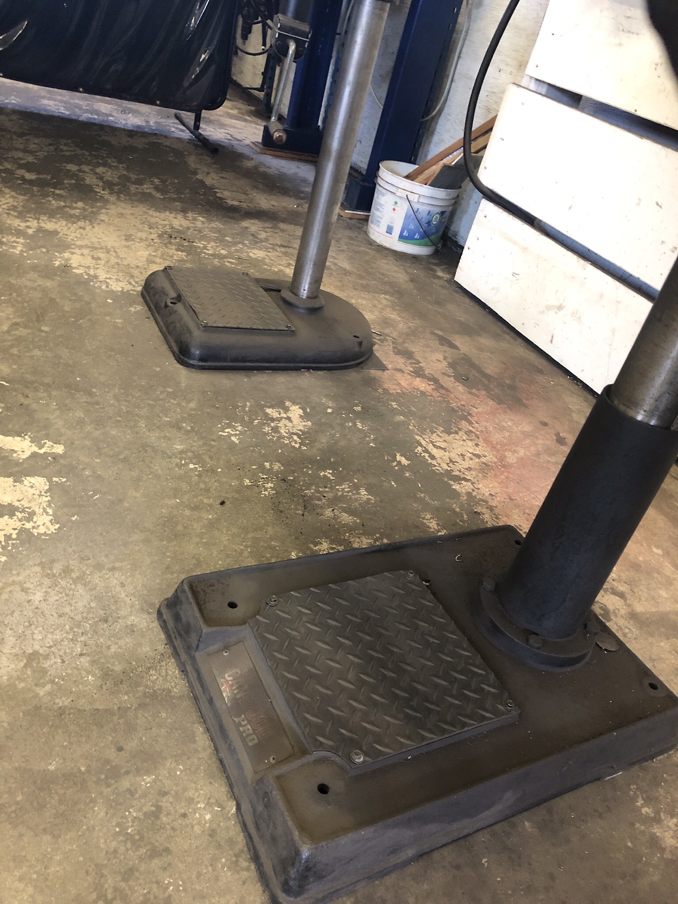

Also they cover the holes on the bases of my drill presses to prevent chips from accumulating in them.
Brilliant ideas... I could use that stuff on my drill press and a few other areas for sure! No Princess Auto here but will check HF or O'Rielly's. Either that or I grab a chunk from you in trade for some CB stuff when I visit... targeting June!

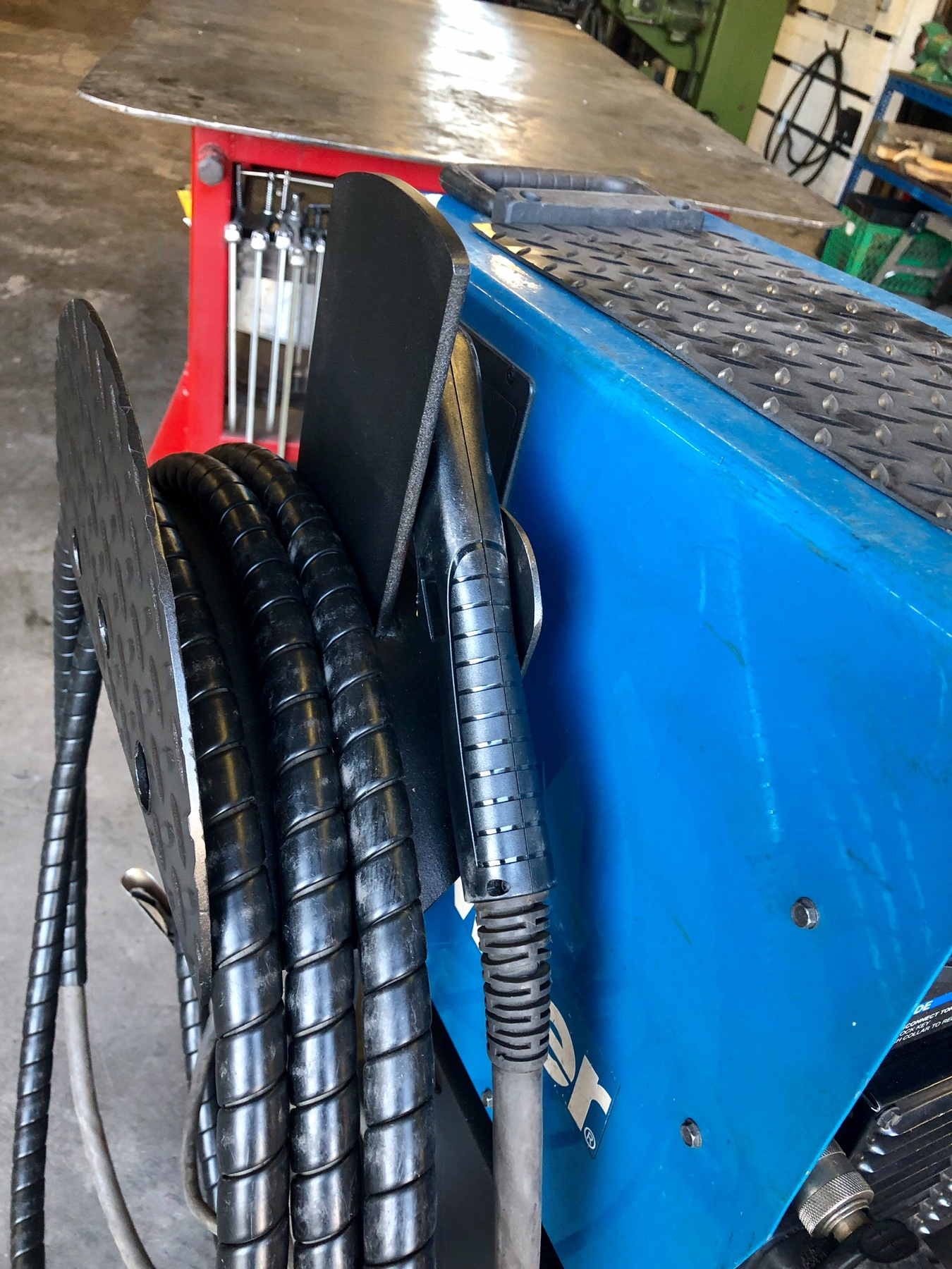

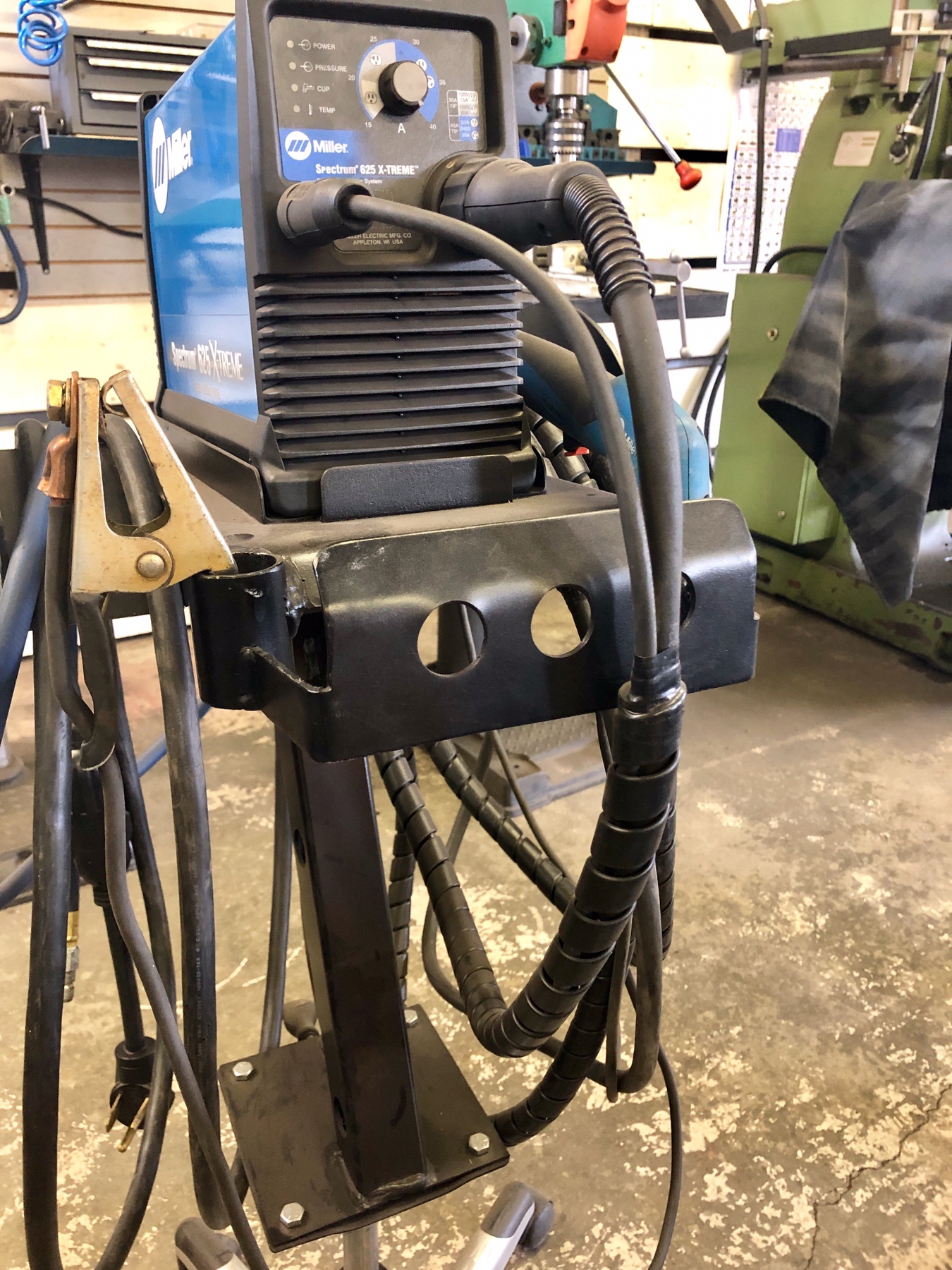

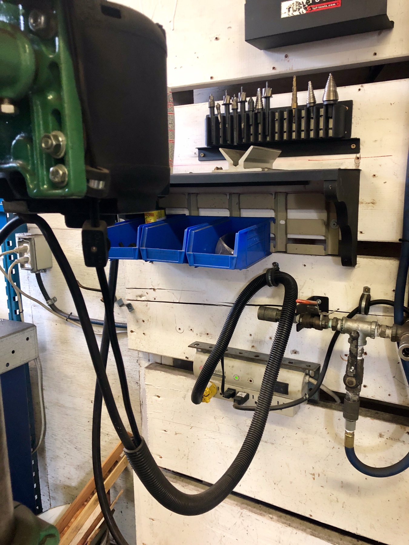

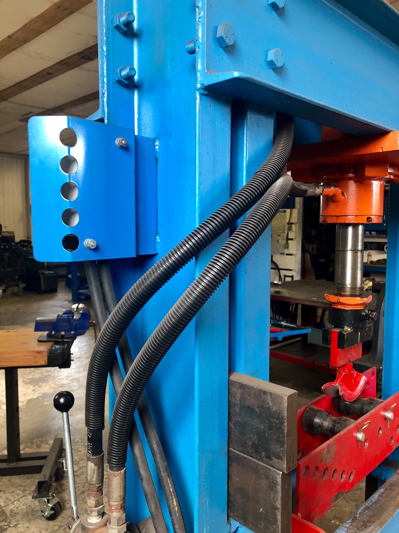

Another thing I like to use in the shop is relatively cheap plastic spiral wrap for hose and cables.
It’s a nice easy way to tidy up otherwise unruly multiple wires and cables.
Cheap plastic wrap available at electronic stores:
Heavier spiral wrap for hydraulic hose. Shown here on plasma cutter torch cables.
Those were a few examples. I’m certain most of you can find a lot more creative ideas.
   / Big Barn’s Retirement Farm Shop #163
I really like that spiral wrap. Nice protection when dragging across the floor or scraping against something.

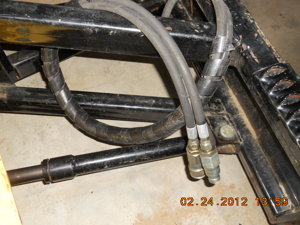

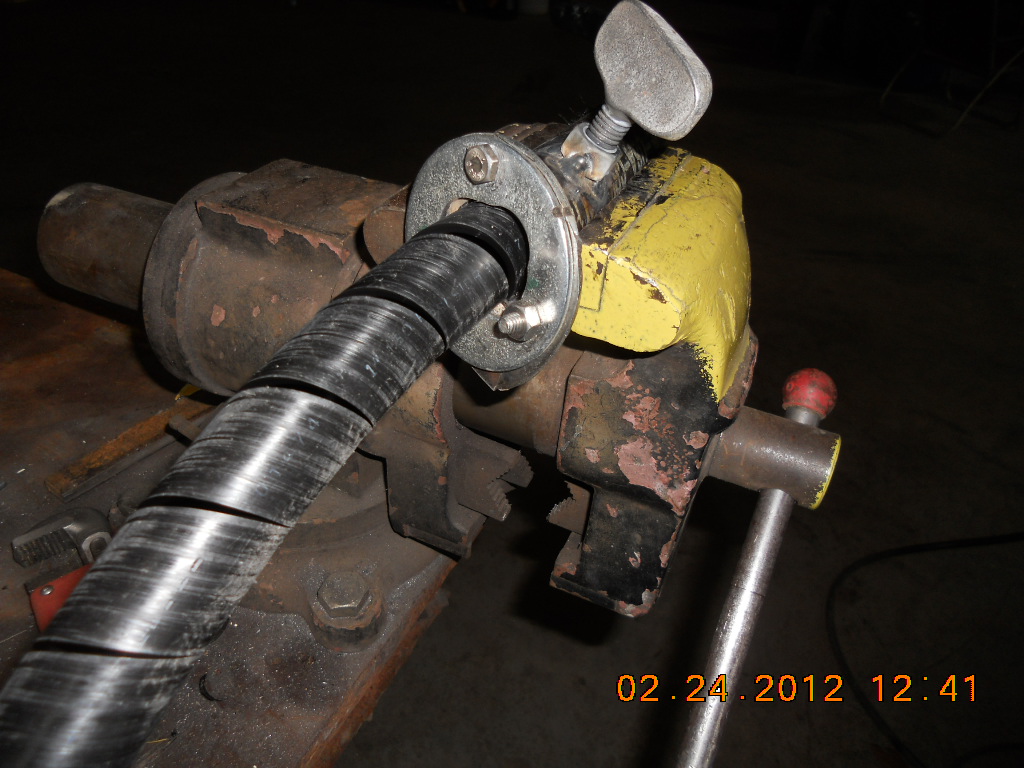

I made a cutter to make that heavy vinyl wrap for hoses and such. They get a premium at the hose shops for that stuff.
I just use well pipe or whatever plastic pipe I have on hand. It will cut different diameters.
   / Big Barn’s Retirement Farm Shop #169
Can you post some more pictures of your cutting tool? I could use something like that...
Aaron Z
#170
Rustyiron I think I recall seeing your pipe slitter previously. I’m glad you posted. Feel free to add info on its construction and operation. Too cool! Thank you!
